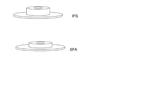

I don't think the IFS rotors will fit on SFA trucks or land cruisers.
The IFS rotor has longer hat. That is if the calipers will even bolt up.

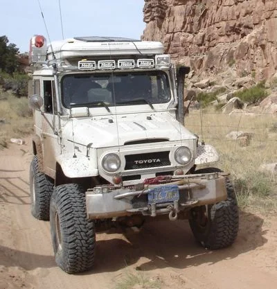

My truck weights 7000 lbs and needs bigger brakes do to fading on big down hills.
a 7000LB FJ40? Sure you don't mean kg? I gotta see a picture of this.

A spacer will allow you to bolt the older cruiser rotors to the IFS hubs, but not the other way around. As I said before the IFS rotors have longer hats. Other words the distance between the braking disc and the mounting surface is longer.

7000lb FJ40
How it adds up 37 gals of fuel, 18 gals of water, 2 deep cycle 6volt golf cart bats, 1 optima, 383V8, NV4500, Orion, Fj60 FF, 12000lb winch, ARB fridge, roof top tent, and too many radios.
still not sure how you come up with 7000LB. Have you had it weighed?
Per Curb weight - Wikipedia, the free encyclopedia 'curb weight' is defined as "the total weight of a vehicle with standard equipment, all necessary operating consumables (e.g. motor oil and coolant), a full tank of fuel, while not loaded with either passengers or cargo."
curb weight: 3263LB per FJ40 Specs
gas: 37-18.5 gal (stock capacity)=18.5 gal X 6LB/gal=110LB
water: 18gal X 8.3 LB/gal= 150 LB
2 batteries: ~100LB
engine: -200LB from stock 2F
battery, drivetrain: negligible difference, if any
winch: ~200LB
So, you have 3623 LB plus the fridge, tent and radios. No way they add up to 3377 LB. If the mid 90's 4Runner caliper with (4) 40mm pistons won't stop your ~4000LB truck you got other problems like a bad booster, mastercylinder, seized caliper pistons/wheel cylinders, pad contamination, etc
