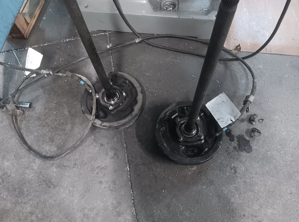

Starting at the local salvage yard:
Tacoma's are also a semi-floating axle, but instead of C-Clips at the diff, they have pressed on collars at the bearing flange.
The thing I liked about this is that it's only 4 bolts for the parts guy to take out and then the whole axle assembly slides off. So it was easy to get all of the brake parts for the price of an axle shaft.
Saying "Oh by the way I need the parking brake cable intact" probably cost me about two weeks before they found someone willing to do the job, but everything here was $295.
The downside of that design is needing to come up with a fixture to press the shafts out of those housings and free up the brake plate. It would have been a lot easier to go to the Toyota shop and just have them do the first 1/4 of a wheel bearing job.

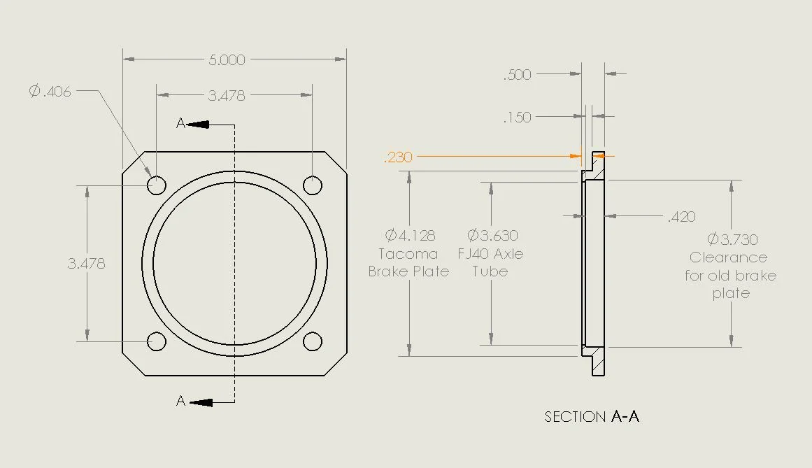

Before pressing them apart I measured the distance from the wheel mount surface to the edge of the brake plate and came up with 2.35"
Mocking the Tacoma brake plate on the FJ40 axle showed that it would need to be moved about 0.100" inboard.
I pulled the dust cover off and measured the original distance before going too crazy.

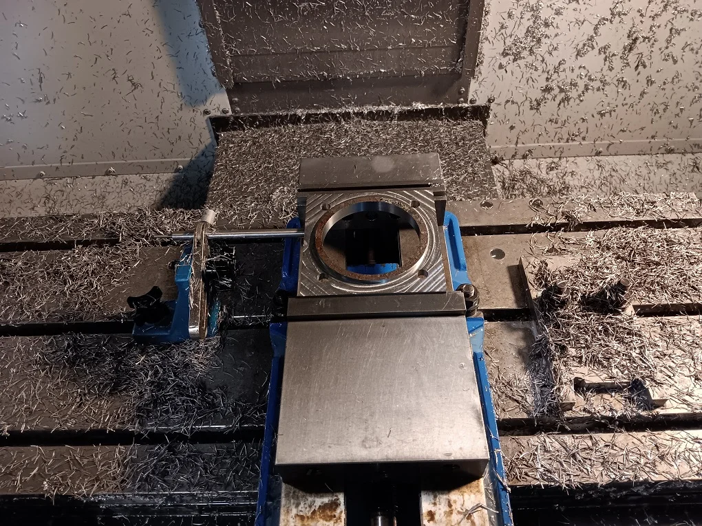

Made the plate with 0.150" movement inboard to have some room to work with if it wasn't perfect

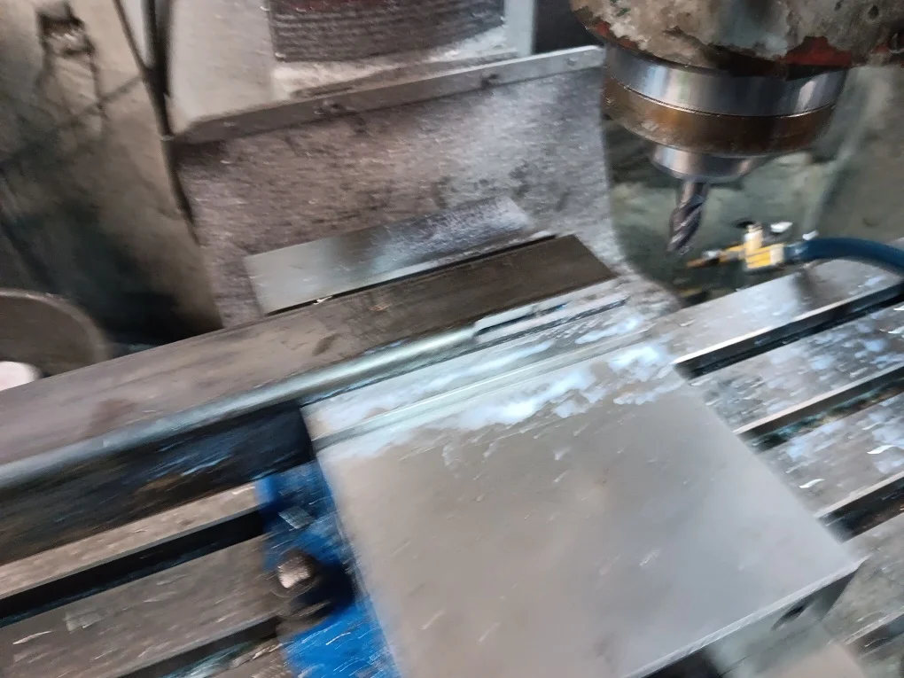

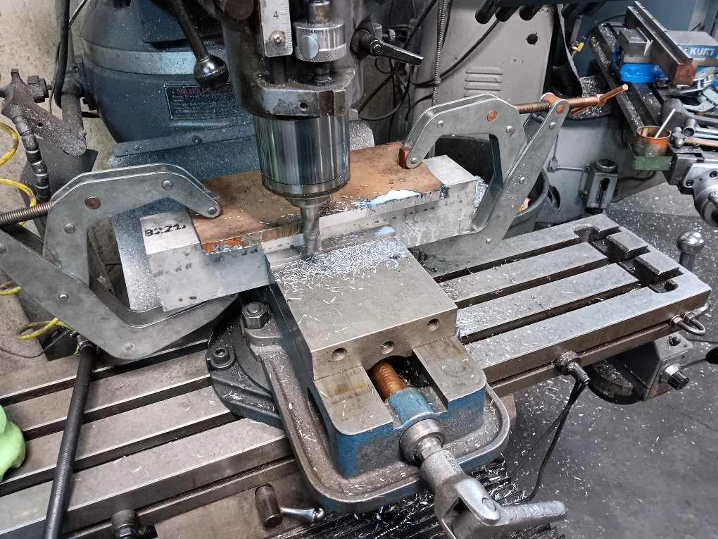

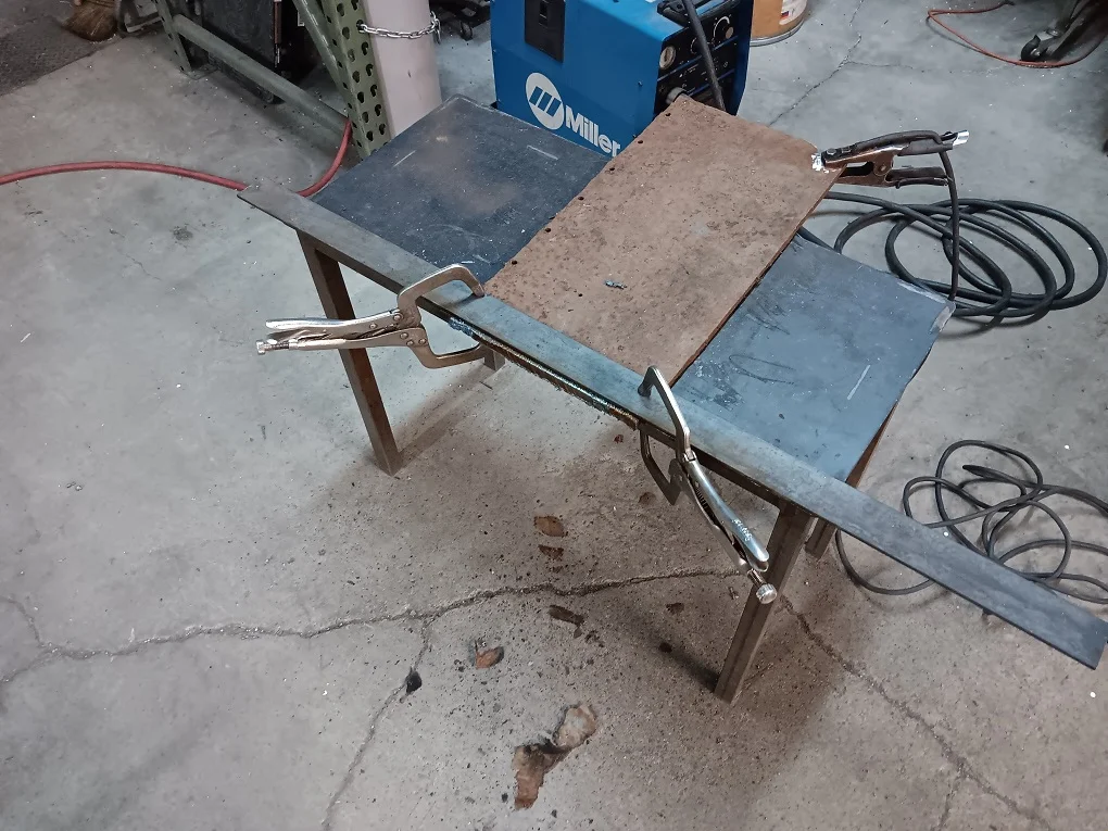

Should have just gone and bought some 5"x1/2" bar stock, this was silly:
But it got done

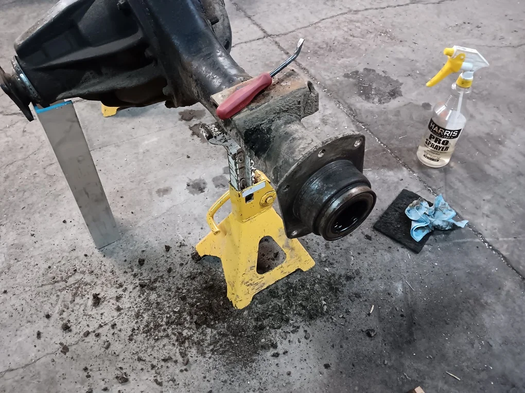

That was a lot of grinding. If I do this again, it will be worth it to make up a fixture to put the whole axle on the mill and mill the old flange off.

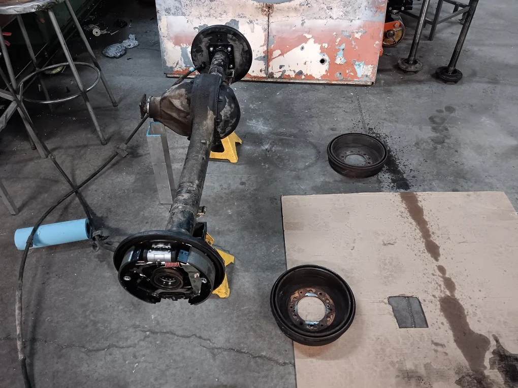

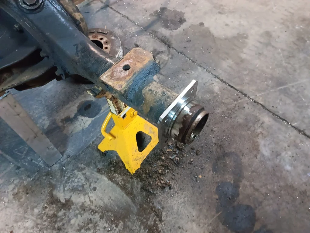

I was originally thinking I would make a fixture to maintain the new flange's distance from the end of the axle tube, but thought of something better and easier
Hammer the new flange all 0.150" to the end
Bolt the new brake plate on
Reinstall the axle shaft with the brake drum
And knock the flange back out until the position was what I wanted and consistent all the way around.

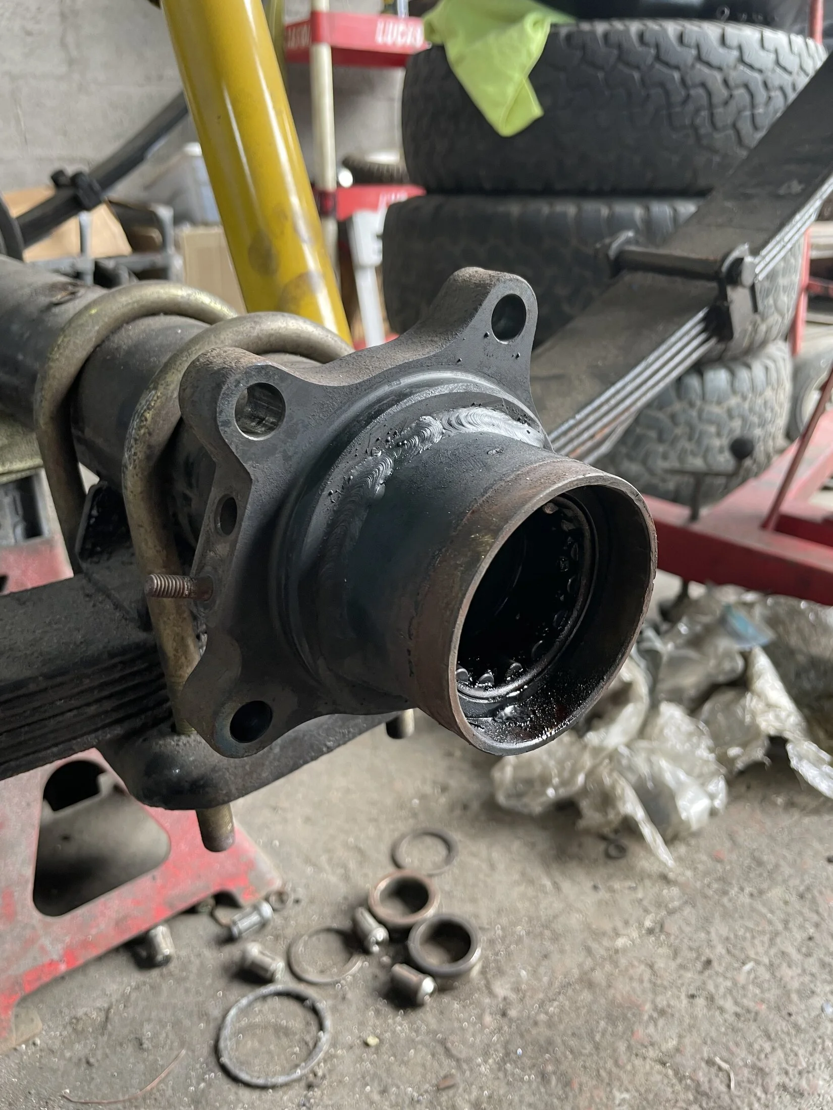

Four tack welds, measure everything again, take it all off, and blast the weld in complete.
While the area was hot from welding, it was really easy to knock the wheel bearings out.

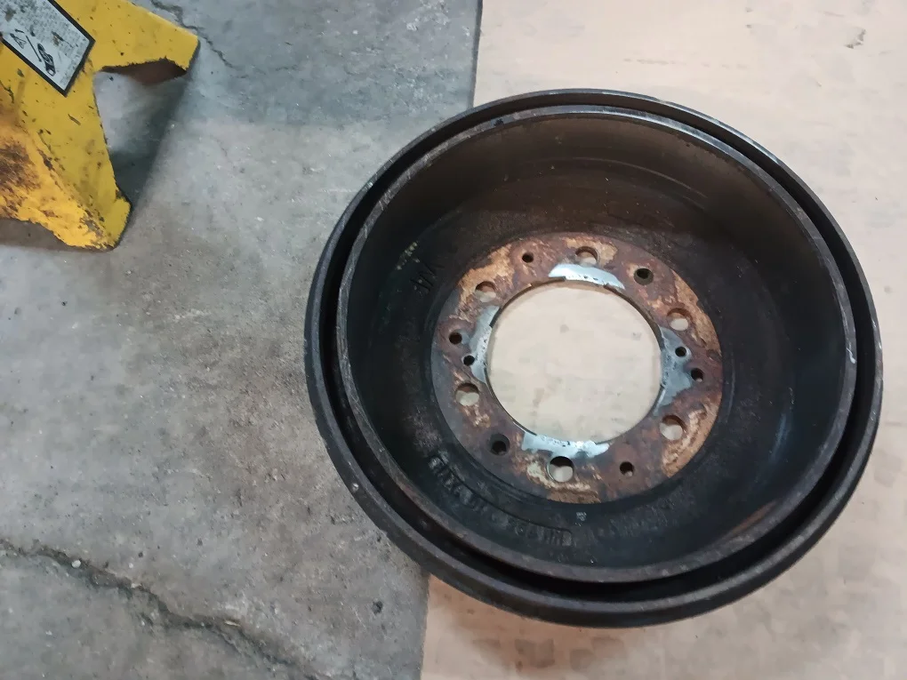

Problem: the pilot diameter on the FJ40 brake drum (and therefore the axle) is 4.18". On the Tacoma it's 4.25.
This would have been a lot easier if it was the other way around.
I had considered doing this weld and cut down operation on the axle shaft, but don't have a lathe big enough to turn it down. I talked to a friend with a bigger lathe and could have done it, but at the last minute changed my mind to "modify the cheapest part"

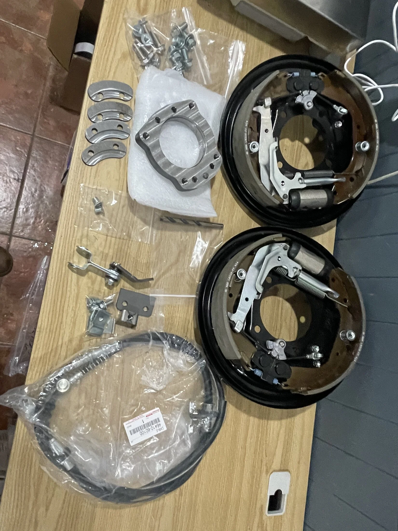

Well, my adapters are for the +8/80 brakes, which are basically the same as the Tacoma brakes you are using but without the issues of the drum pilot or backing plate offset.

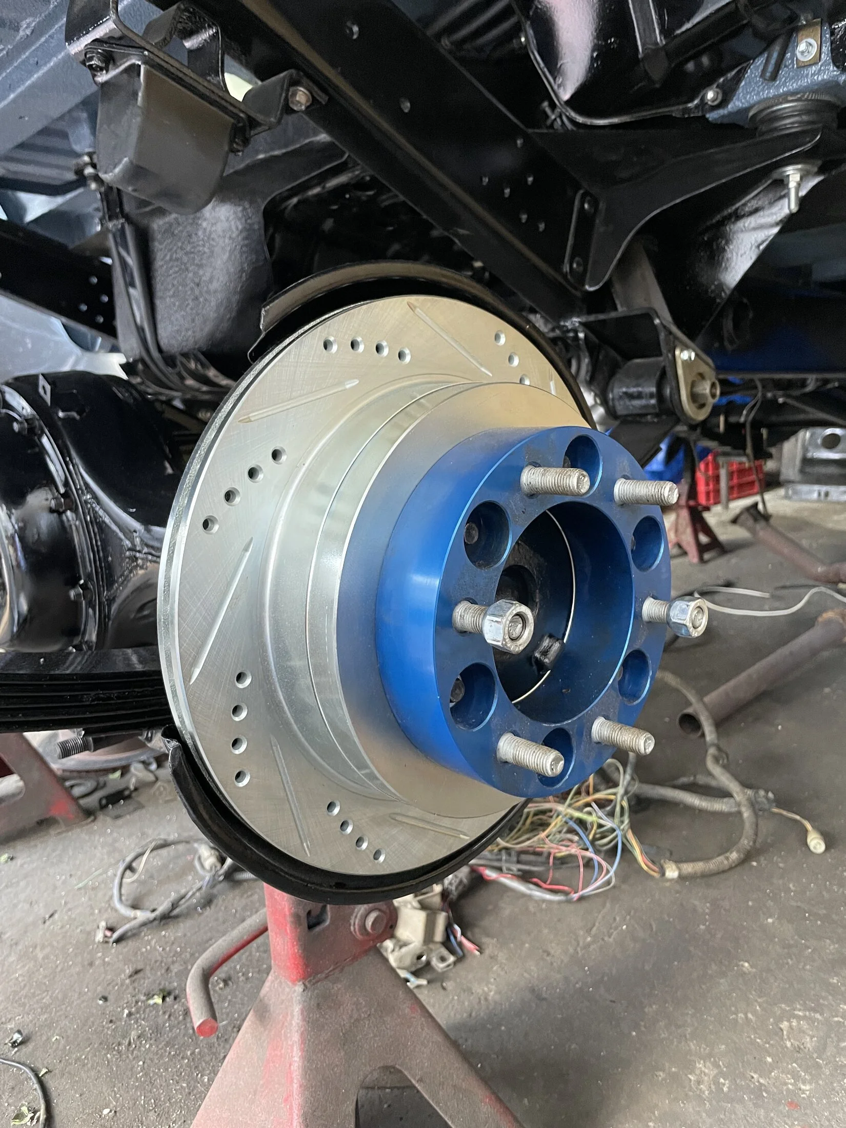

I did the same using parts from a 2003 4Runner with disc brakes, welding the OEM hub to my axle. Everything turned out pretty well.
View attachment 3877240View attachment 3877241
Looking at the lengths he was going too, I’m surprised he wasn’t adding disc brakes. If you are ever crossing through water you will understand. I have gone through deep water with drum brakes… only to find I had no brakes when I was going down the next descent. It’ll get your blood pumping.

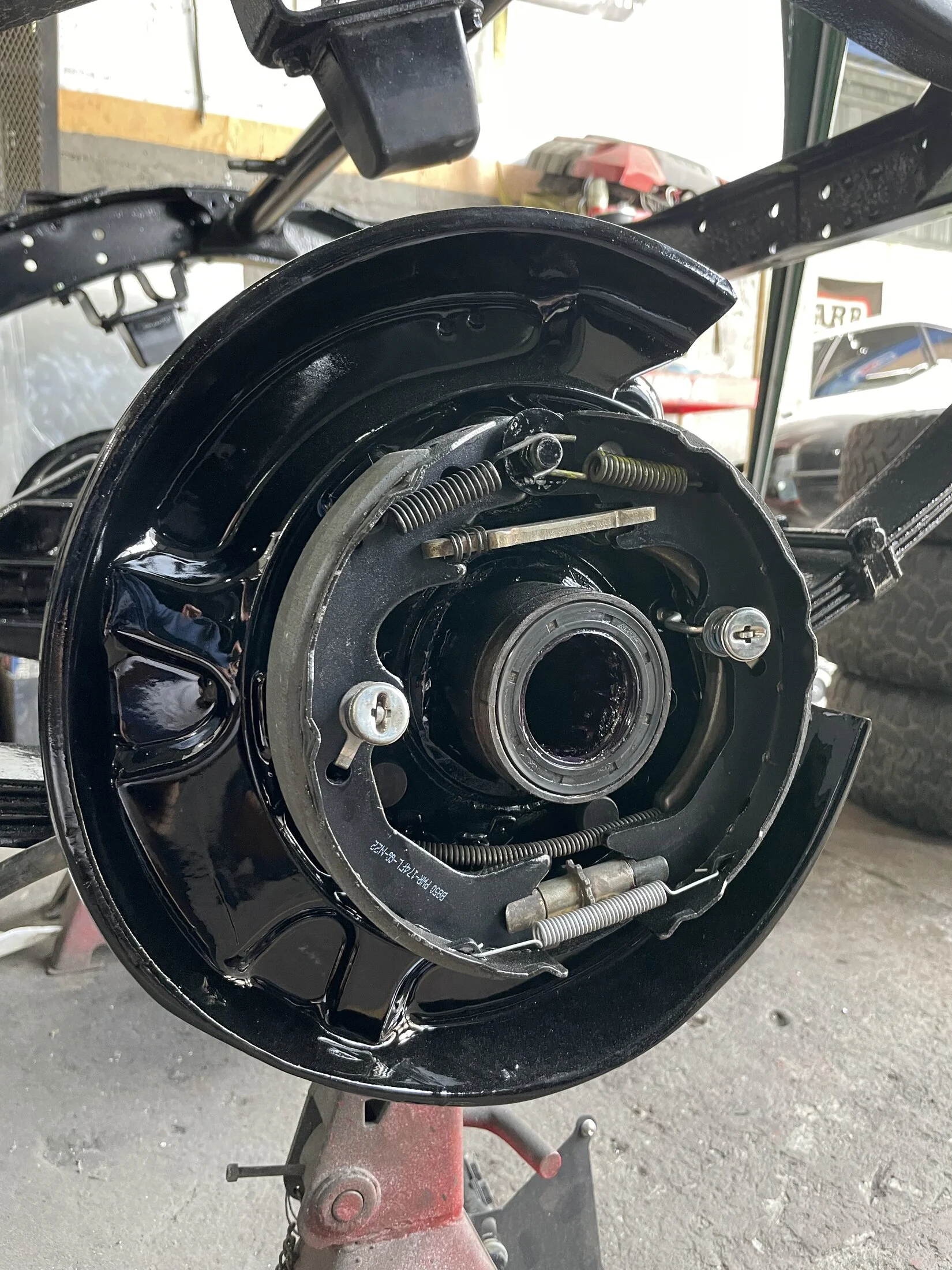

Finding something with disk brakes occurred to me after buying the Tacoma parts, and by then I was already down this path and sticking with it.

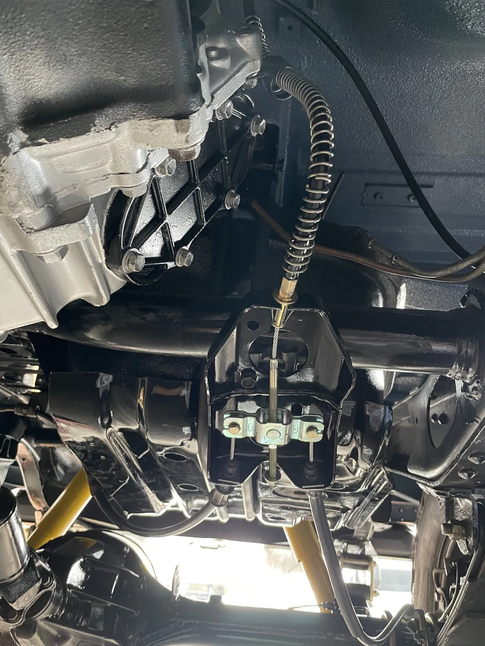

The cables reach all the way into the cab and I got a splitter made after a few days of measure 3 times, think once, measure again and then cut.
