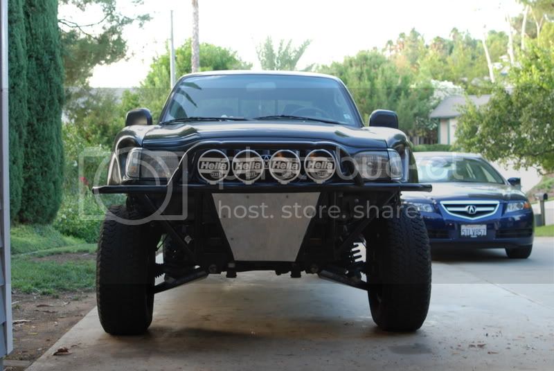

Do you want your bumper to look like this?
I have heard a lot of mixed opinion's on it but I guess we will never know. I do not have the $700 to buy a bender and die's so that I could even bend some simple sliders, but I can get a $100 HF bender. I can not see how if you take your time and read how other people have modified theirs to work that this will not work. Maybe it will not work like those more expensive ones and I would hope not. I am not a shop, I am just a guy who likes to drive over rocks on the weekend and will probably never own a truck I have to trailer so from what I have read it is all opion and not much real data.
If I had the money then I would absolutely buy one of the pro built benders but it would be a waste because after I built the sliders and bumper with this tool that I know own for $1000 plus what do I do with it?
I bought an HF kinker with the same hopes and aspirations you have right now. I thought I could make it work...Dont waste your money on a HF kinker. Your money would be better spent outsourcing it too a fab shop or buying a set from Marlin Crawler, Trail gear, etc and modifying them to work for your application.
