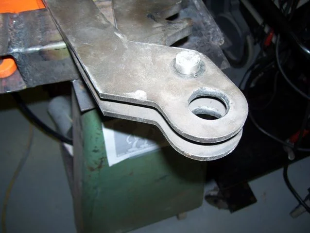

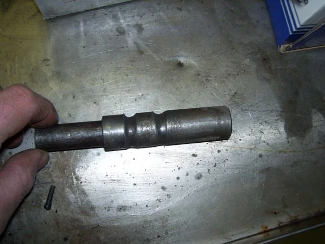

The pin that the comb arm attaches too was pretty worn, as was the hole in the arm. These take the brunt of the lever force and are both eliminated when I put in the ram.
I also broke a follower on the die doing a compound bend. They are aluminum.

Wow, thats some serious wear, must bend a pile of tube.
North West Fab uses there electric over hydrolic bender to bend DOM steering linkage and its taken a beating, even broke the part the pin goes through to hold the die. JD2 dies look really beat up.
Kyle has mentioned he will make his next set of dies on the cnc mill out of some tougher material.
You have to be careful when making the dies out of very hard materials. It makes it a lot easier to gall the tubing in the process.

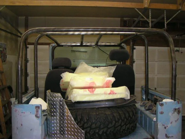

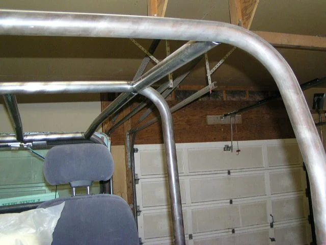

Here is a couple shots of some bends with my JD2. The independent piece of tube is 1 3/4 od by .120 wall HREW. The rollbar bends are 1 3/4 by .120 DOM. Both types of pipe bend flawlessly with this bender. I spent a couple months researching benders after looking at them for a couple of years. The JD2 had a great selection of dies and the followers have replaceable guides. The package I purchased came with the degree wheel, stand, 1 set of dies, and the cheater bar. The stand was about $100. I could have built my own stand for less in material cost, but not worth the time. And, I bent pipe the same day the bender came off the UPS truck. I went with the manual bender after nearly going with air/hydraulic or full hydraulic. When I counted how many bends I would probably do per year, it made no sense to spend the extra money. Good thing too because the cost of DOM tubing about killed me off. I found a deal for $6.50 a foot if I bought 100 feet. HREW was around $3.50 per foot. I have heard that prices are going down but haven't checked recently. I have been completely satisfied with the JD2. I sunk some 5/8 inch anchors in the middle of my garage to secure the base when I bend. Then store the bender in the corner the other 350 days of the year.
Close up of DOM bend
One more pic
One more pic

Nice job on the roll cage!
