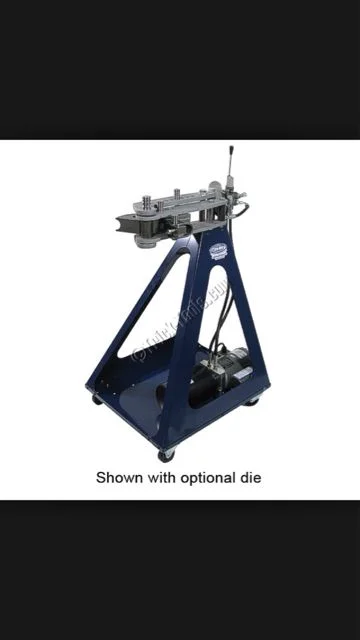

Anyone have any experience with this electric over hydraulic bender?
http://www.trick-tools.com/JMR-Model-TB-1000-Electric-Hydraulic-Tubing-Bender-TB-1000-7075
It's $2,000 and a hole lot more than I could afford by myself but when splitting would only be $300 over what I envisioned spending.
It will bend chromoly up to 2" which is what I have planned on using for tube for the main part of the cage.
Any and all criticism, ideas or suggestions are welcome.
I just don't want to spend the $700 and feel like I should have got a better one.
Here is a pic of the bender and a Video I found on you tube.
