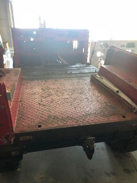

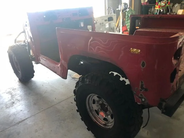

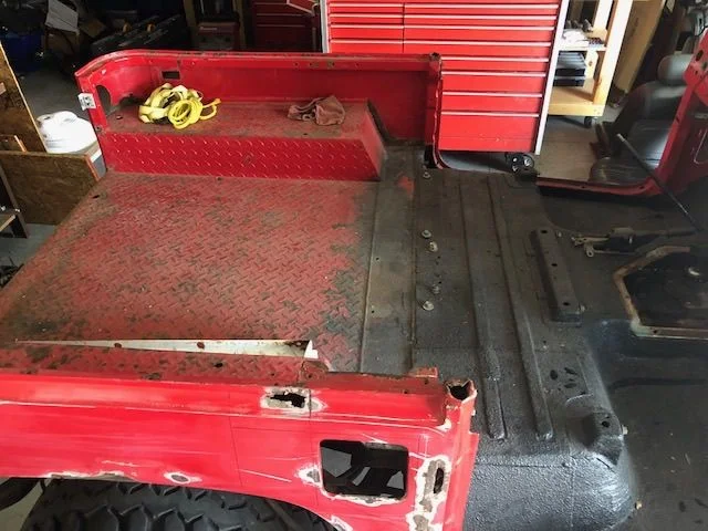

Here are a few pics of the 79 tub, as you can see the previous owner used steel diamond plate. He also extended the rear drive shaft about 3” and cut out the wheel wells. Other than the body the frame and drive train seem to be very good. Thanks, Mark
That’s salvageable if your top rails are in decent shape. You can get a full rear floor panel, quarter panels, rear sill, fender well tops and sides from a few different vendors.

Can't tell if the hump under the seats has patches on it? Also do not see any ribs in the front floorboards. Would not be buying anything until I knew the true condition of the whole tub.
Thanks for the comments on the 79 tub, floor boards are patched, humps under seats patched. It’s J. All the aftermarket tubs I have seen are not close to a factory apperence. I would like to find a clean original tub. Does anyone know what issues other than the fuel tank and seat mounts I would have useing a 71 tub. Will it fit the frame? I appricate the advice. Thanks, Mark
