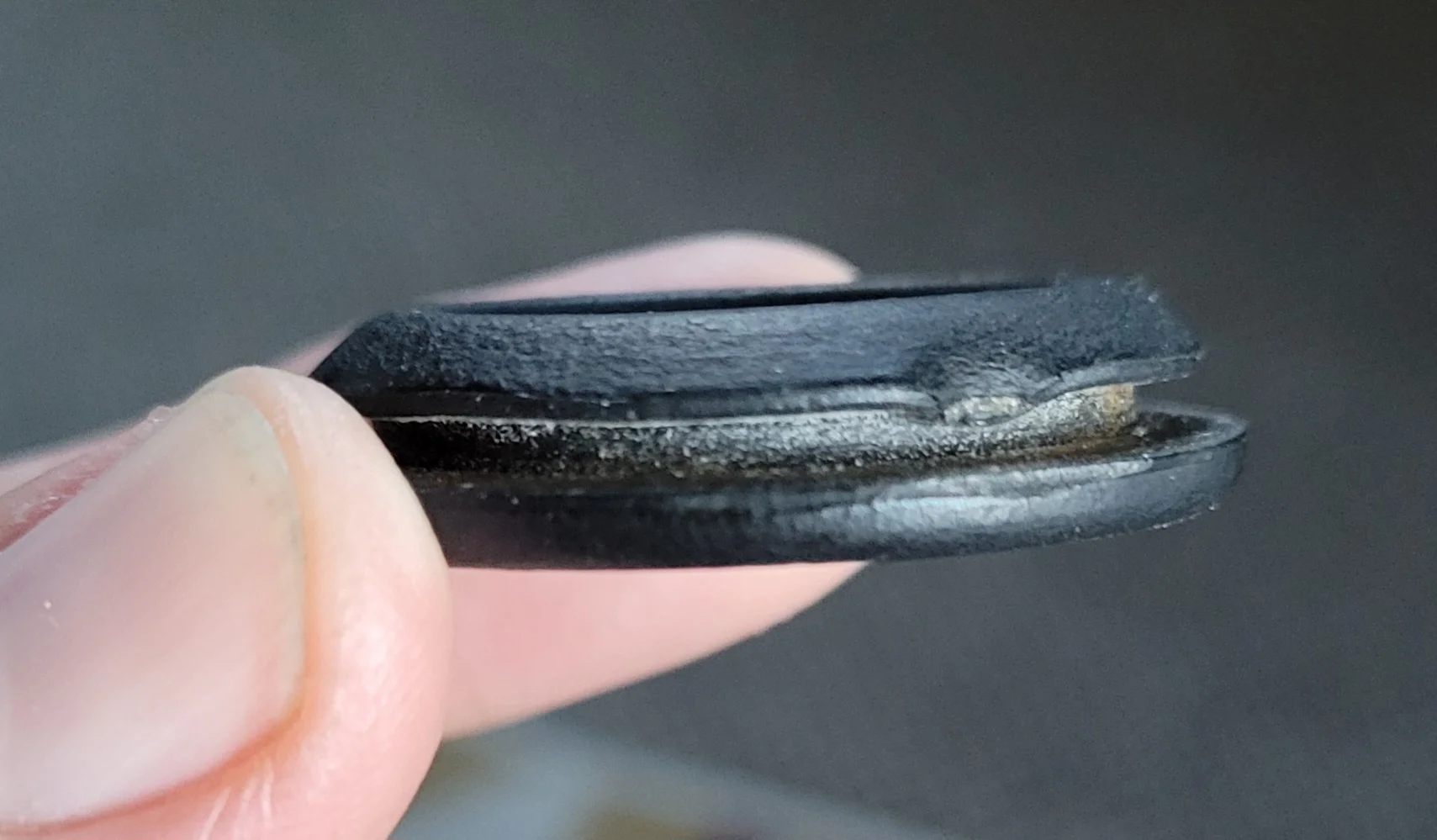

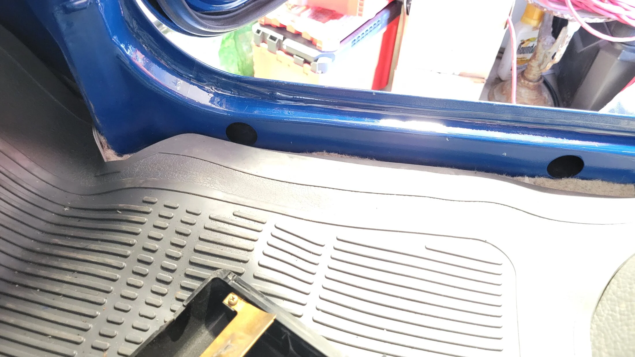

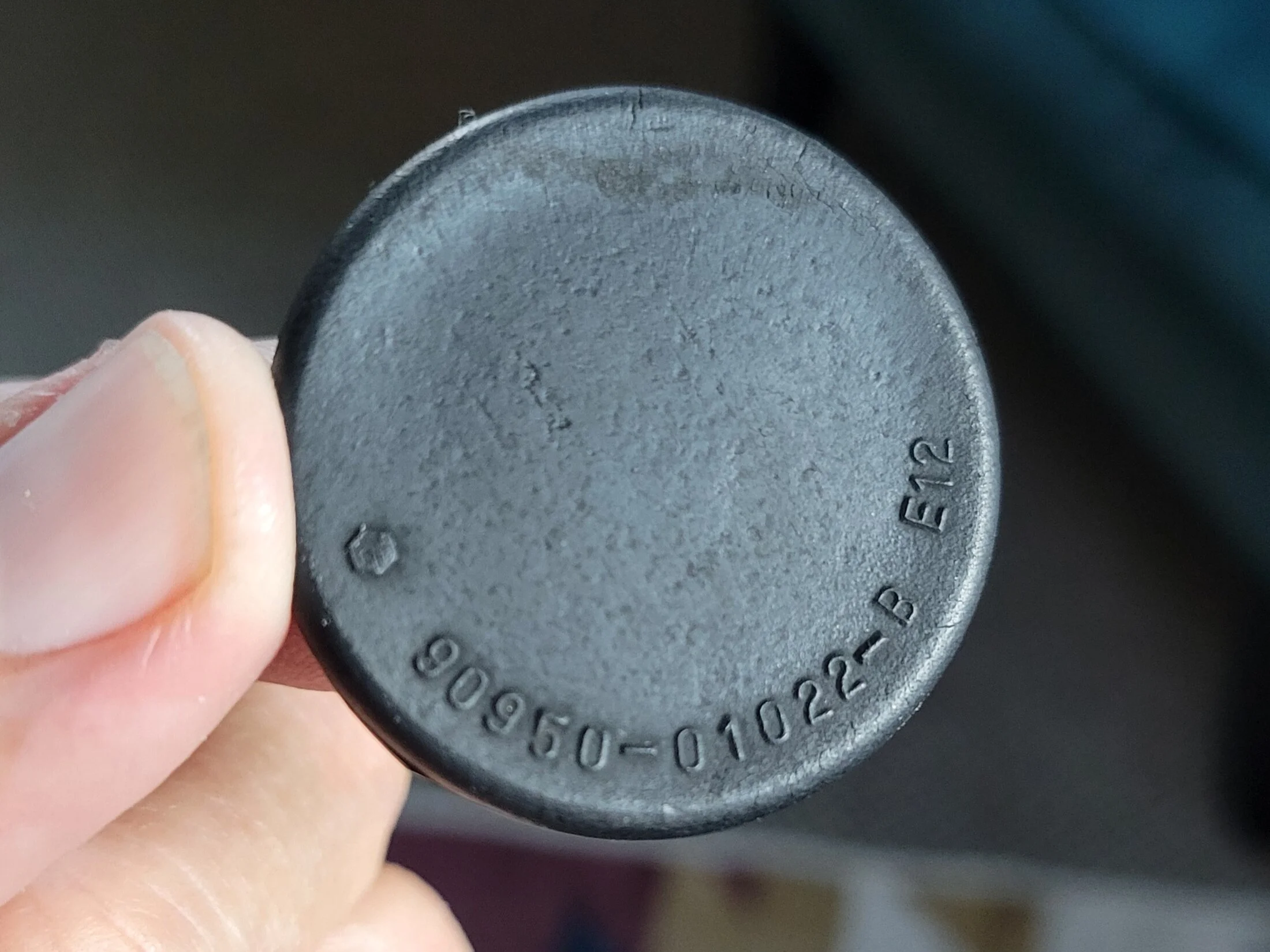

Hi all, I've done a fair amount of searching for these plugs but can't seem to come up with them. I'm attaching several pictures. I'm sure someone here knows a source for them. I've tried searching the part # at Frontier Toyota also and nothing there... I pulled this plug outta my '78 FJ40 for reference. My new-to-me '83 is missing all 6 at the base of the doors and along the floorboard. Thanks for any suggestions or links.

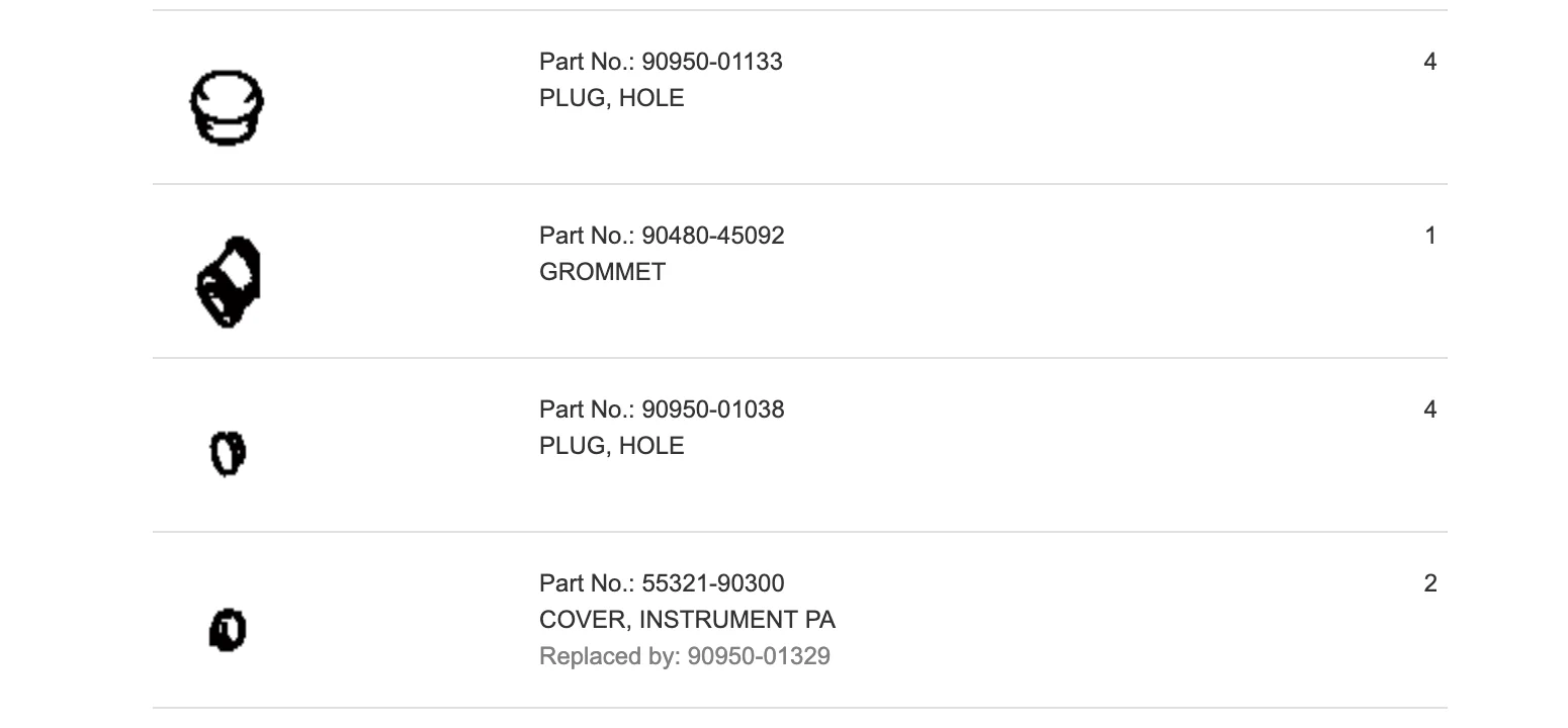

Thank you so much. Looking at both sites, neither have the correct number on the plug that I have. They don't give dimensions of the plug, so I hate to just order these (pictured below) in hopes that they're the right one. It does say however that this one pictured does replace the old number. Their picture sucks but I've probably already answered my own question in the sentence prior. HA!
