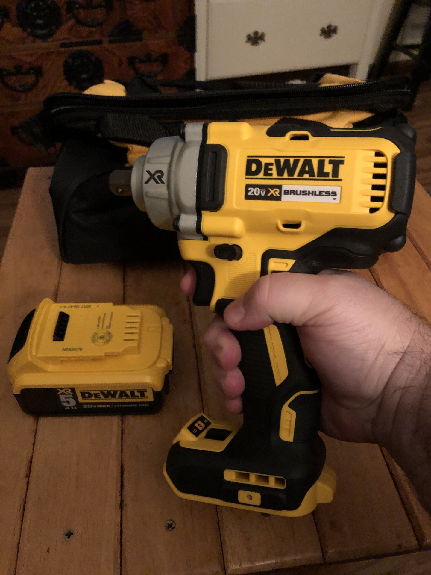

Looking to get a compact impact driver and thought I'd access the knowledge of you folks. As posted on the last page, two Christmases ago, I got a DeWalt 20V XR Brushless 1/2" impact gun that I love. It came with two 5Ah batteries that hold a ton of charge, but are also a bit heavy. It works awesome for the stuff I bought it for, taking off lug-nuts and other large/stuck bolts, but it's overkill for the smaller stuff and definitely for driving screws. So, I find myself wanting a smaller gun for the "light work". I'd really like something pretty compact and good for screwin' and unscrewin' screws, but yet powerful enough to remove smaller bolts as well. Since I really like the big DeWalt, I figure sticking with DeWalt kinda makes sense, but I'm not completely opposed to other brands as well.
Option #1 (cheap, light): I thought about going with a DeWalt "Xtreme" 12V Max Brushless 1/4" impact driver - DCF801F2. It's 1.75 lbs., and puts out 120 ft.-lbs. So it weighs about half what the big DeWalt that I have weighs. It's about $129 on Amazon, and comes with bag, charger and two 2.0Ah batteries.
Then.....I thought, well.....it would be nice if I didn't have to worry about two different voltage batteries.....
Option #2 (more expensive, powerful): So there's the DeWalt 20V Max XR 1/4" Brushless impact driver - DCF887B. Essentially the baby brother to what I have now. It's about 1/4 lb. heavier than the 12V unit at 2 lbs., but still way lighter than it's big bro. It puts out about 167 ft.-lbs. It's $139 on Amazon (double the cost of the 12V unit) and I'd still need to buy batteries since I don't really want to use the heavy 5Ah batteries, but at least I could also use the smaller batteries on the bigger impact and vice-versa, if I wanted to.
Option #3 (a good compromise?): A cheaper option than #2, but still 20V is the DeWalt 20V Max 1/4" impact driver - DCF787C1 (not the XR, but still a brushless motor). Power is comparable to the 12V brushless unit with about 125 ft,lbs. Weight is just under 2 lbs. Right now on Amazon I can get this one for $130 including bag, charger, and one 2.0Ah battery.
I'm open to other ideas as well. What say ye?

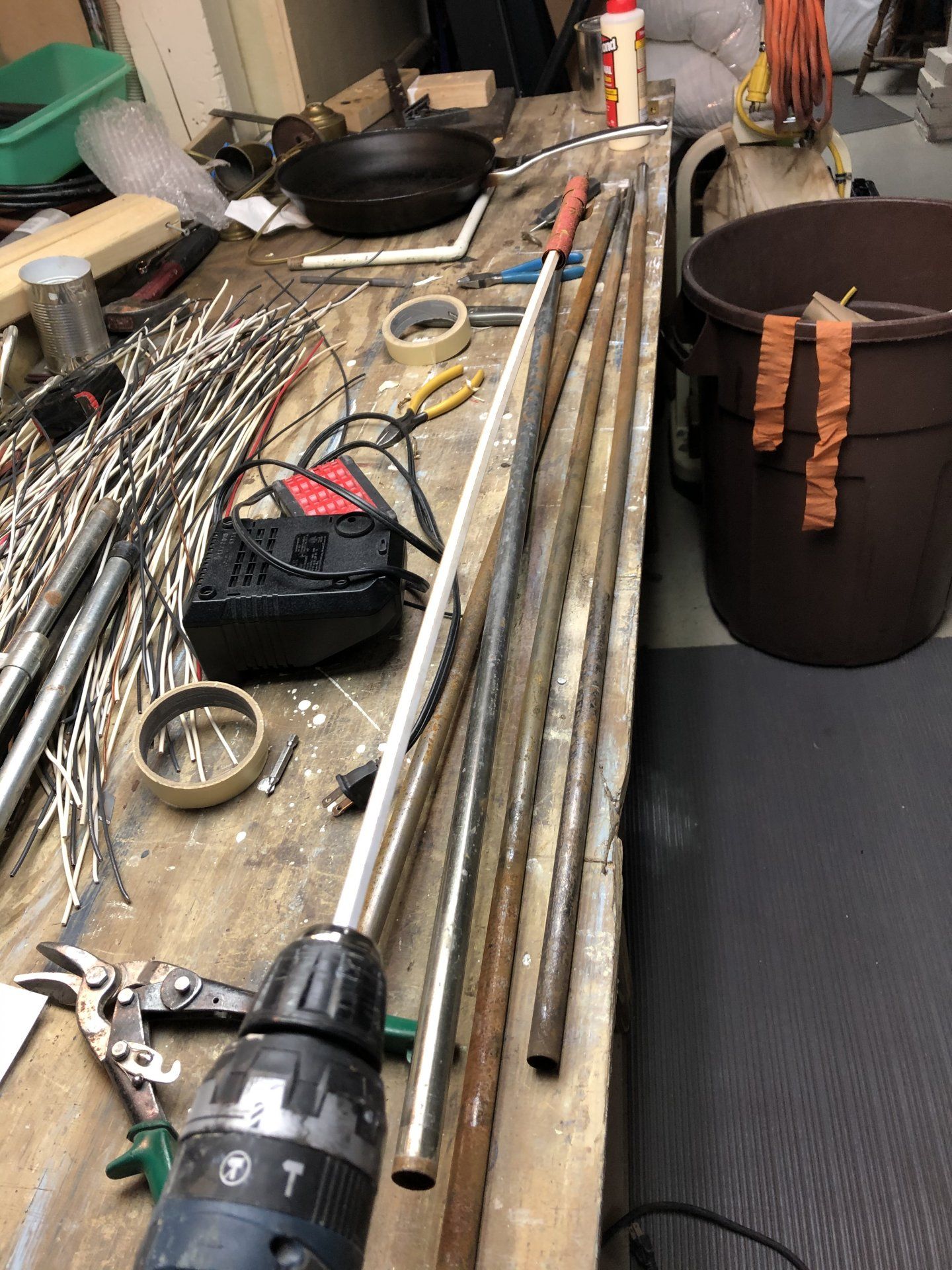

Work load has turned to camping preparations. Rusty extension poles, inside and out. No problem on the outside of pole. Inside needed special honing tool. Flexible plastic window rod with 50 grit flapper paper taped to it. The rest is history.
Don't you mean "The rust is history"? :rofl:
:rimshot:
