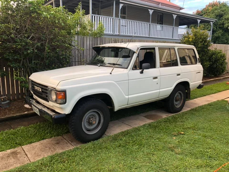

Hey everyone.
I'm trying to find a tire in the 235/85r16 or 7.50r16 range that sits fairly close to flush with the face of the rim. The Land Cruisers that I grew up riding around in Australia all had the true pizza-cutter look and thus the tires didn't have much of that bulge in the sidewall. Is this something to do with how many ply the sidewall is? Is this something that is exclusive to bias ply tires or is there something in a radial that is available?

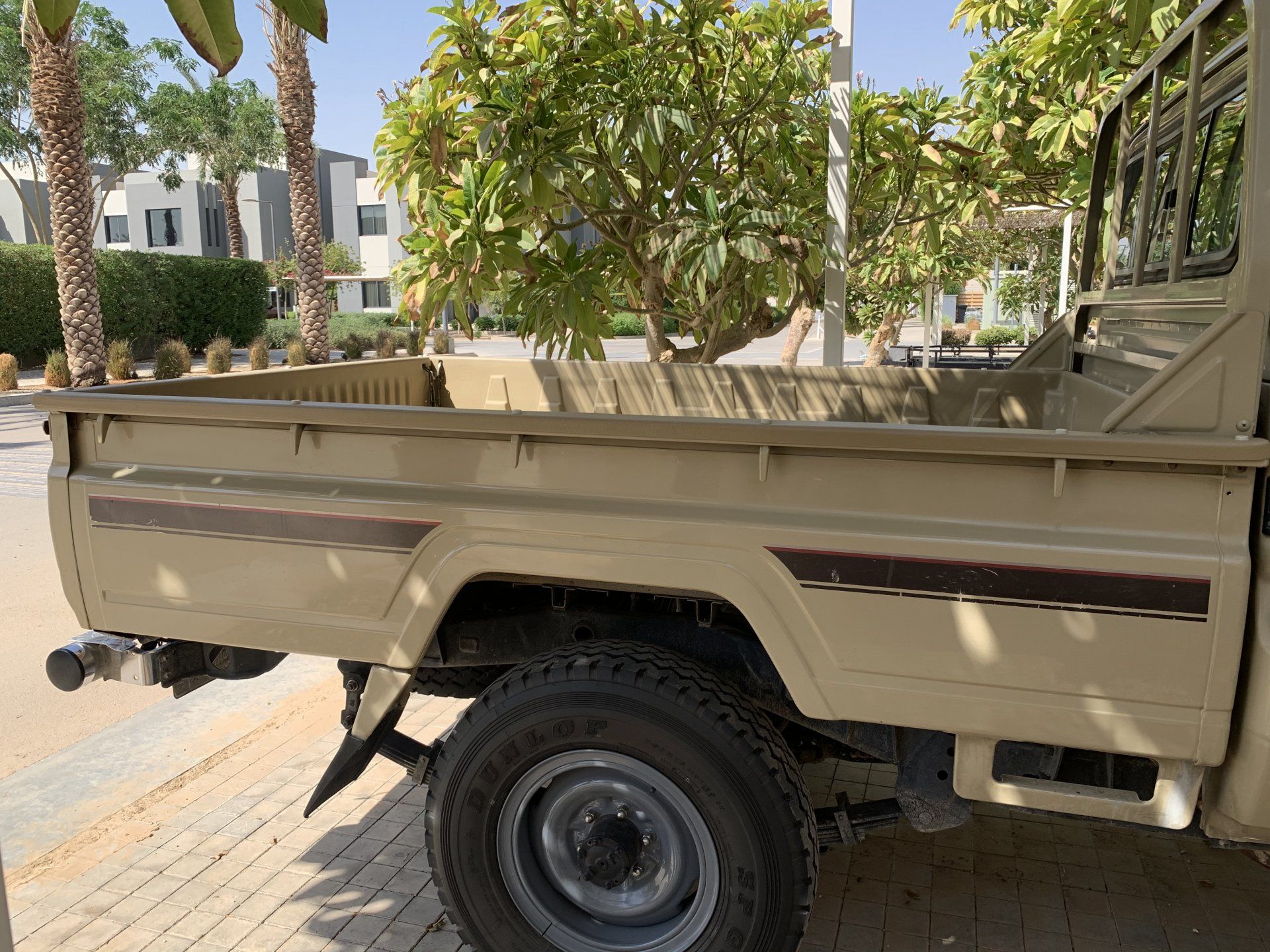

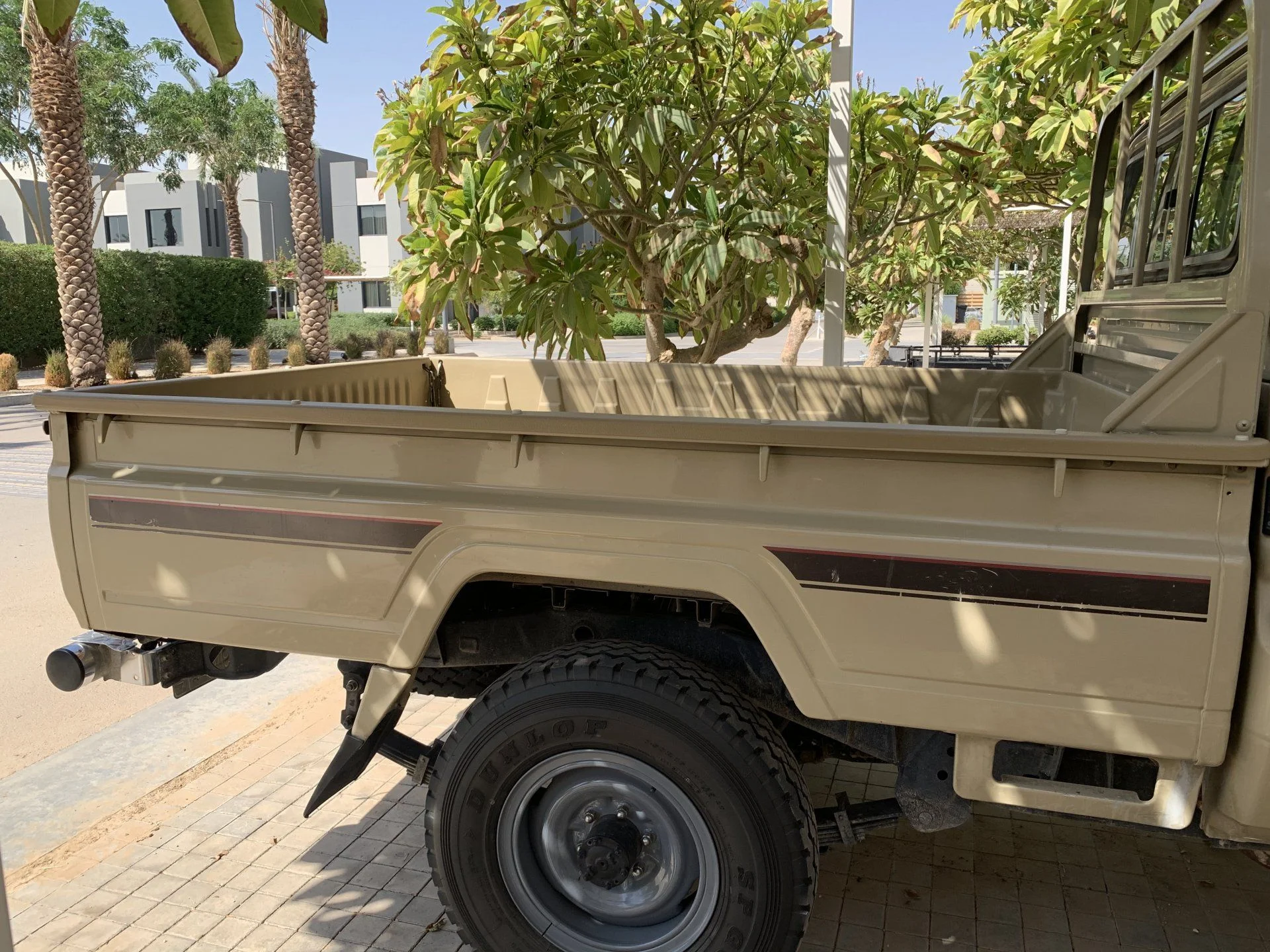

HERE IS A PICTURE OF MY INTENDED GOAL:

These Japan made Dunlops have almost no bulge. Not sure if they are available in the US. Dunlop SP Qualifier TG 21. It is a radial and can be used with or without a tube.
Mate I dream of having the Japanese-made Dunlop’s available here in the USA but they unfortunately aren’t. They are the perfect tire.

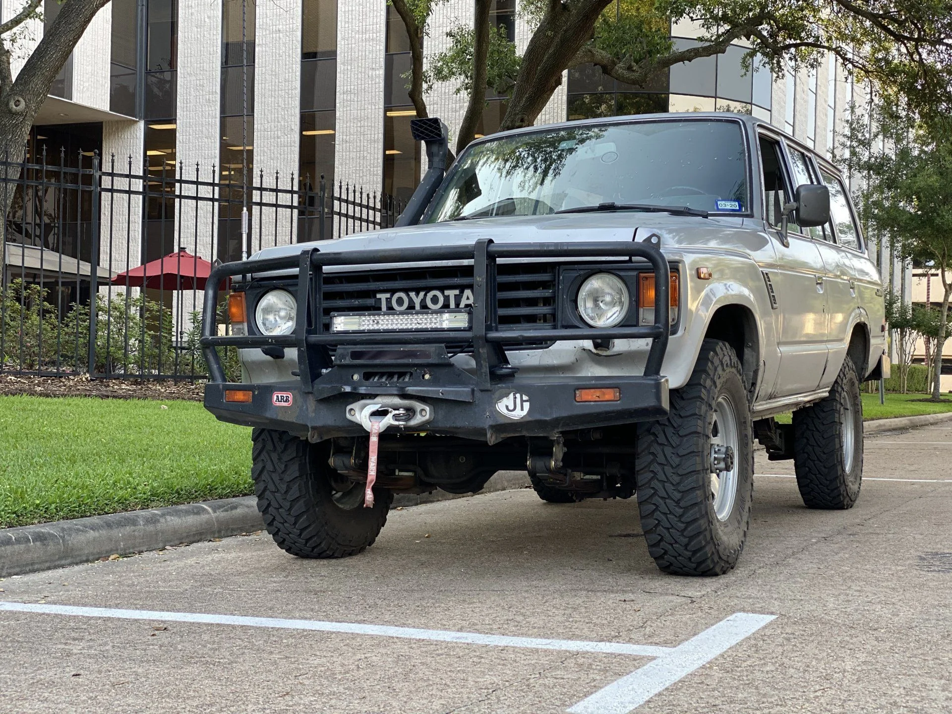

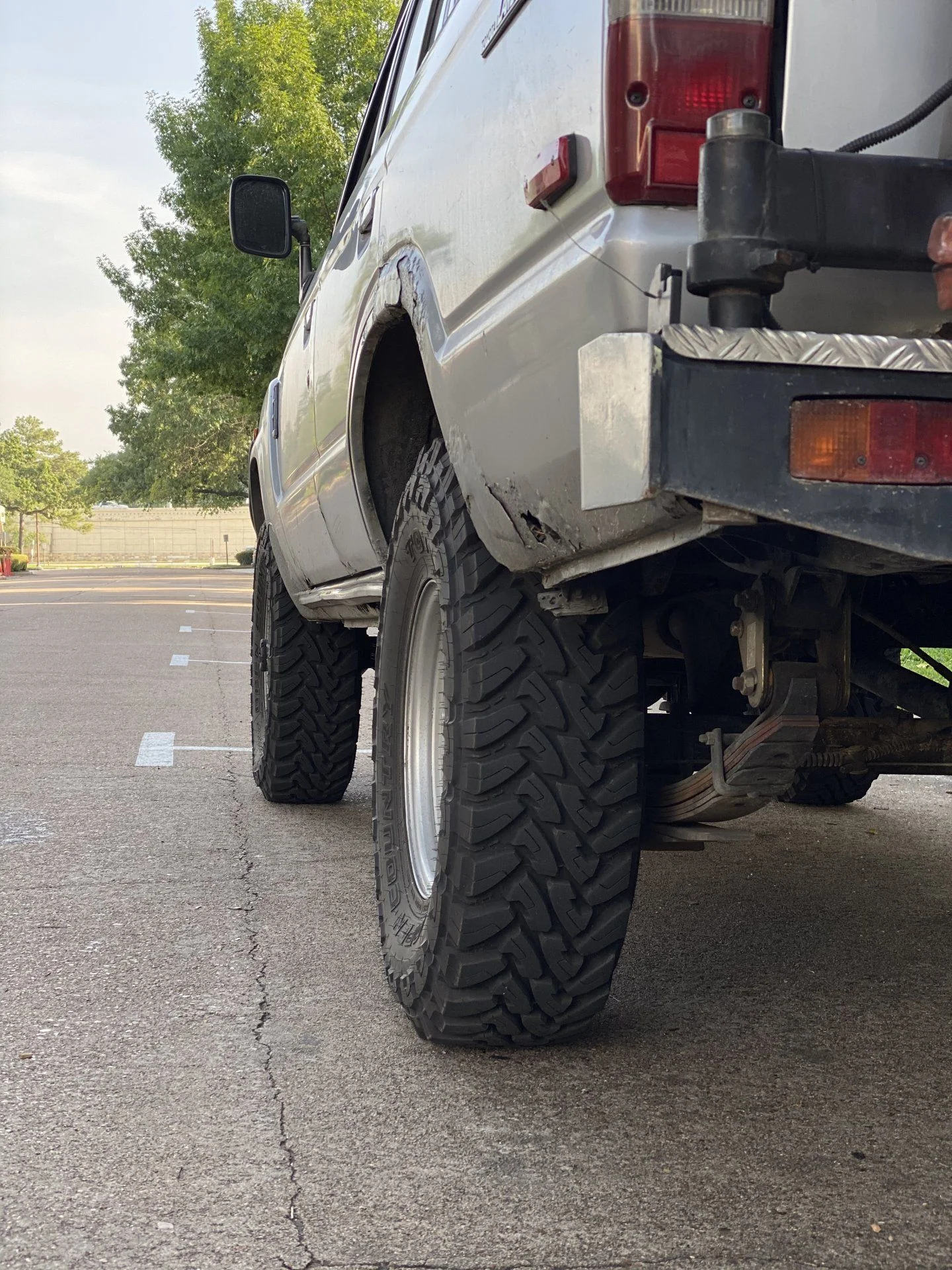

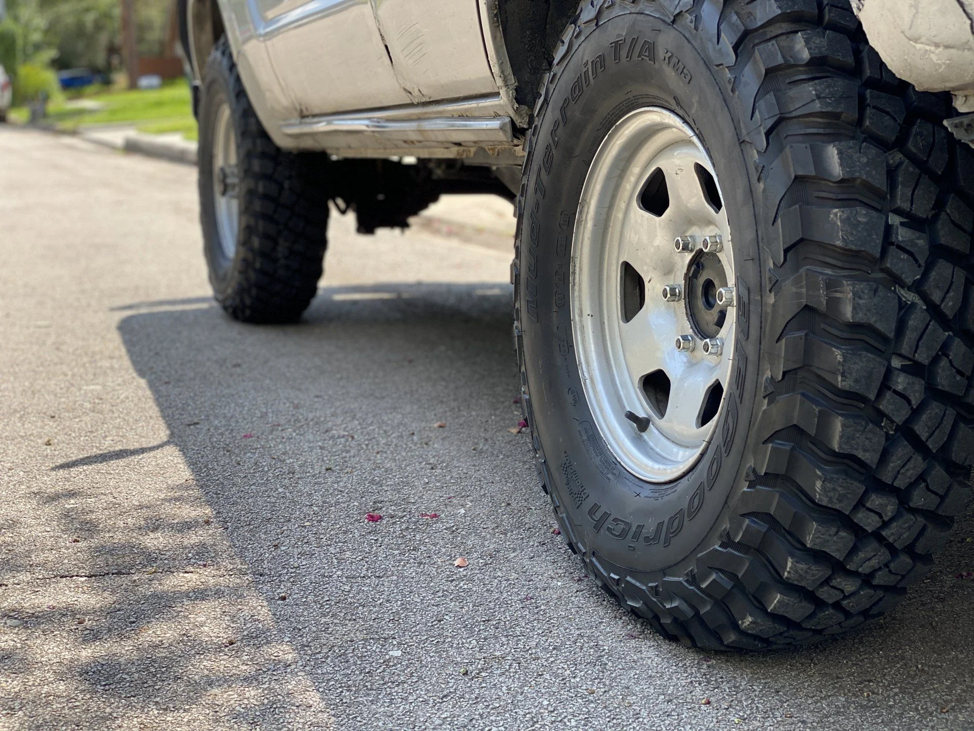

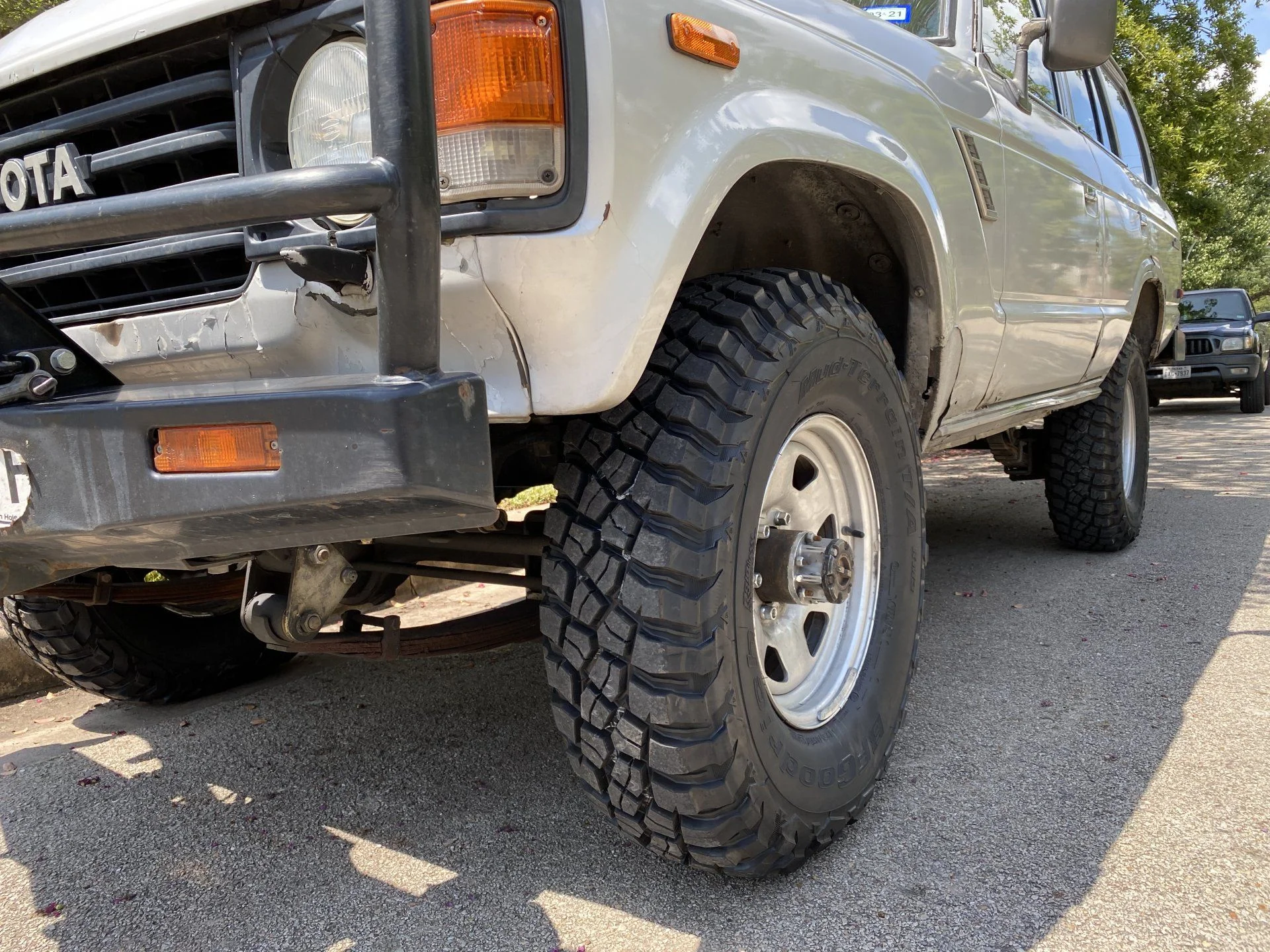

255/85-16 on a 16x6.
Toyo MT up top, BFG KM3 below.
I don’t recommend the Toyo. They pulled hard no matter what I did. The Toyo looked better but that doesn’t mean anything, the Km3 is a hands down better tire all around.
My next set will be 235/85-16 or 255/85-16 Yokohama G003 on a 16x7 for my 40 series.
