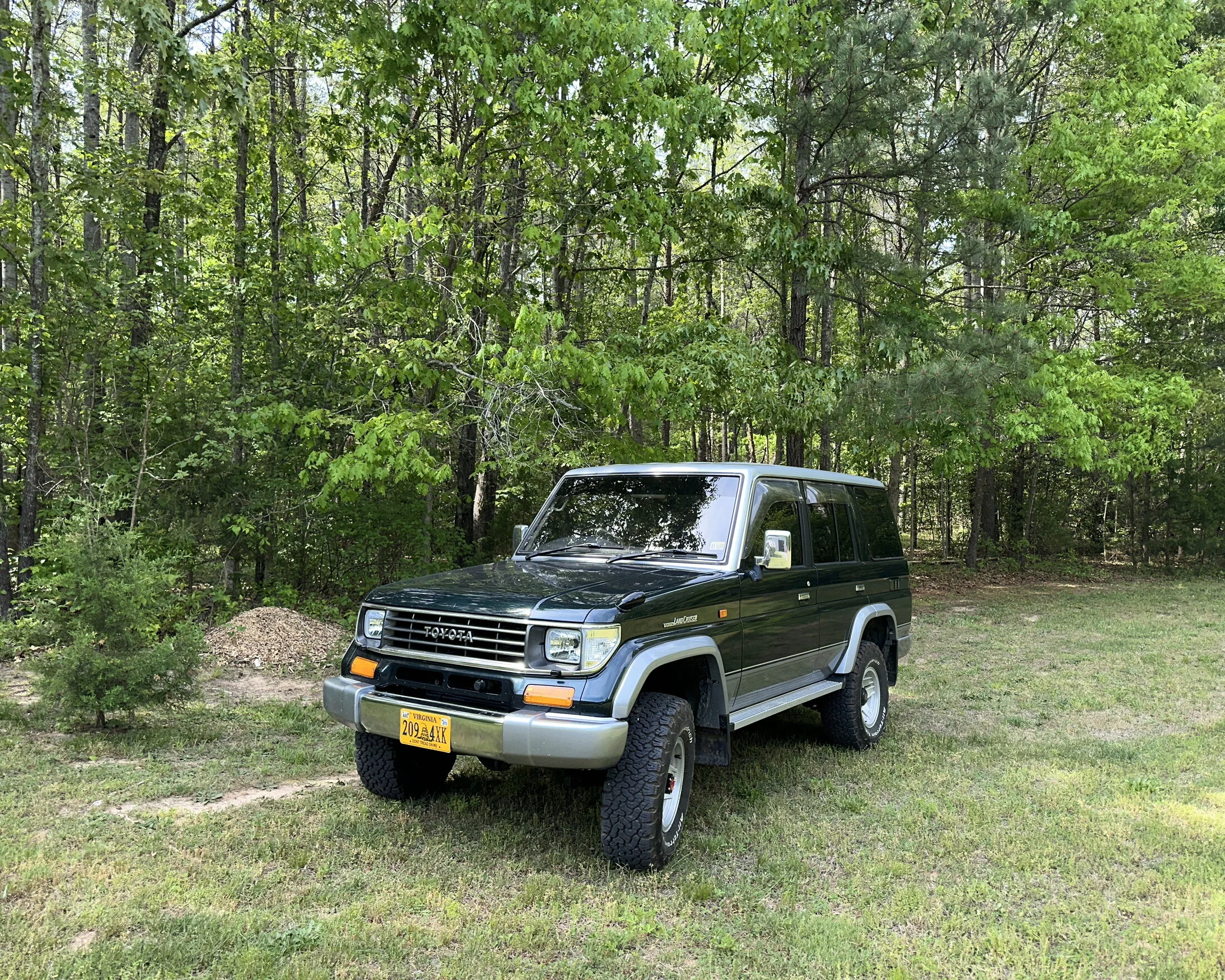

I have a 1995 KZJ89 Prado and want to replace the stock headlights. I was looking through old threads and settled on getting the Trucklite 37450C's. I saw conflicting information on reversed polarities and such and just wanted to make sure they are actually compatible and/or if they need an adapter/harness. My electrical knowledge is not the best so any tips help, and also maybe recommendations for other headlights.

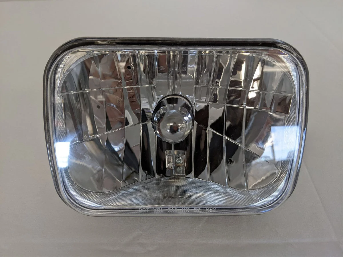

I’m running the Truck Lite 27009 with LED bulbs in them. These retain the stock look in a glass housing and add great visibility. Cut off is exactly where it should be. I’m also using an H4 wiring harness.

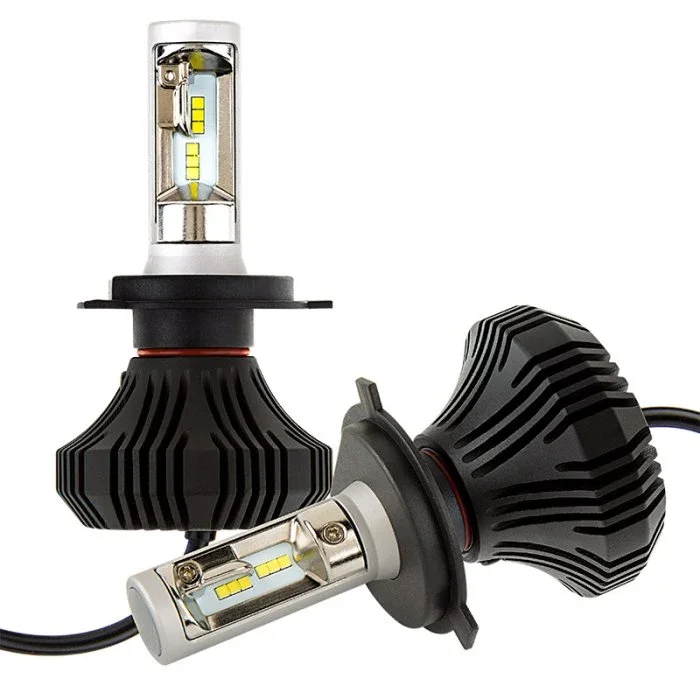

H4 / 9003 LED Fanless Headlight/Fog Light Conversion Kit with Compact Heat Sink - 4,000 Lumens/Set - Cool White - https://www.superbrightleds.com/h4-led-fanless-headlight-fog-light-conversion-kit-with-compact-heat-sink-4-000-lumens-set-cool-white
