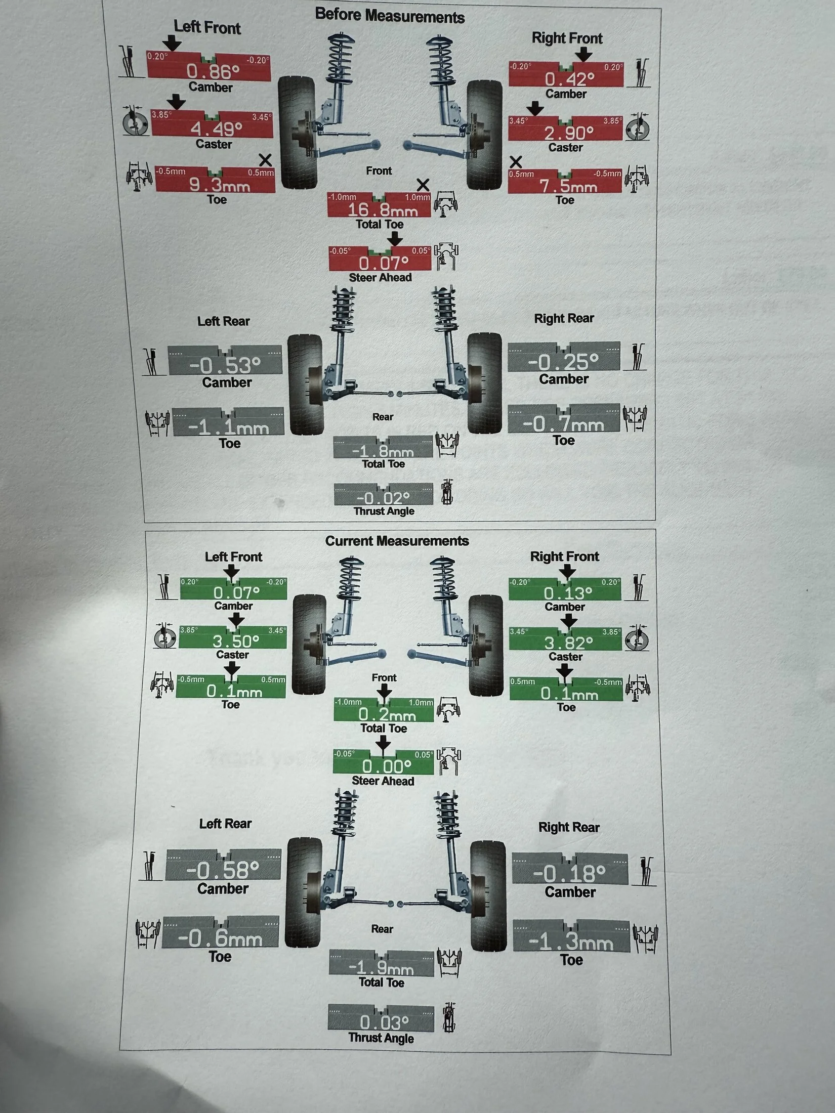

Alignment sheet 👌🏻

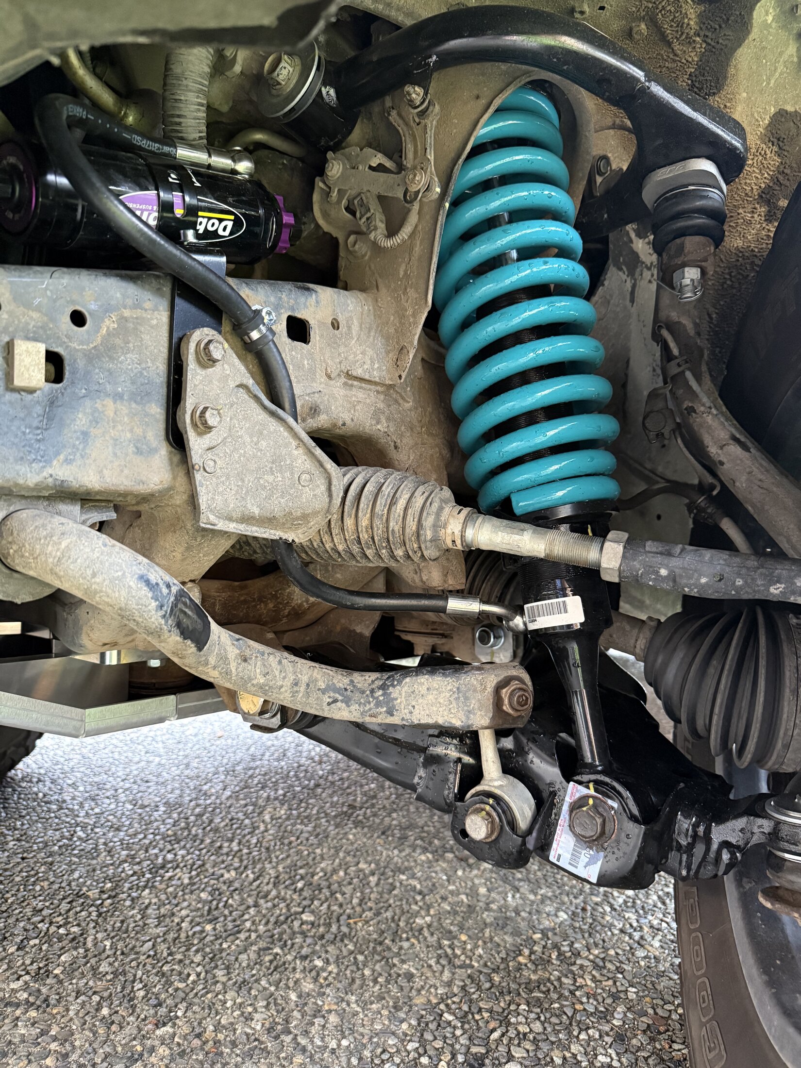

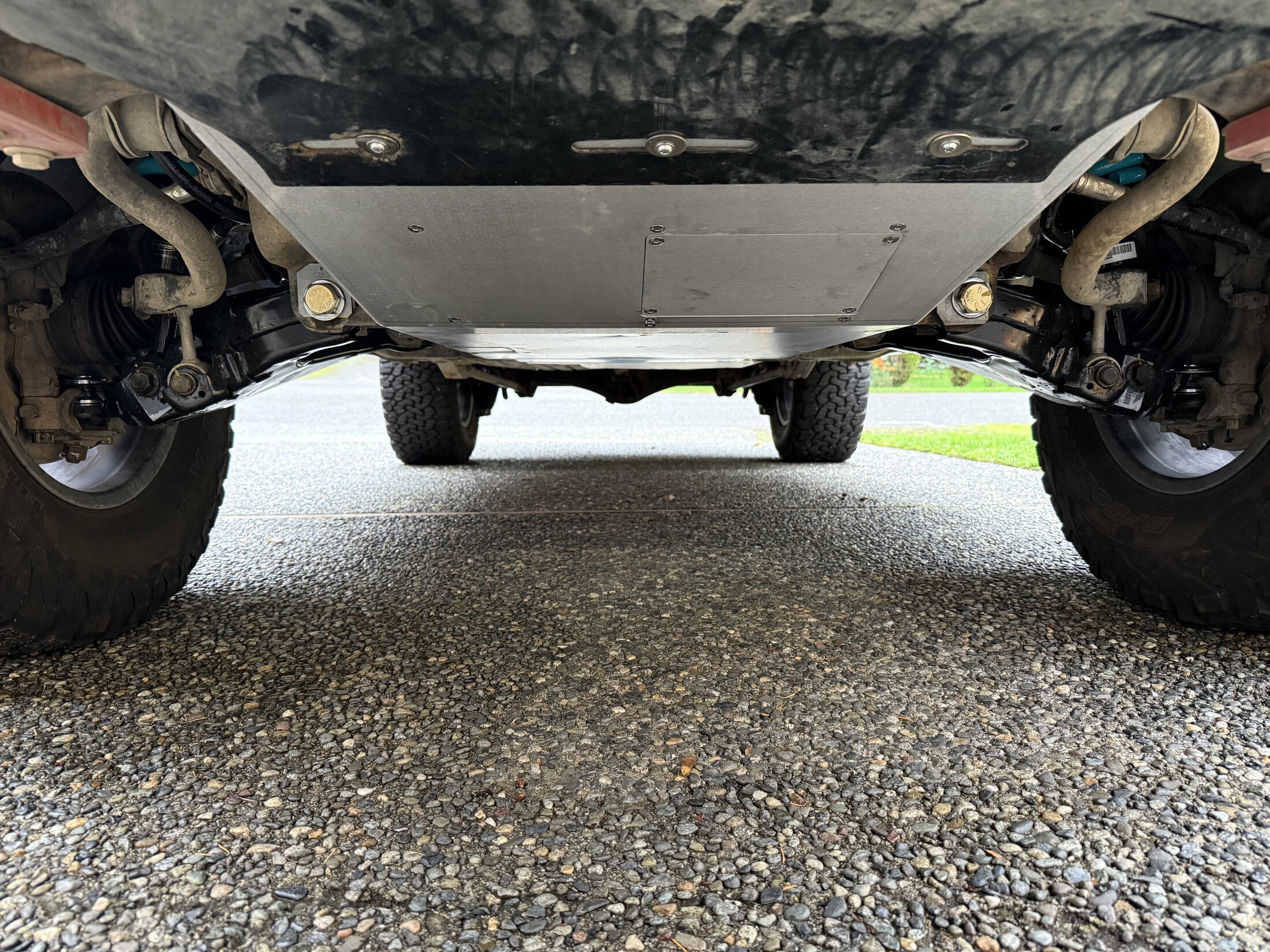

One more angle:
You can see how OEM height sensor bolts to SPC UCAs and how I am still smashing my sway bar with the 12.50” wide tires lol.
Between the ball joints, coil overs, new steering rack, new tie rods, and new sway bar links—everything feels like butter.
Also I’d love to know how the F Toyota decides where to put stickers on parts. It’s literally always in the worst spot.

One more angle:
RE sway bar, you might be able to use KDSS sway bar relocation bracket to bring the bar forward putting tire where the bar has the most clearance.
🤔 never thought of that. I’ve got new bushings sitting on my shelf so may try that while I’m in there.
Any recommendations on the bushings? Mine are ripped. I used some generic poly sways in the back.
I bought all OEM. Considering the originals lasted like 175k miles I think they are probably pretty good.

Oh one more thing. I need to do a zero point calibration at some point. I totally forgot about it until making a brisk hard left into a parking lot and the truck thought I was skidding and cut power.
If you lift your truck don’t forget this step.

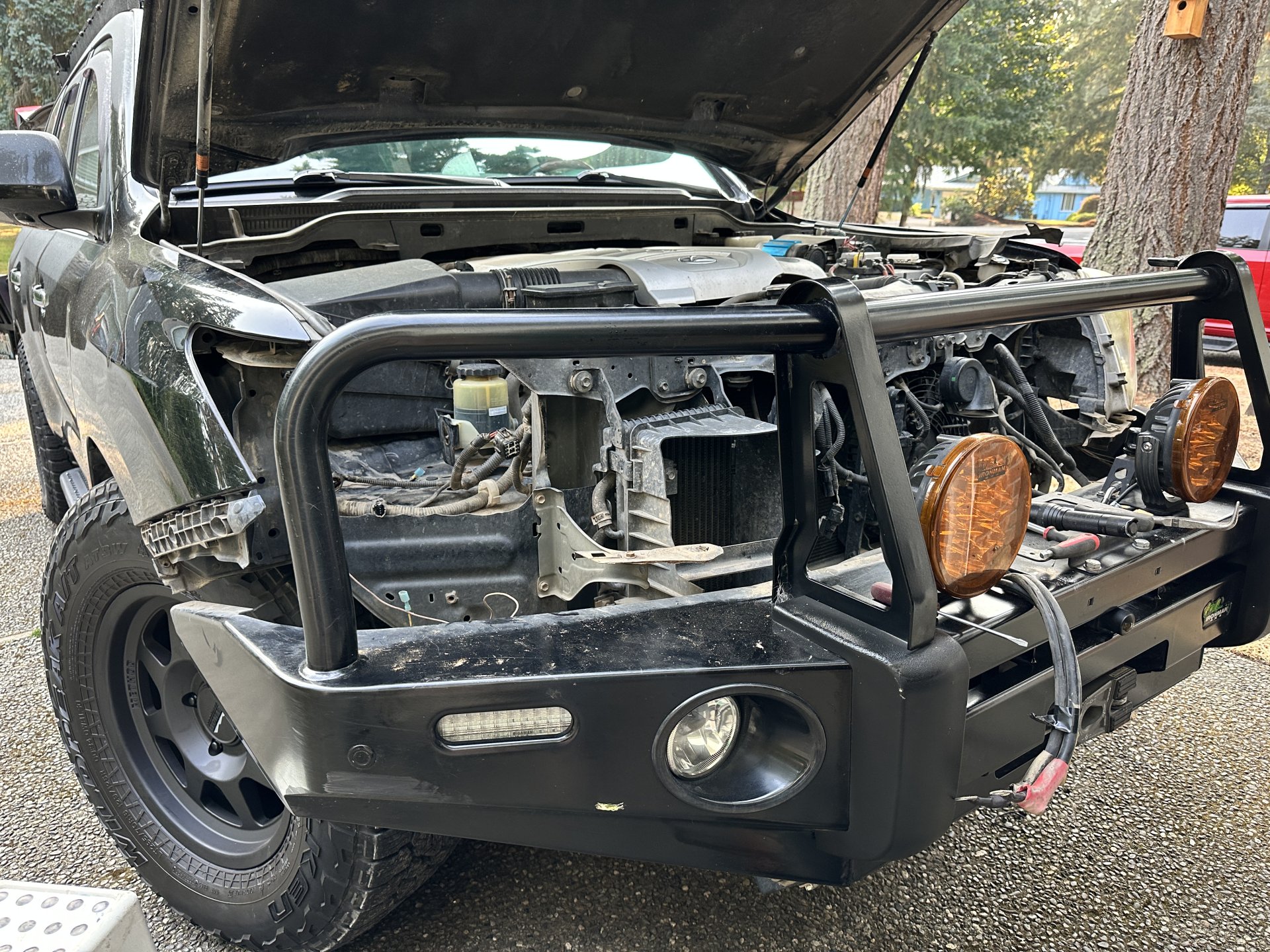

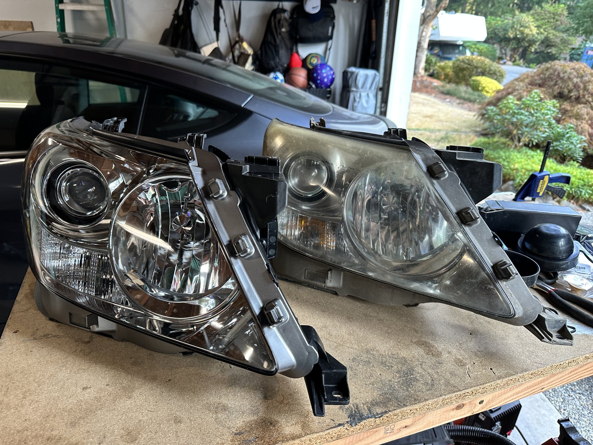

Second thing, new OEM headlights. My originals were trashed, way beyond polishing. New units are super expensive because the assembly includes all of the AFS servos etc. However when you see them side by side, it's all worth it:

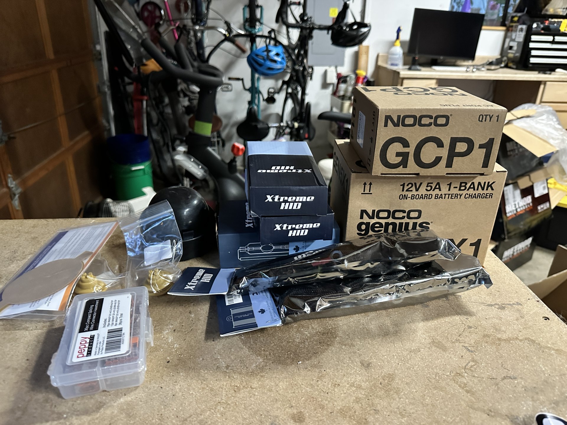

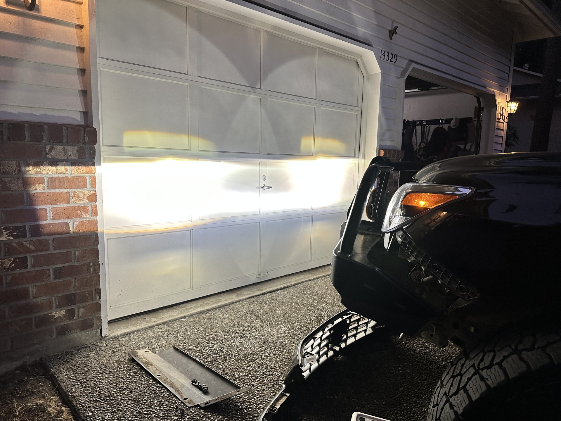

While I was in there, I removed my Hikari H11 low beams and did an HID retrofit. I ordered the 35w Xenon Depot XD kit with Philips bulbs. Install was straight forward.
The output on these is so much better, and more importantly, even. The Hikari's were super bright in front and then trailed off quickly.
Nothing super interesting of note for installation except that I had to pull off basically everything up front including my winch pack. Having a bullbar made it both easier in harder if that makes sense.
The kit comes with a grommet for the pass through and I just drilled a 1" hole through the dust cap and liberally siliconed it. The ballasts and igniters are double-sided taped where I could fit them, however I did learn after the fact there this is a spot on the bottom of the light assembly for a ballast. Would have been tidy but I ain't pulling them out.

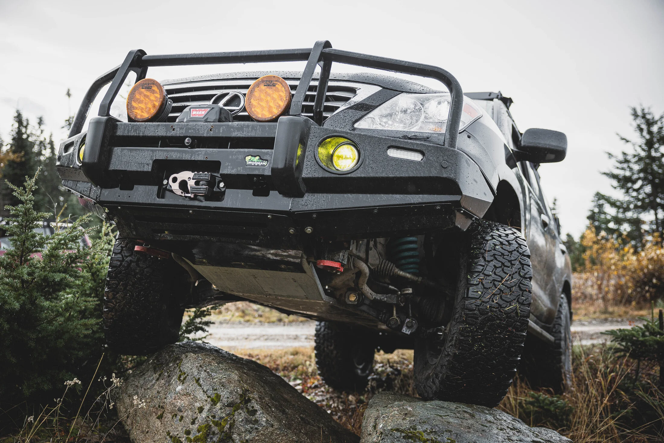

Last thing, I was thinking about @CharlieS 's post about yellow / amber fog lights and decided to give LaminX film a try. This stuff is super easy and forgiving if you do a wet install. I dont think I'll get rich yellow like my baja squadrons, but it will be nice to have warmer light that's closer to my HIDs.
Here is the whole facelift after a wash and opti-seal on the lights:
Just purchased new lights with the Lexus sale for Christmas and not being able to look at the cloudy lights anymore.

What’s your take on the HID conversion since install? Would you do it again?
Is there a programming or alignment procedure when installing the new lights? My 80 just had a level bubble.
No, the lights are controlled with the AFS servos. There are adjustment screws that move the whole assembly but I’ve never adjusted them.
I think HIDs are far superior to halogen and LED, unfortunately this set up failed twice and I gave up and went back to LEDs. I do intend on going back but trying to find a more robust ballast setup.
