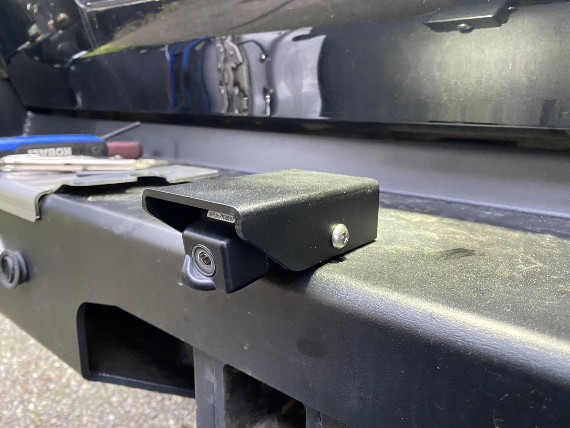

Camera relocation is pretty straightforward and there are a couple of ways you can do it. I initially consider the method that Victory 4x4 recommends: pull the rear interior panels, drop back of headliner, and run relocation wires through hatch and out by the jack. This would have required me to partially remove my drawers in order to access the passthrough under the jack. So instead I followed @radman and just ran the new wiring under the weather stripping and tucked up in the headliner and under interior panels. Dissent shipped with a block off plate, some wire, and a bracket that installs on the bumper. All of this was straightfoward but was not an out of the box fit. Initially the harness of the camera would protrude too much for the protective cover to fit:
The angle of the mount can be bent quite easily which improved the fitment but I still ended up shaving off 1/4" of material with a cut off wheel. Oh and the wholes weren't tapped but easy fix:

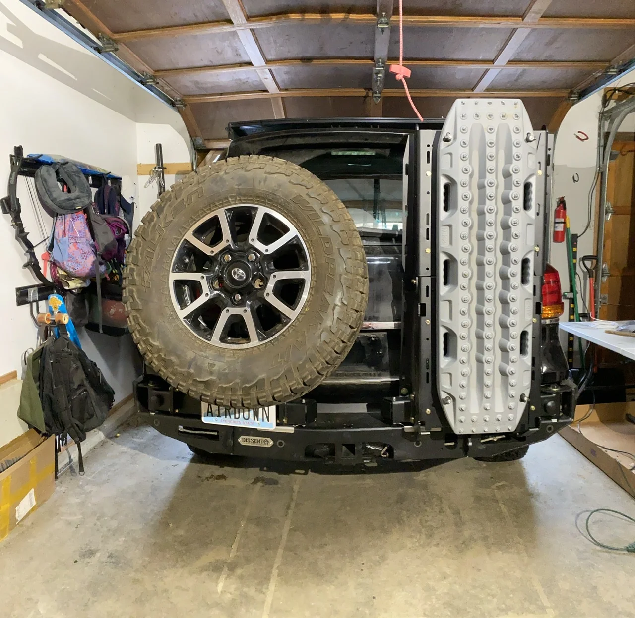

Here's pretty much her final form:
At this point I'm considering this bumper wrapped for now. There are still a couple of fiddly things like swapping sides on the lights, getting turn down welded on the exhaust, and my parking sensor harness is apparently inop — but I'm going to take a long break from tinkering with this and spend some time enjoying it instead.

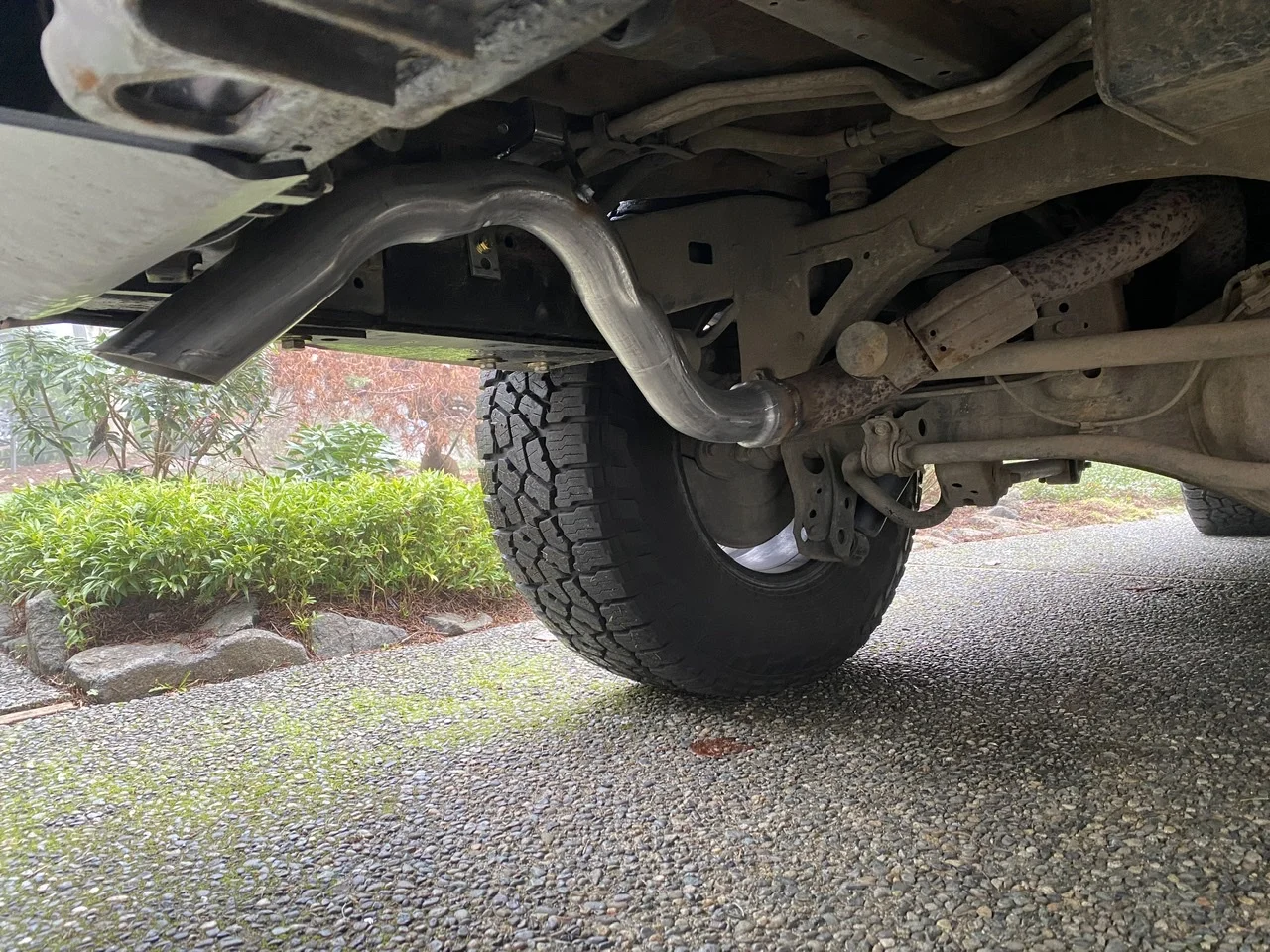

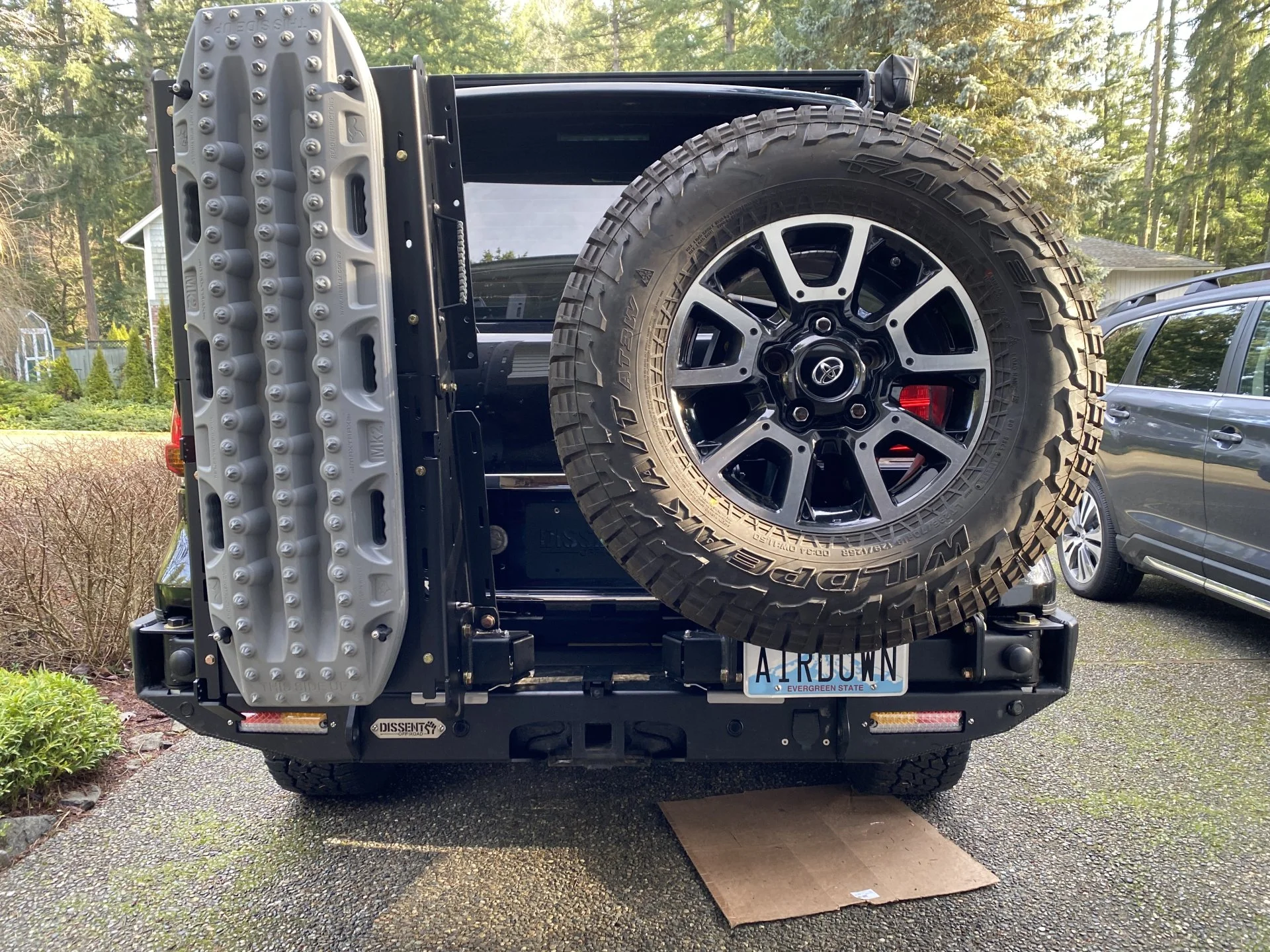

Sought professional help in cleaning up my hack job resonator delete:

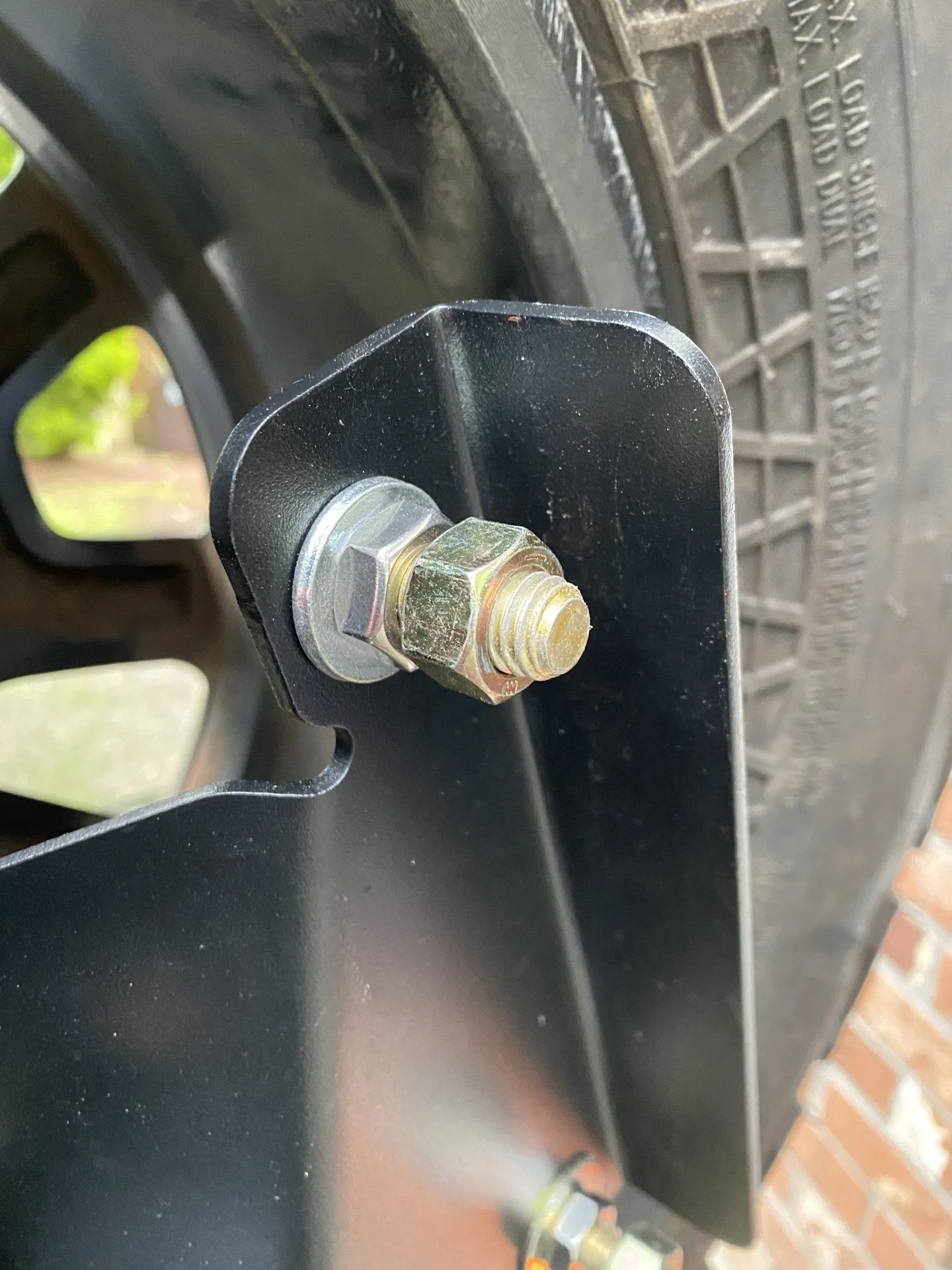

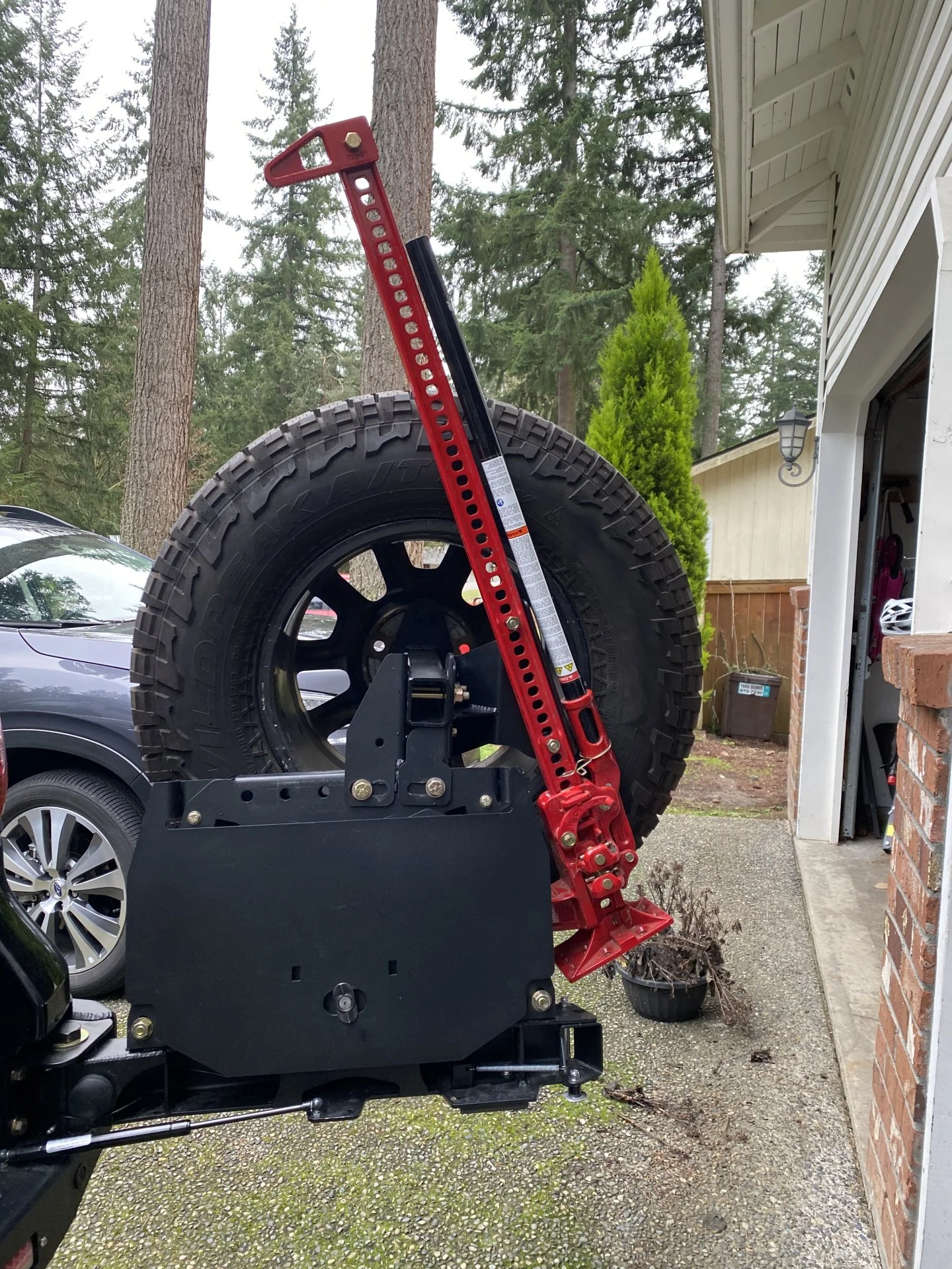

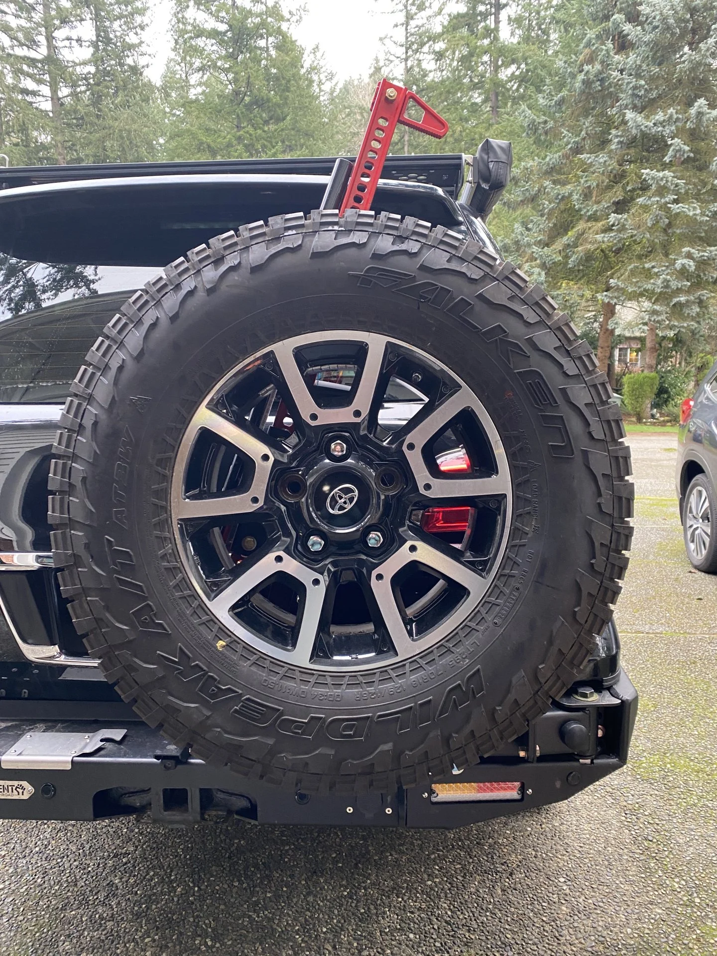

I also got my murder jack fitted:
I used a simple jam nut to give me a little more space between the jack and tire:
This isn’t hard but it is fiddly getting it right the first time. The tire holder goes up and down and in and out and the jack mount itself also moves.
What I found best was to keep tire mounted but loosen the pivot nuts and fit the jack - and then adjust both at the same time. Once you get it in the right spot you hold tire with one hand and start tightening with the other.
Also don’t mind the dead mum sitting there 🙃

Who did the tail pipe for you I had mine done and Im not stoked on it.
This is awesome info. Can you please post some closer pictures of how the high lift jack mounted?
I am trying to fit mine as well. TIA
I only have the two above. What are ya looking for?

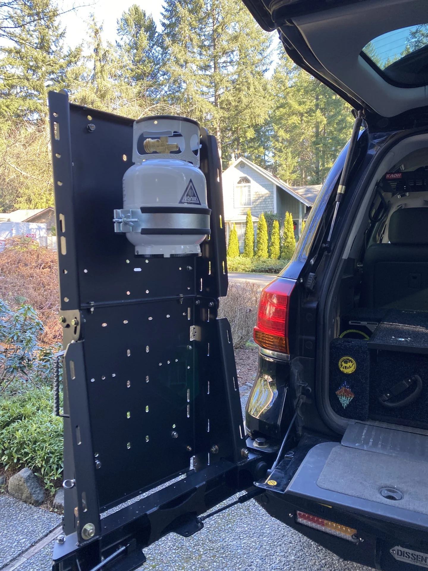

Added a 5# cylinder and mount to the back of my accessory panel today. The dissent panel makes this incredibly easy:
I really want one of the aluminum 6# worthington cylinders but they are unobtaneum right now. This will have to do for the season.
