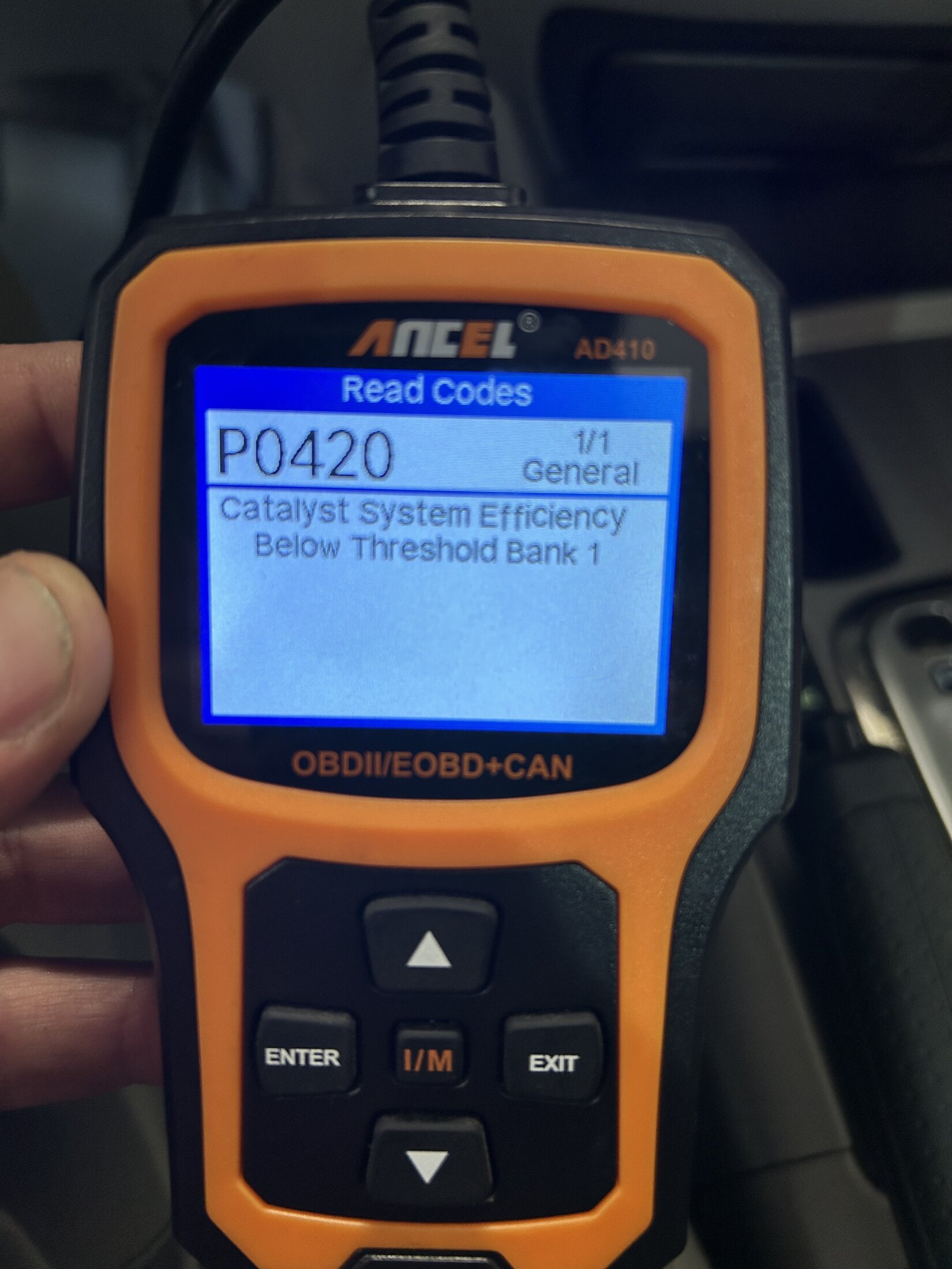

-If 0420 code returns will replace cats with universal Magnaflow options. The code is the real issue as it has led to two no start situations. One after filling up with gas. Both times vehicle cracked up one fuel cap was removed.

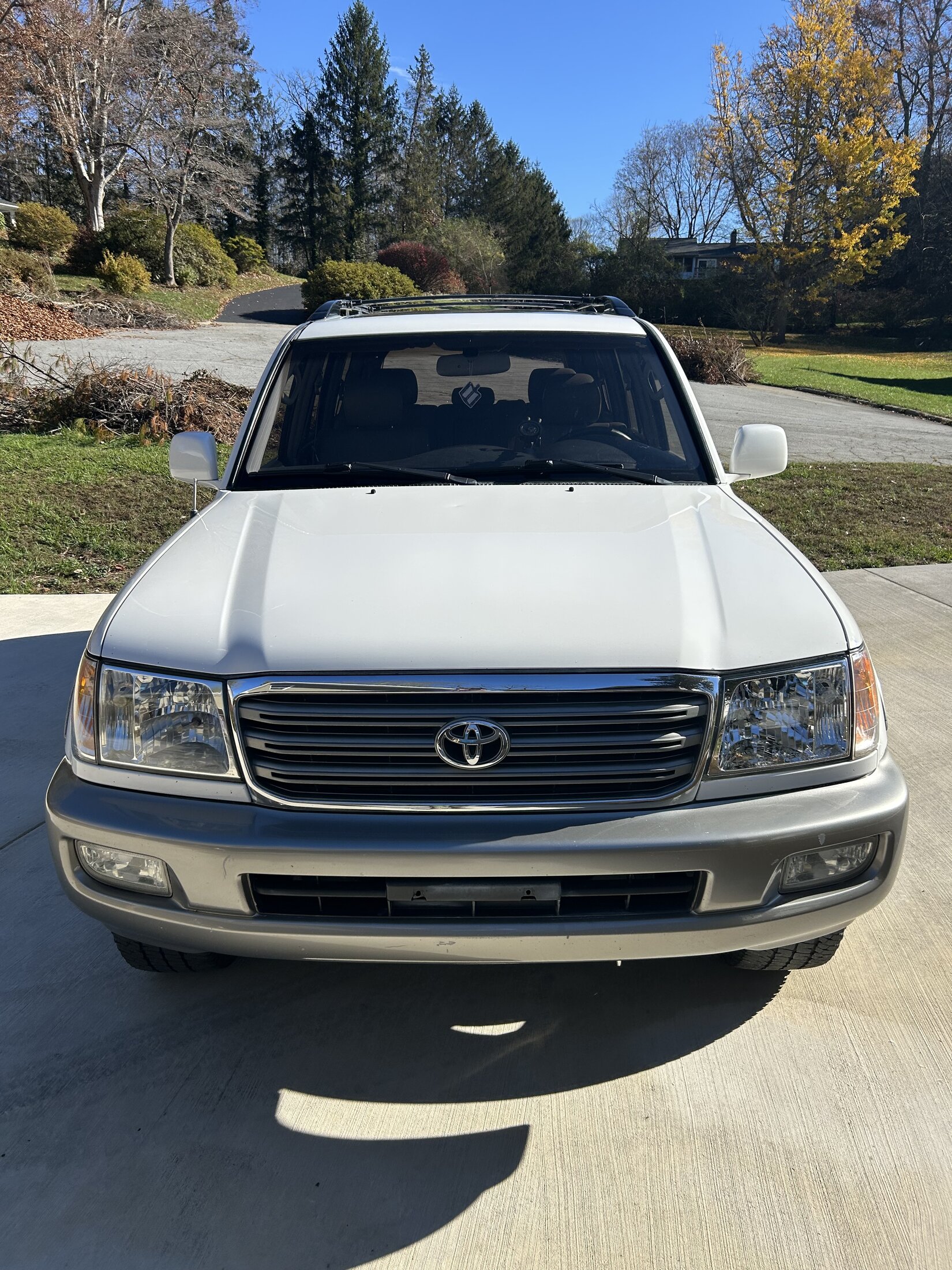

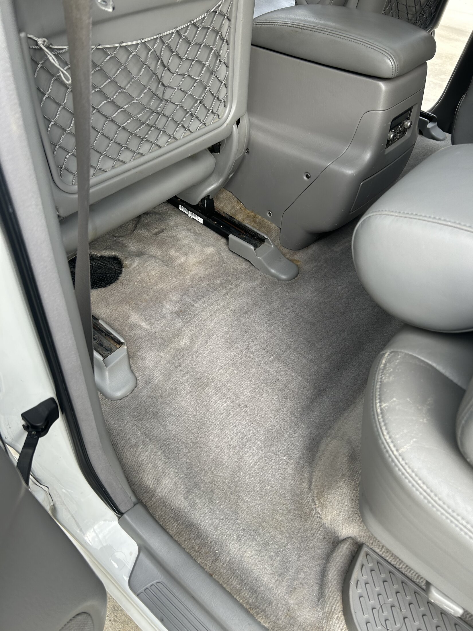

Some before pics, after a good washing but before detailing. You can see that diff bushing was toast!
At MattyO: I think I know that 100. Looking good. Glad you are making a project out of it with your youngsters. Should be good times! Nothing quite like a willing buyer and a willing seller, right?

It has not started for me twice, like it was vapor locked. First was on Friday after filling the tank. Would not start when trying to leave the gas pump. Loosened the cap and tightened it, it cranked. Them on Monday we drove to the forest to hike. Came back about two hours later and no start. Did same thing with gas cap and it started.
If you conclude that the CAT is at fault. You can remove the bank 1 CAT and clean it. I cleared the exact same code on my 2011 Pathfinder by pulling the CAT and filling it with lacquer thinner and just agitating back and forth for about 30 min. Tons of crap came out. Reinstalled and got on an open road put it in 3rd and got it super hot. Code has never come back. 50,000 miles ago. CAT’s are way easier to remove on the Cruiser than the Pathfinder. Good luck!
Interesting, have not considered that. Code has already come back so looks like it was not the O2. I am gonna try Cataclean and a new gas cap also. If it comes back will have to clean cat or replace.
Might as well. Pulling the CAT is pretty easy. I would have new gaskets and hardware on hand if you do. Best of luck!
I had the same code…I’ve been chasing the issue as well- replaced with oem gas cap seems to have done the trick, I did get the code one other time but it’s been about a week. Back up o2 sensor on hand. I did not have the no start however. GL! 03’ is a great year!

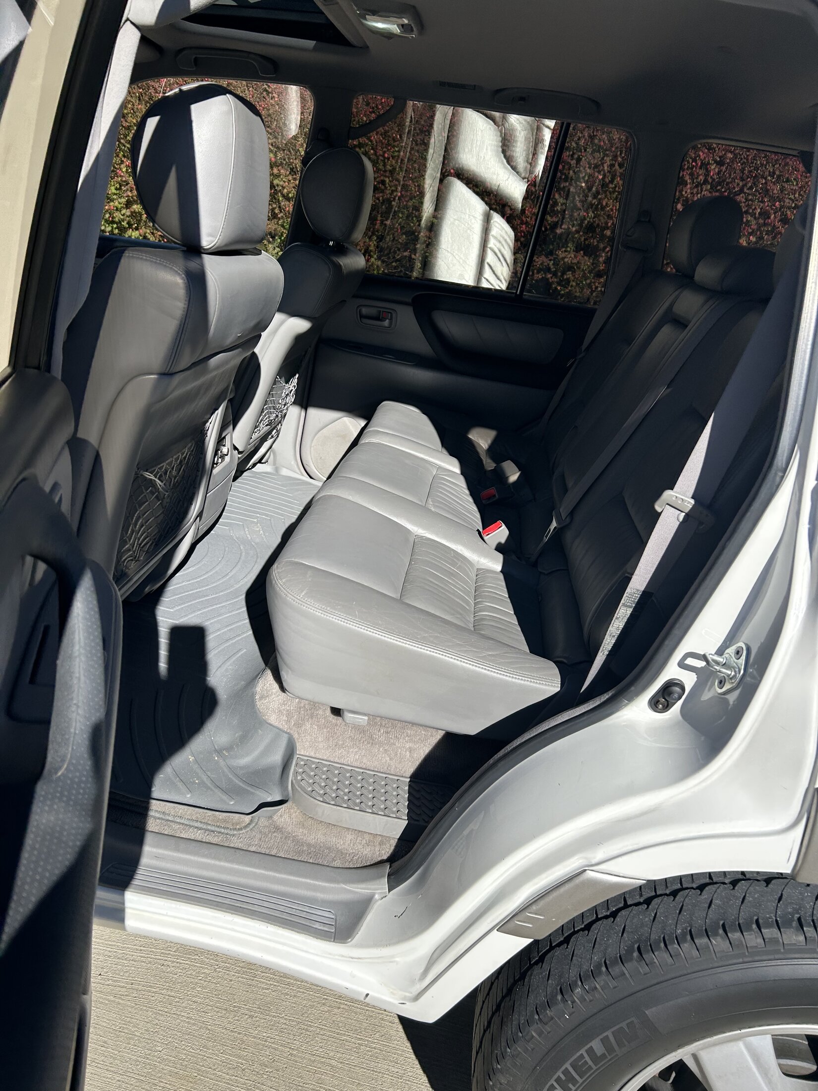

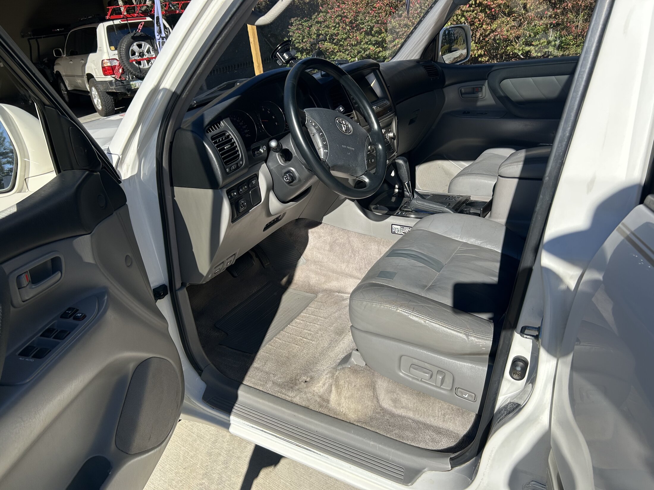

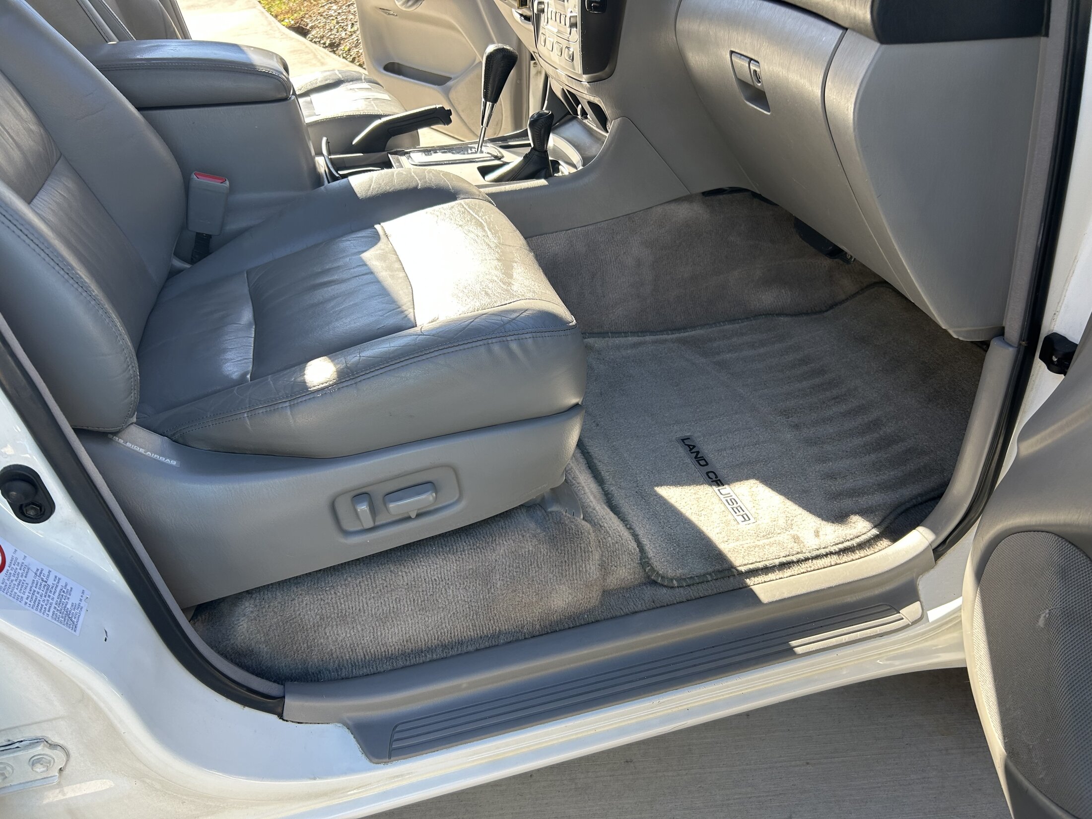

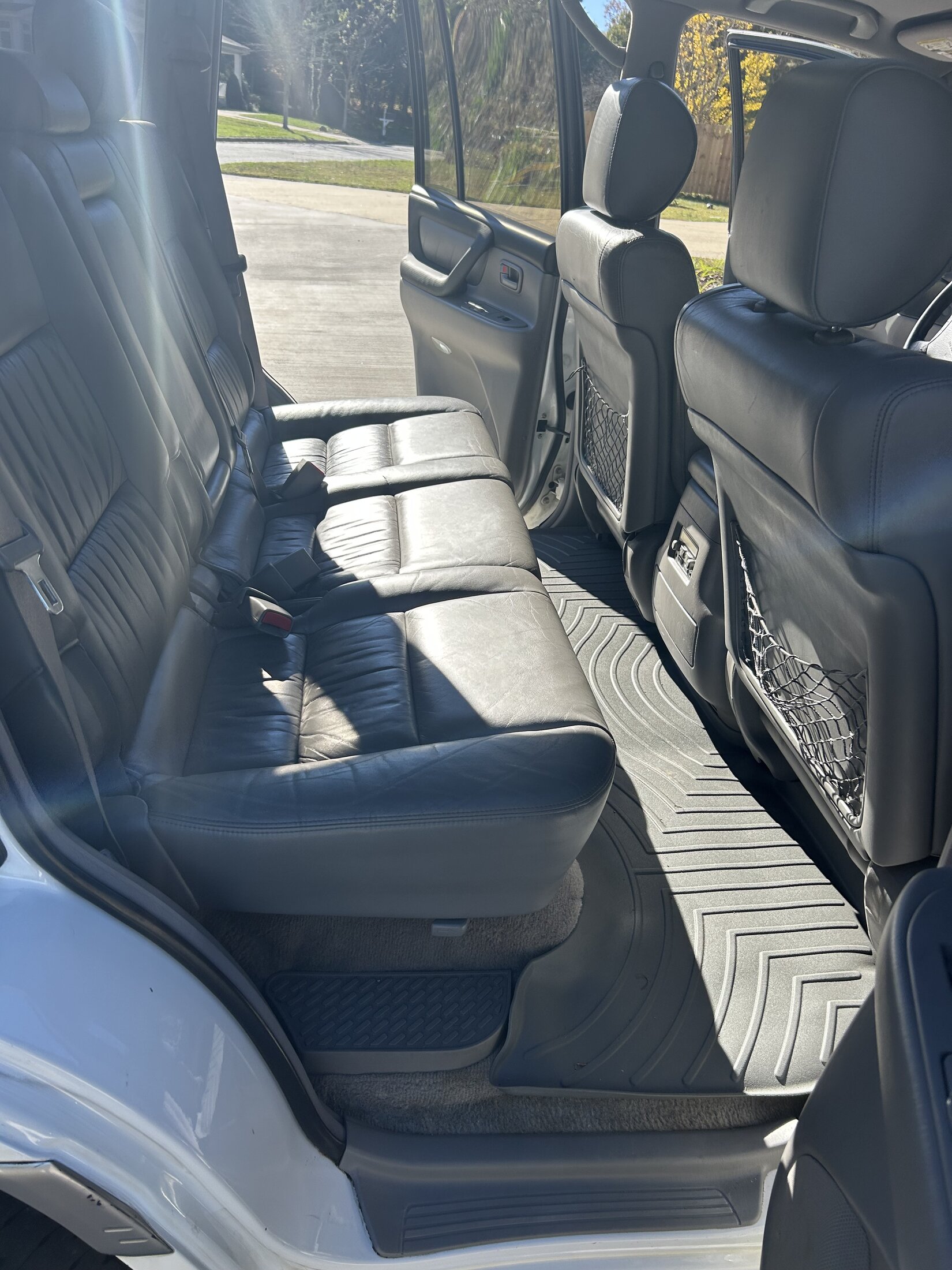

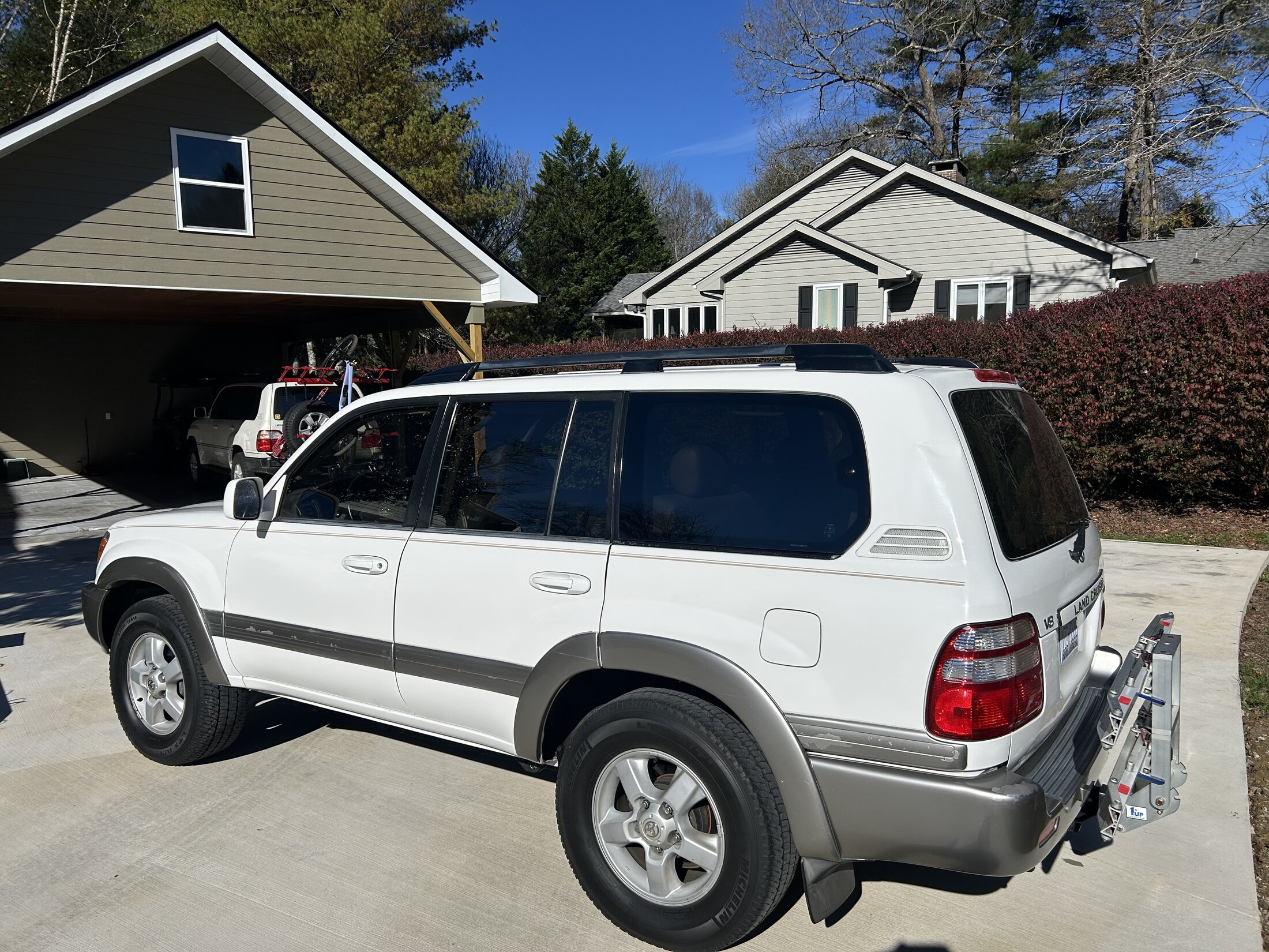

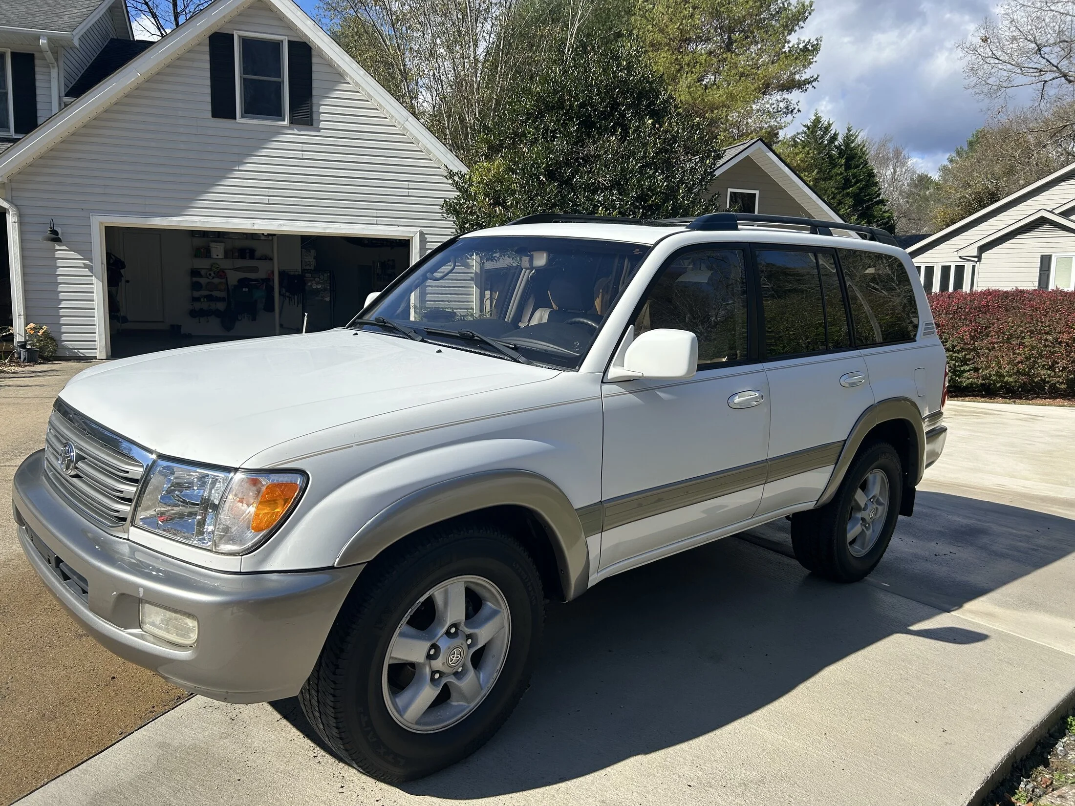

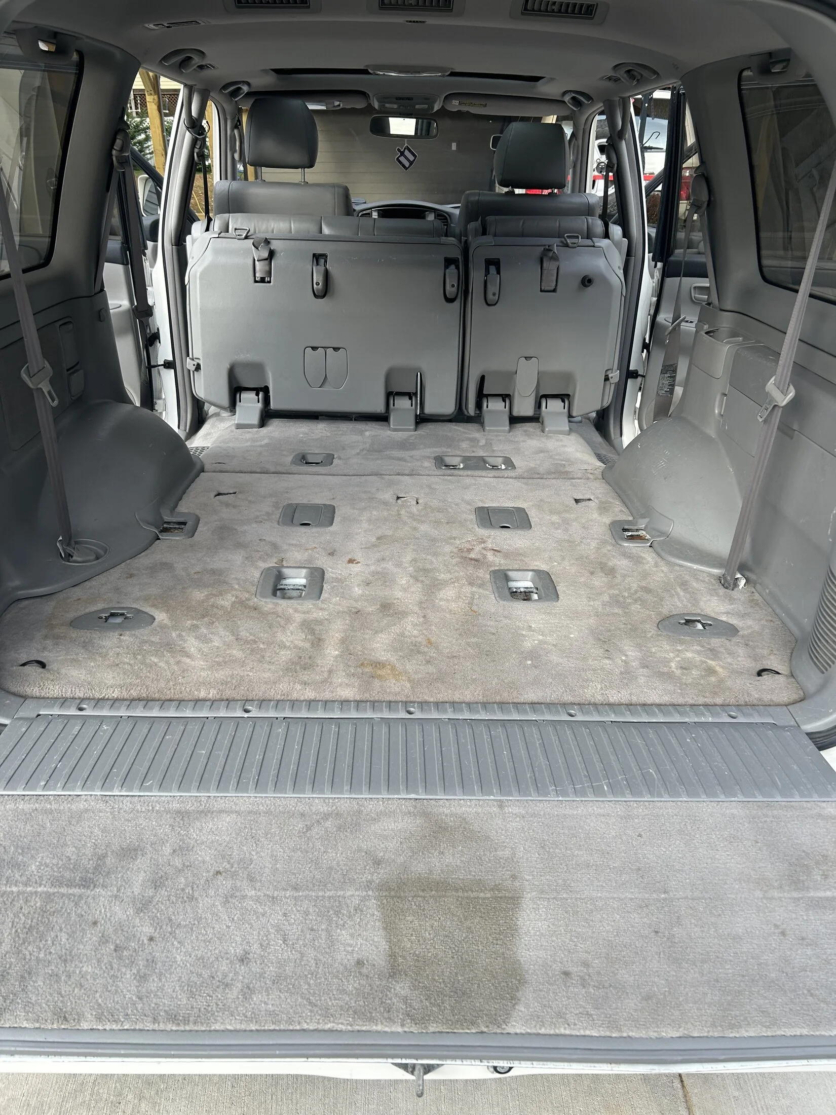

I added a few after pics of the outside & inside.
Strange how some cruisers have a middle support under the rack and some don't. My neighbor has a white 1998 and his rack has a center support. Mine is an 2001 and does not and never did. Yours is 2003 and does.
