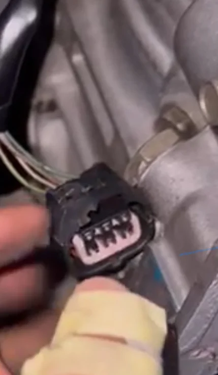

Hi,
My mechanic was saying the pic pasted which is connection to transmission is broken, is this something causing issue. He had checked all connections with multimeter and everything is working as per him, the only thing was connector which is broken which connects to ecm. Can I get the part number for the broken connector

Hi,

The last five digits of the part number are on the rear of the connector housing. The first five digits are 90980-
Take a photo of the connector showing the number (mentioned by Malleus) and post it up
