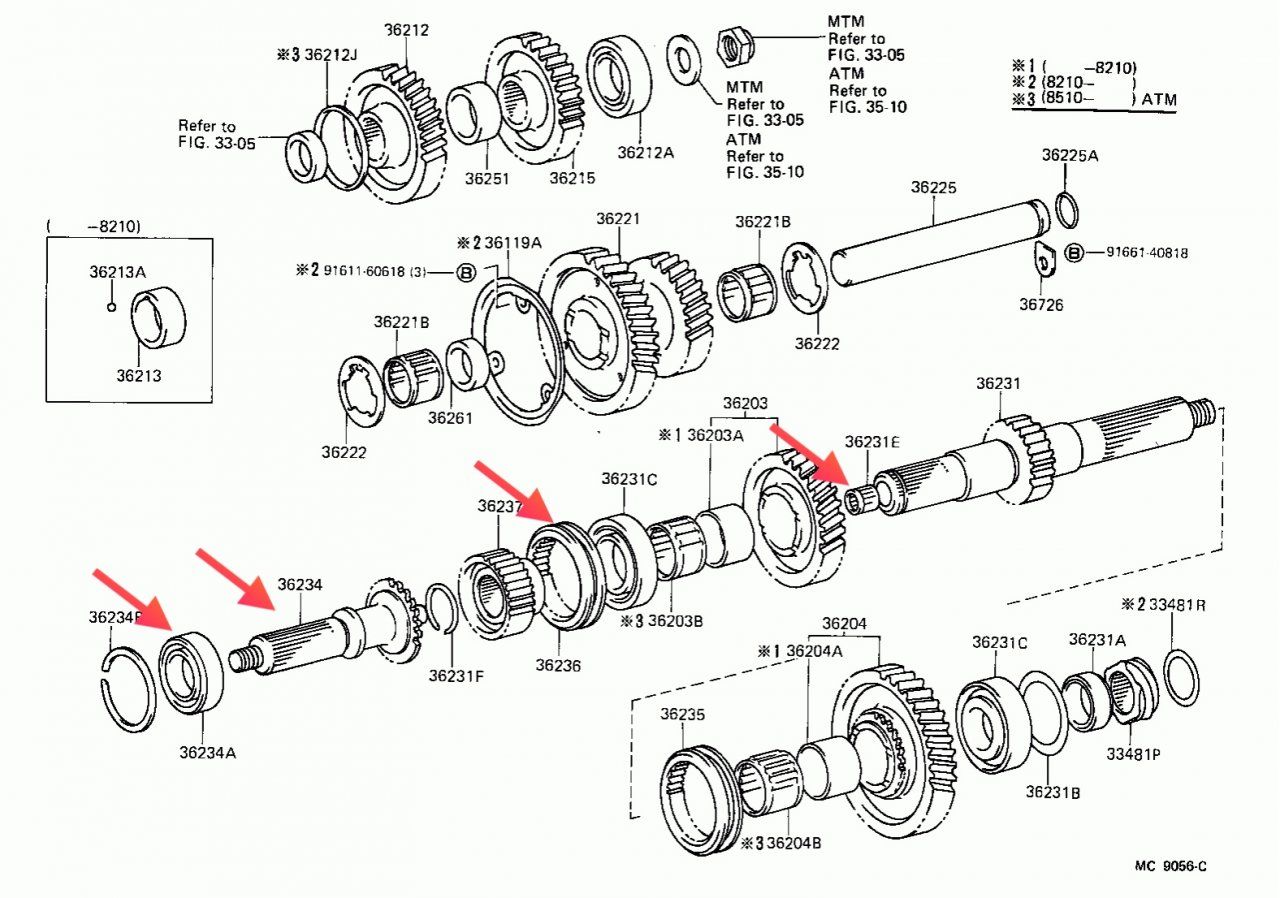

A loose traction surface which allows the front wheels while in 4WD to grab & slip & grab & slip, causing the transmission to shudder forward & back, can cause the transfer to jump out of 4WD.
Check that the transfer shift boot is not pushing on the transfer shift lever.
Check the actuation of transfer shifting while under the truck. Make sure it clicks firmly in place.
If those are fine, then the 4WD clutch sleeve teeth and front output shaft teeth may be worn... allowing them to jump out of engagement when under tension. If you replace those parts and their bearings it will stay locked.
There's nothing "wrong" with lashing the transfer lever while in 4WD with a strap to keep it in 4wd. It's just a hassle.
If the transmission or motor mounts are broken, the engine will move under load , pushing the shifter against the floor pan.
