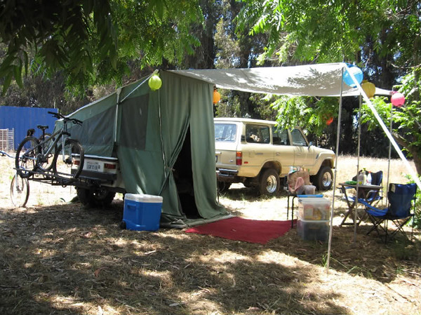

Aha! The too much is just enough mentality. I don't have time for much more than very nice, but not excessive. This is us "glamping" it in Joaquin Suave's front yard:

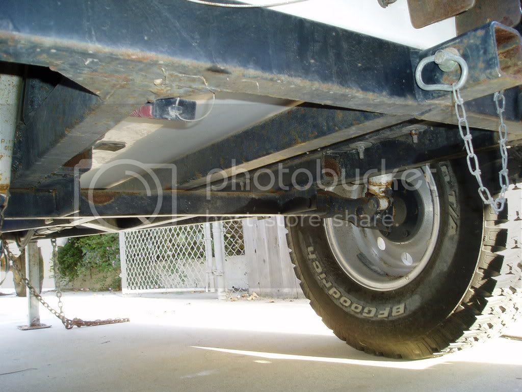

That trailer came to me independent, Dexter Torflex axle, but has had dampers added. Which is why I don't see the need for independent, experience with it compared to the leaf sprung utility trailer below. If we used the camp trailer more than we do I'd probably change it over to a 3 link (like the bottom-most pic) with brakes that have the parking brake option, but that's hard to justify for the little use that it sees.
