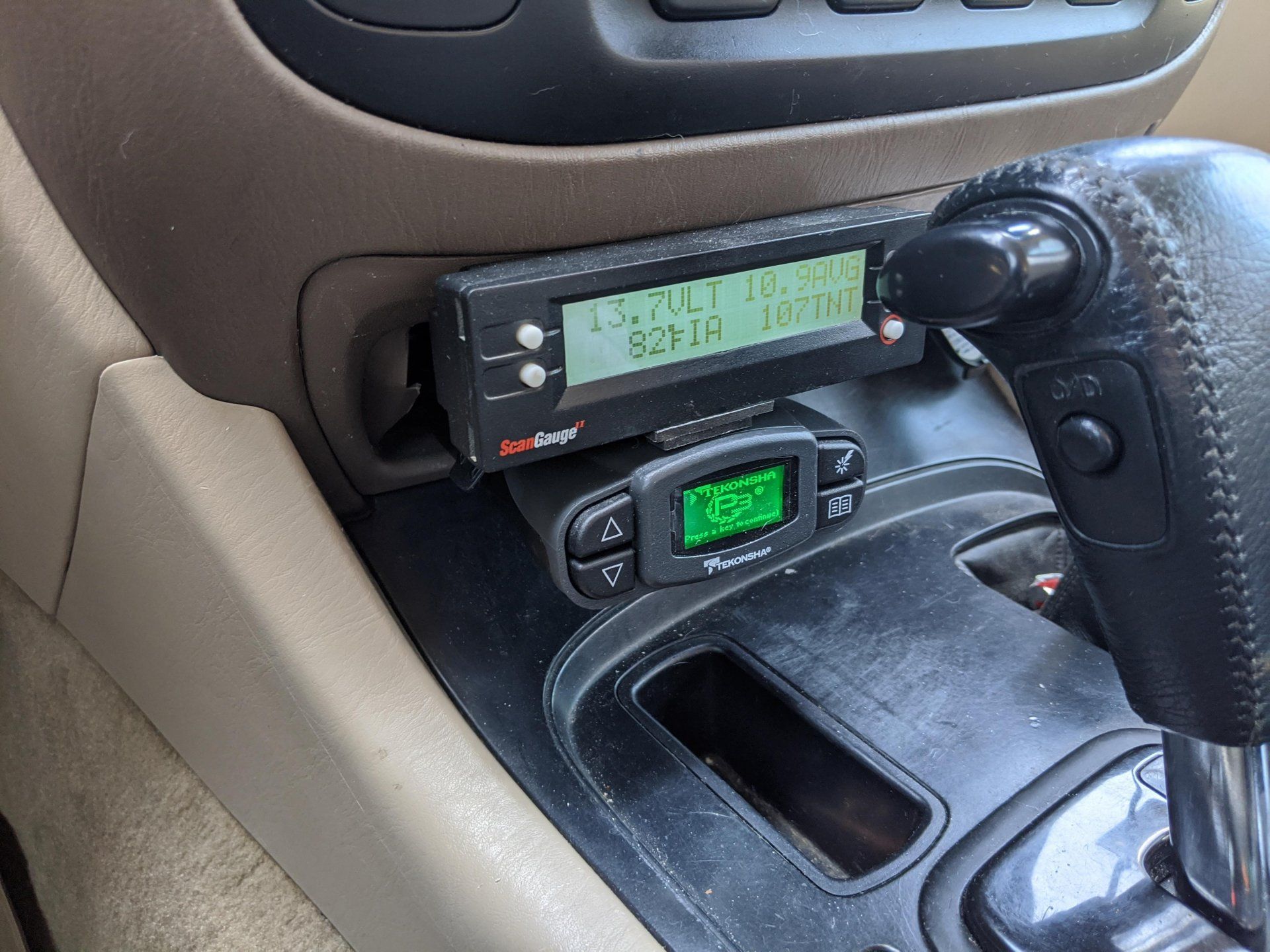

I have it and a scanguage mounted in the ashtray are, works great. I also have a used P3 I bought off a member here if anyone is interested.

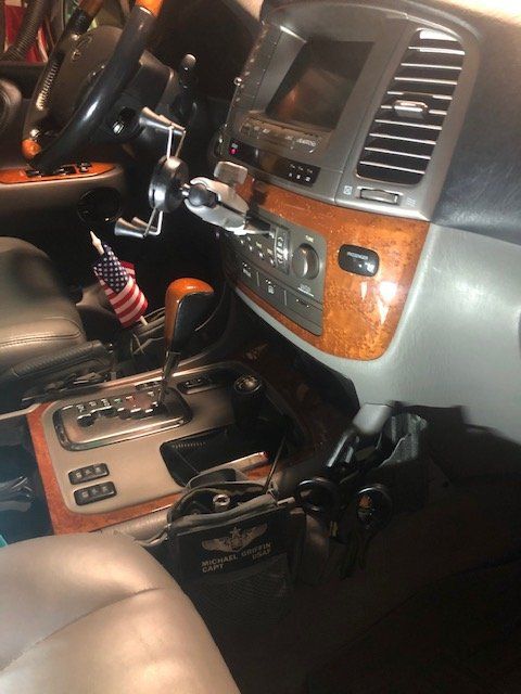

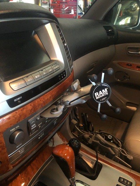

I installed your Media Mount just for my i8...and this function. It's in the perfect position for the manual brake button for my 100 series. I think I may add another 1" ball for underneath your MM for another X-mount too. The feature I look most forward to playing with on the Echo is the different brake sensitivity settings. They can be placed into 1 of 5 memory presets. My HH Lite / Medium / Heavy loads all require specific setting that I had to adjust prior to each different trip. Nothing tips off the on-looker of a rookie quicker than skidding trailer tires because the light trailer is set for a heavy load right?
I Love Your Media Mount...
I added some hammered metal finish to it and the RAM stuff to soften the look...
I could probably go a little darker in the shade but it is an awesome use of waisted space the cassette tape player took up...:cheers:
