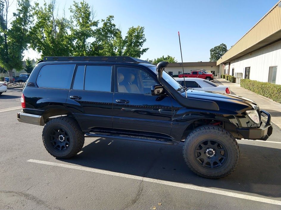

Are there any pictures of your roof rack installed on a 100?

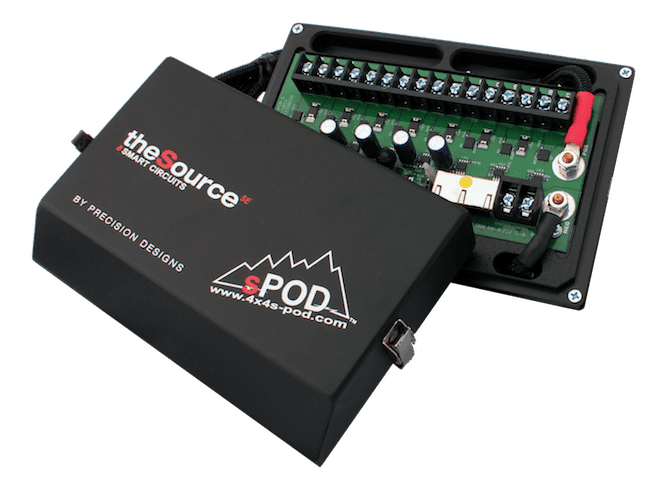

@TRAIL TAILOR Are there still plans to offer a fender mounted version of the fuse/bussman panels for the late models? I am looking for the Bussman for an '06 LC.
I’d also be interested in a fender mount similar to the picture below.
I think 06/07 models should have enough room to fit a tray in this location since the charcoal canister was relocated to the spare tire area.
