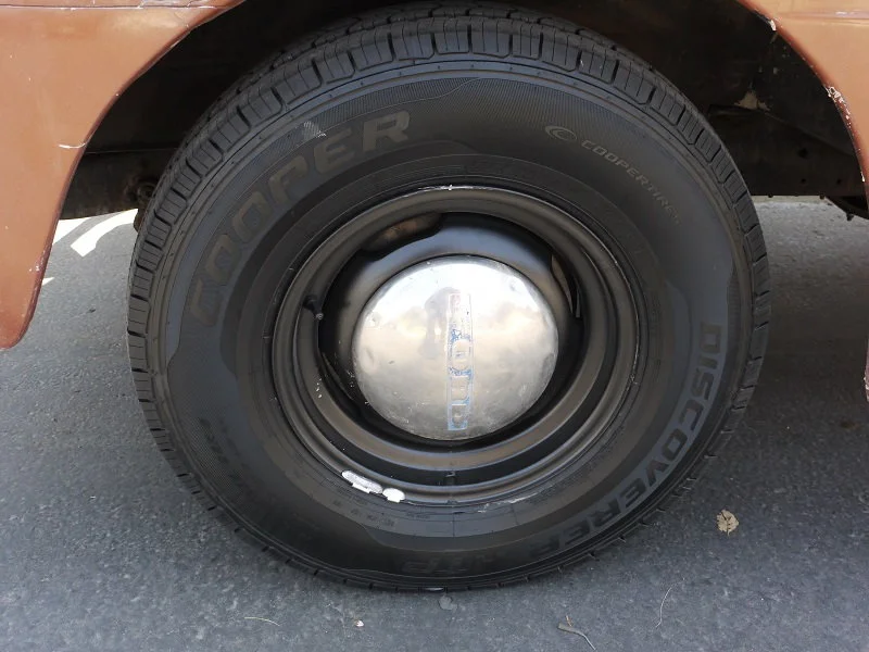

I have 1948 rims on my antique Ford pickup that originally had 6.00-16 tube type tires. One shop said I had to run tube type tires. But many people run radials so I checked around and other shops said no problem. I'm been running 235/85R-16 radials for years now. One of the rims I had for the spare was split rim but I found another non split rim so I sold the split rim.

I put in a 1972 Dana 60 rear and I can use more modern Ford 8 lug rims. I went with the 1948 Ford F2 rims so they were at least period correct and I could keep my hub caps.
