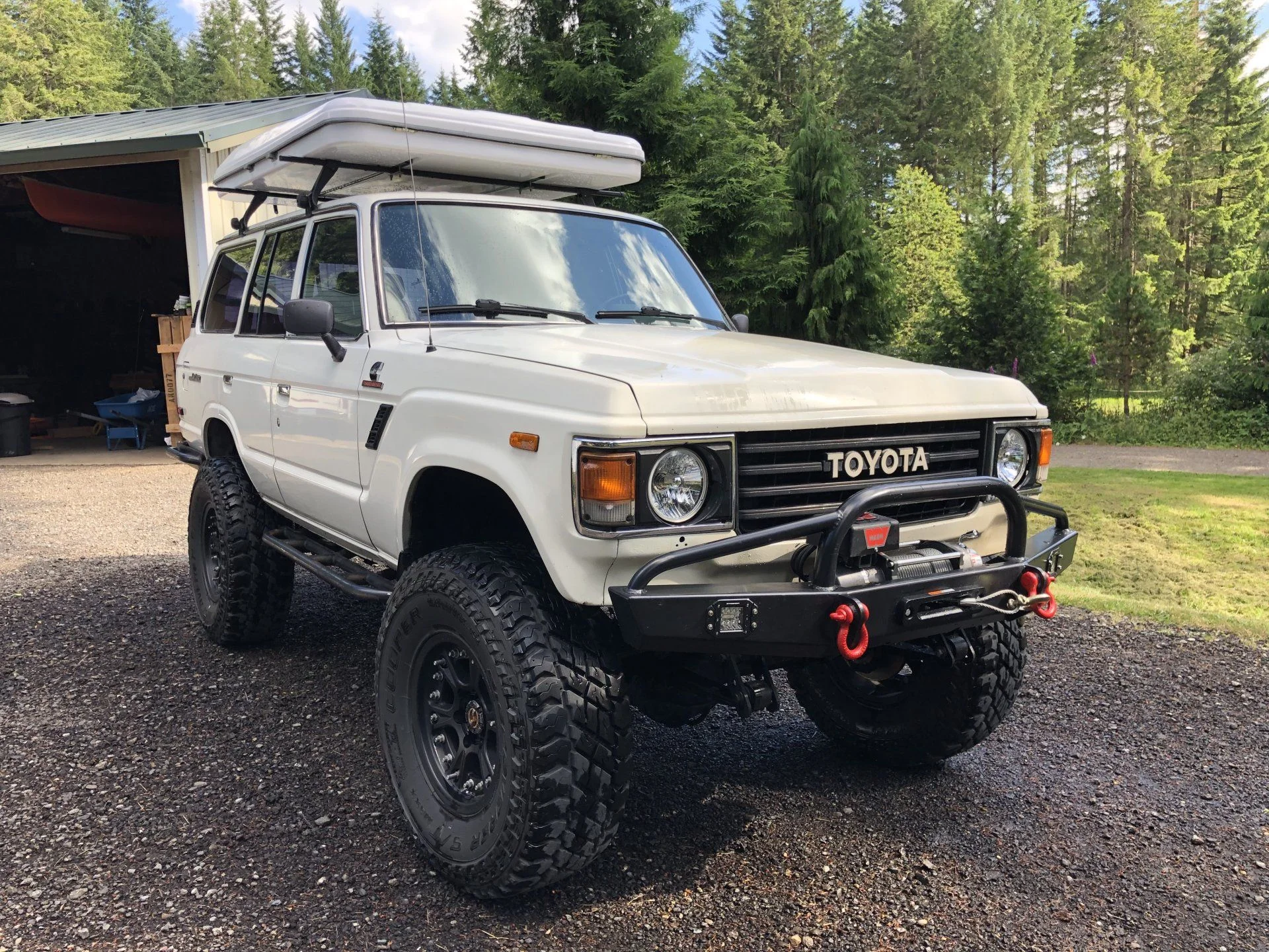

Wow!...beautiful yota brother! I absolutely love your setup! What made you go with the bags in the rear suspension? Also little info on this beauty? You make the bumpers etc? Sounds amazing btw🙌🏻
I just put in one airbag last weekend as my rear tire carrier has my spare on drivers side and had a 2” sag. Leveled it right out. I’m going to put one on the passenger but need to reroute the exhaust and haven’t had time yet.
Front bumper is a 4plus and rear is custom made.
