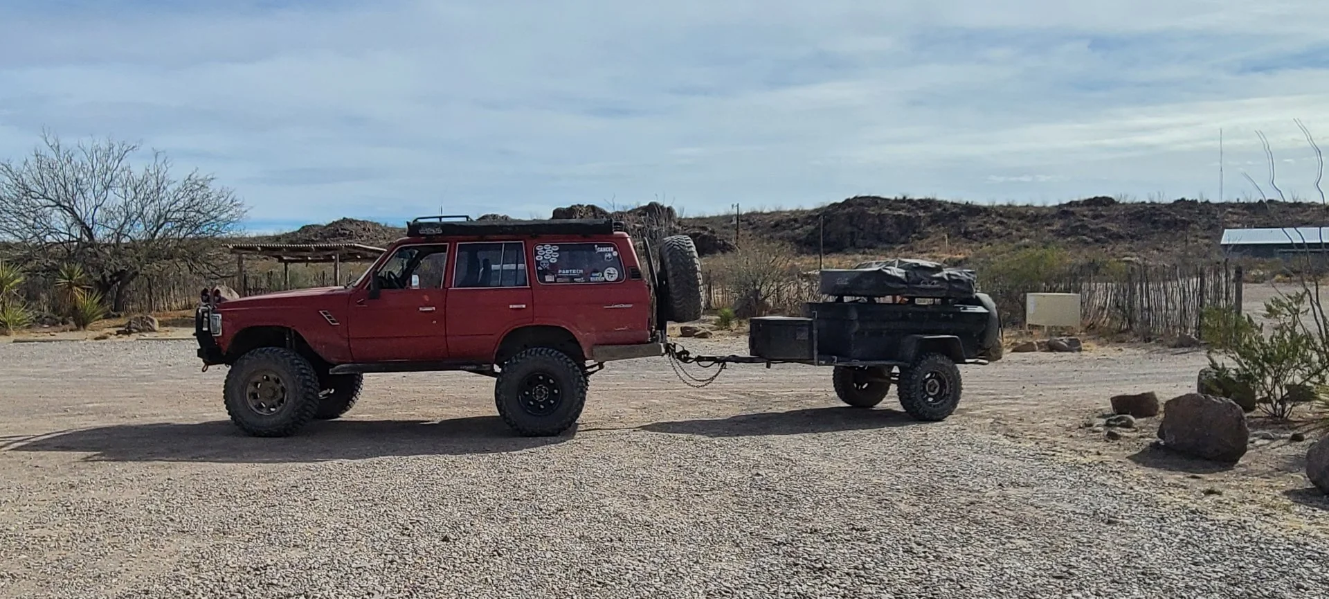

I have a 4bt in mine with compound turbos. I was happy with it when it was just one turbo, but me being me, I wanted more, it can produce 60psi when I gun it. There's no rattle, it's a well-balanced 4BTAA with an inline pump. I initially thought of the 6bt but heard it would be too heavy for the axles. The setup I have now is great, it crawls everywhere and the 4BT left enough room in the engine bay for extra stuff like two turbos, two batteries, a remote oil filter, and an air box. It can cruise easily on the highway at 80mph and was able to tow a loaded trailer at 103mph. I think I could have gone faster, but I ran out of road.

I have a picture of it somewhere on my thread.
Now it’s a lot but I think this is the new goal

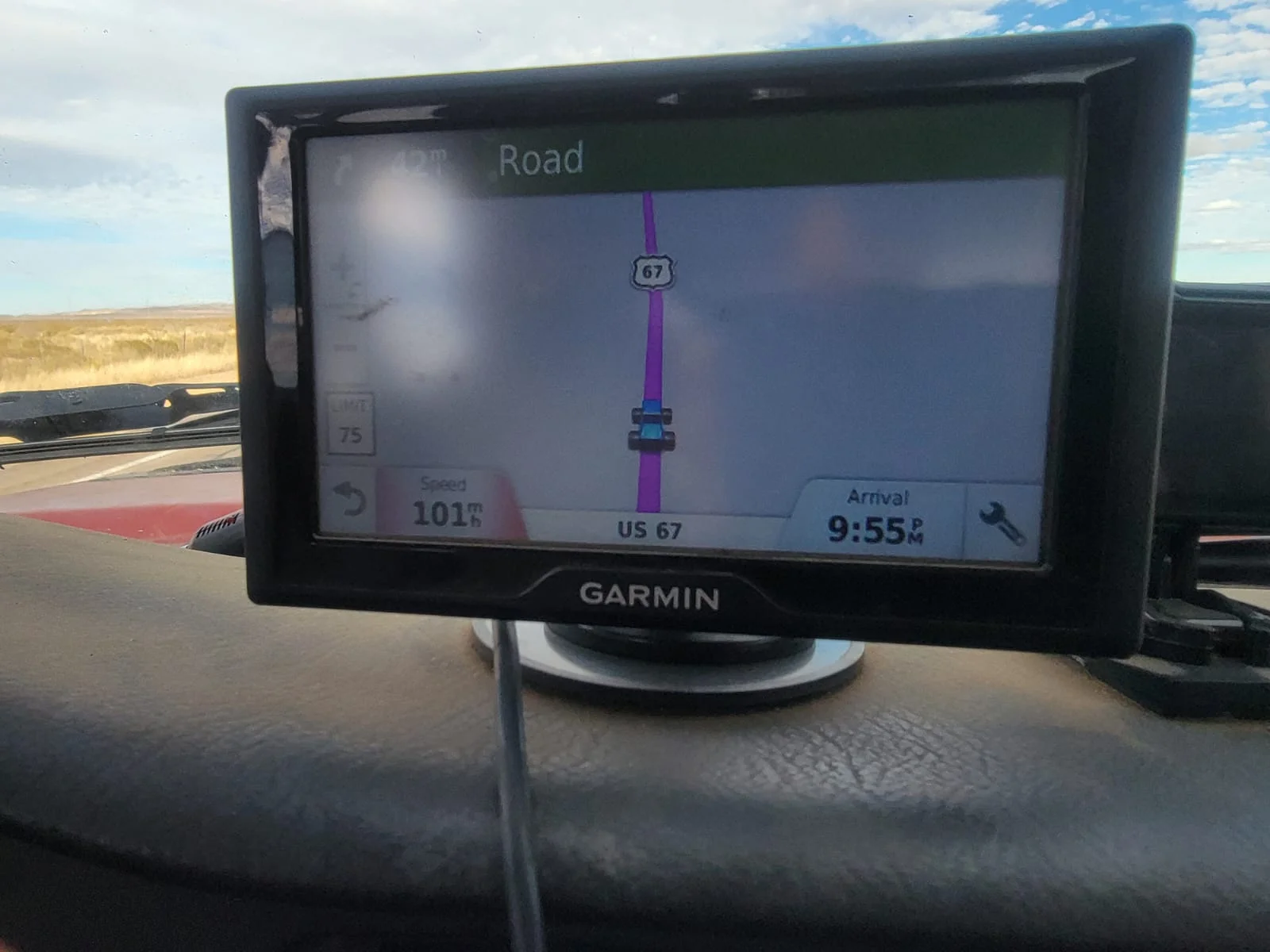

This is from that trip I was referring to. I couldn't find the pic that shows 103 mph, but I have the one that shows 101mph. I have the video of it somewhere. It was sustained boost for about 40psi with a max at 60.

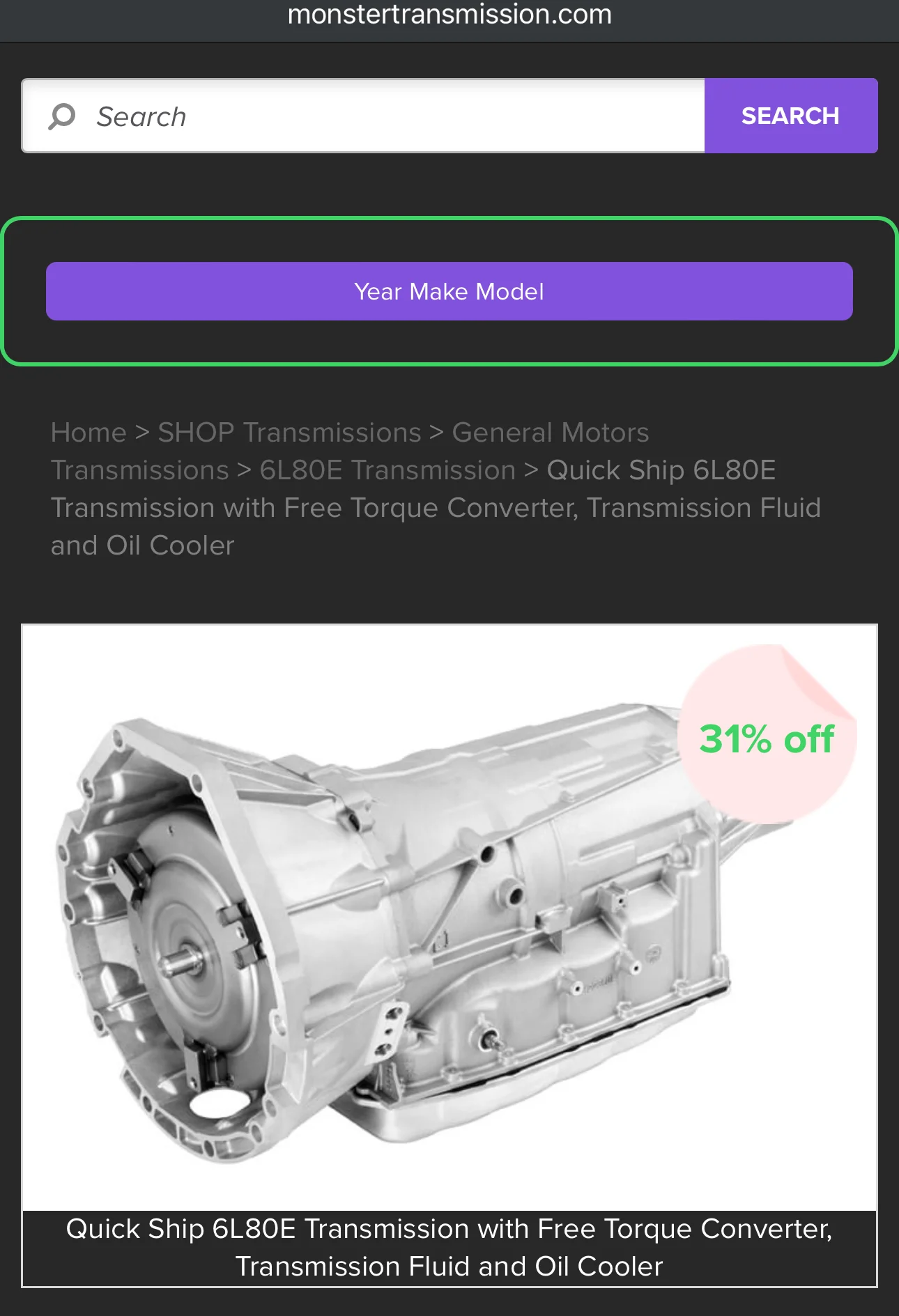

don't forget you may need a separate trans controller for the 6L80 and similar newish transmissions if you're using a non-LS motor and ECU— this is about $1k

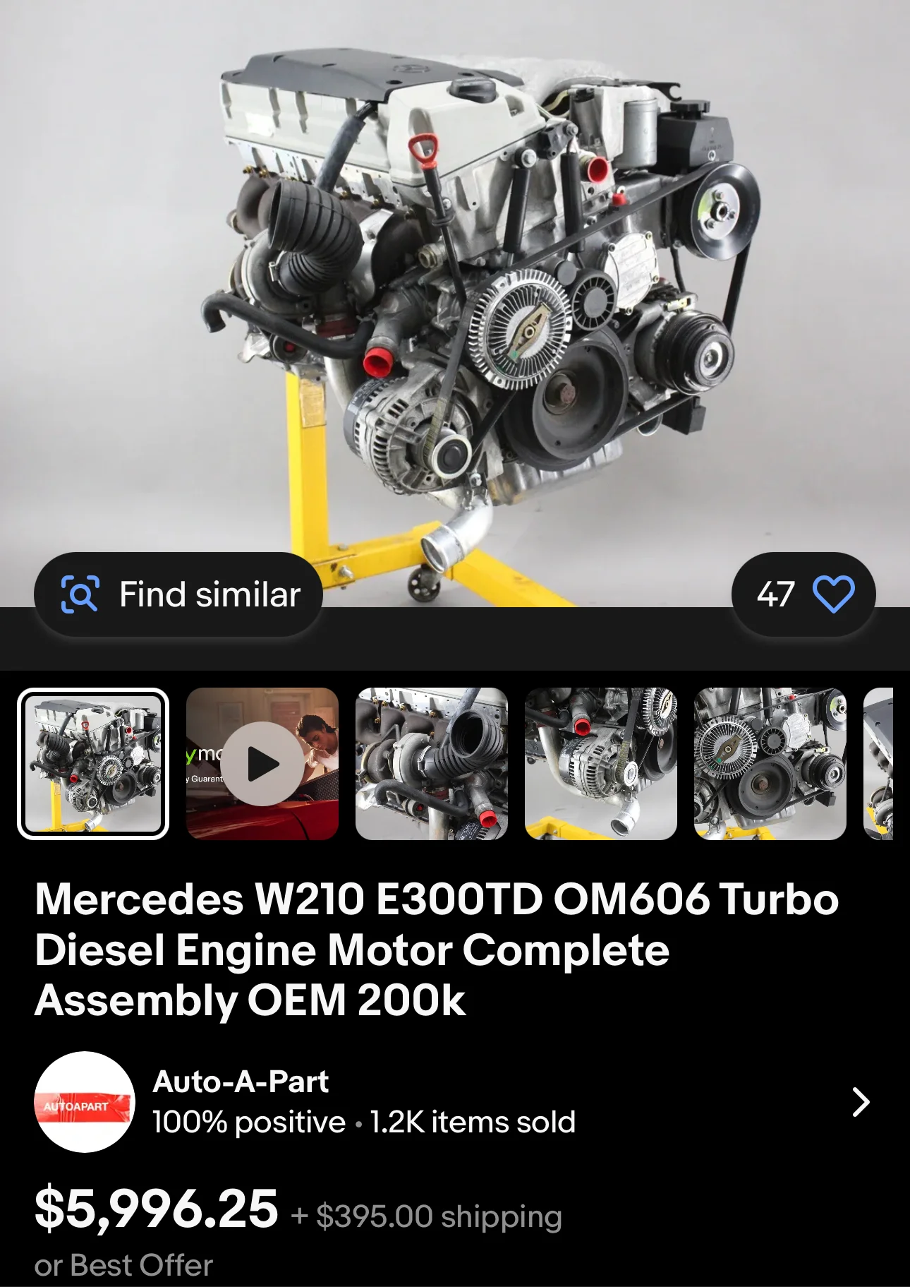

That is true for the Mercedes 722.6 as well, you would need a TCU to control the transmission.
Depending on what kind of injection pump you run on the Om606, you have a few options to control the transmission with an OEM TCU or a stand alone unit.
In any case, if your TCU gets damaged ( OEM or any aftermarket unit ) your 722.6 transmission will still have first and reverse gears so you can still drive your rig.
