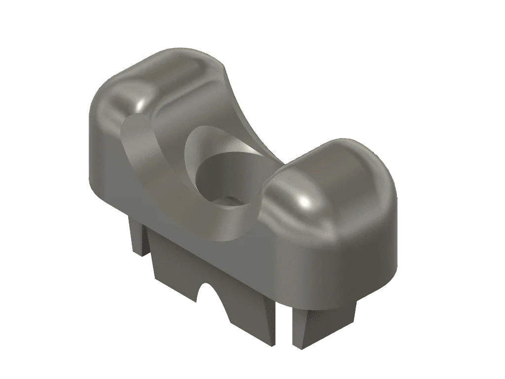

While I was there I also noticed the door knob guard was missing, so I took one of them with me to reverse engineer for 3D printing.

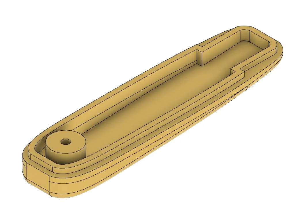

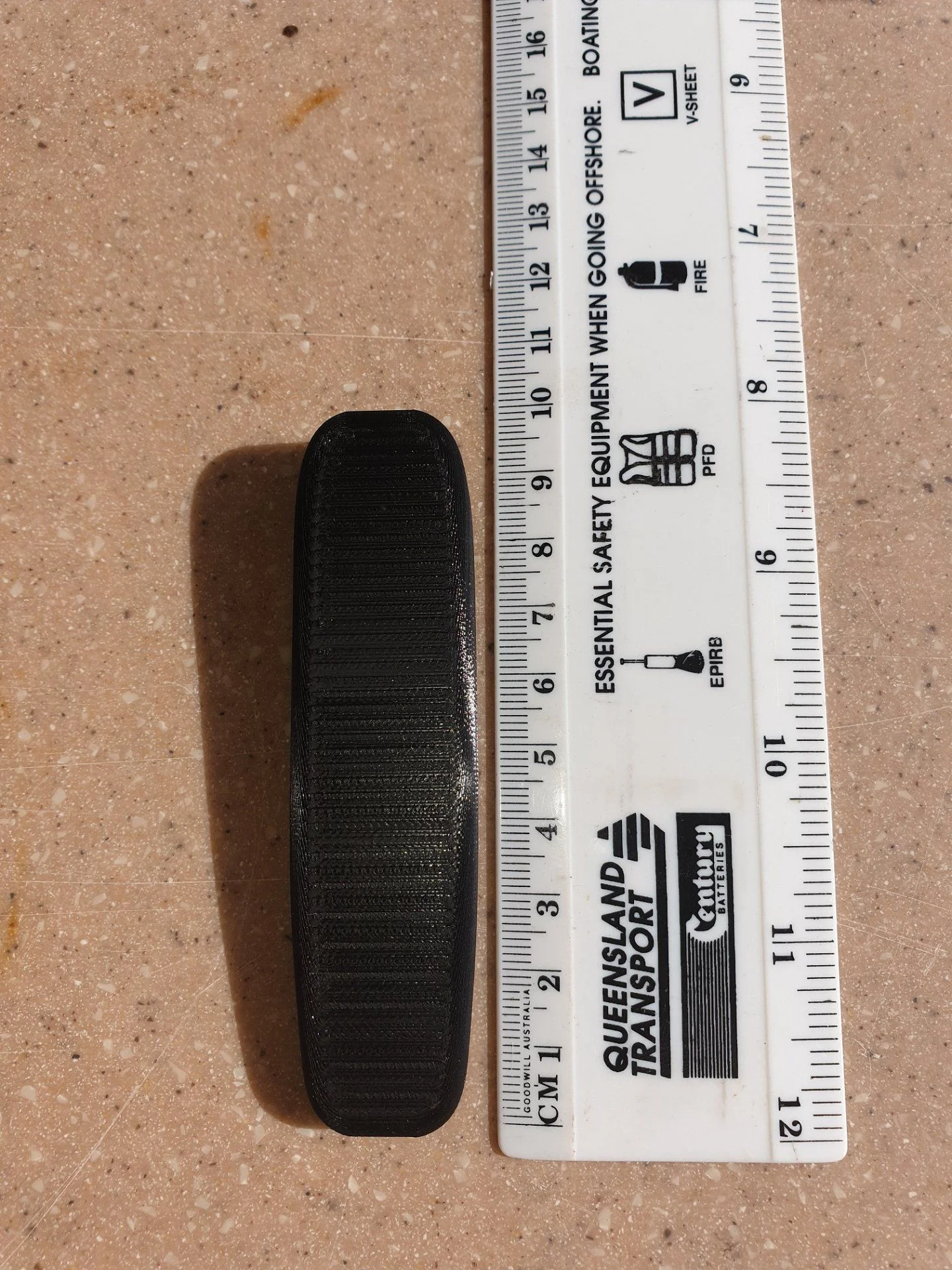

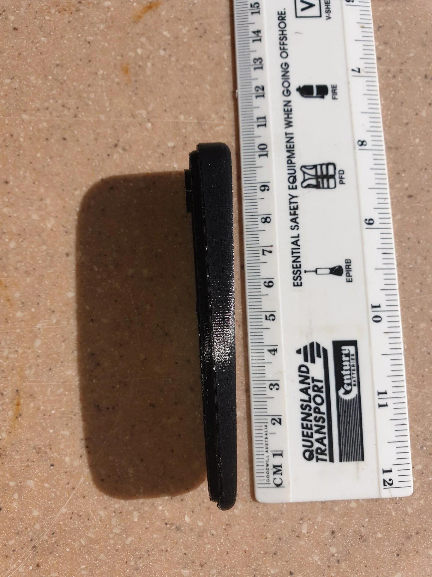

When I got home I modelled both parts and printed them in Jet Black PETG.

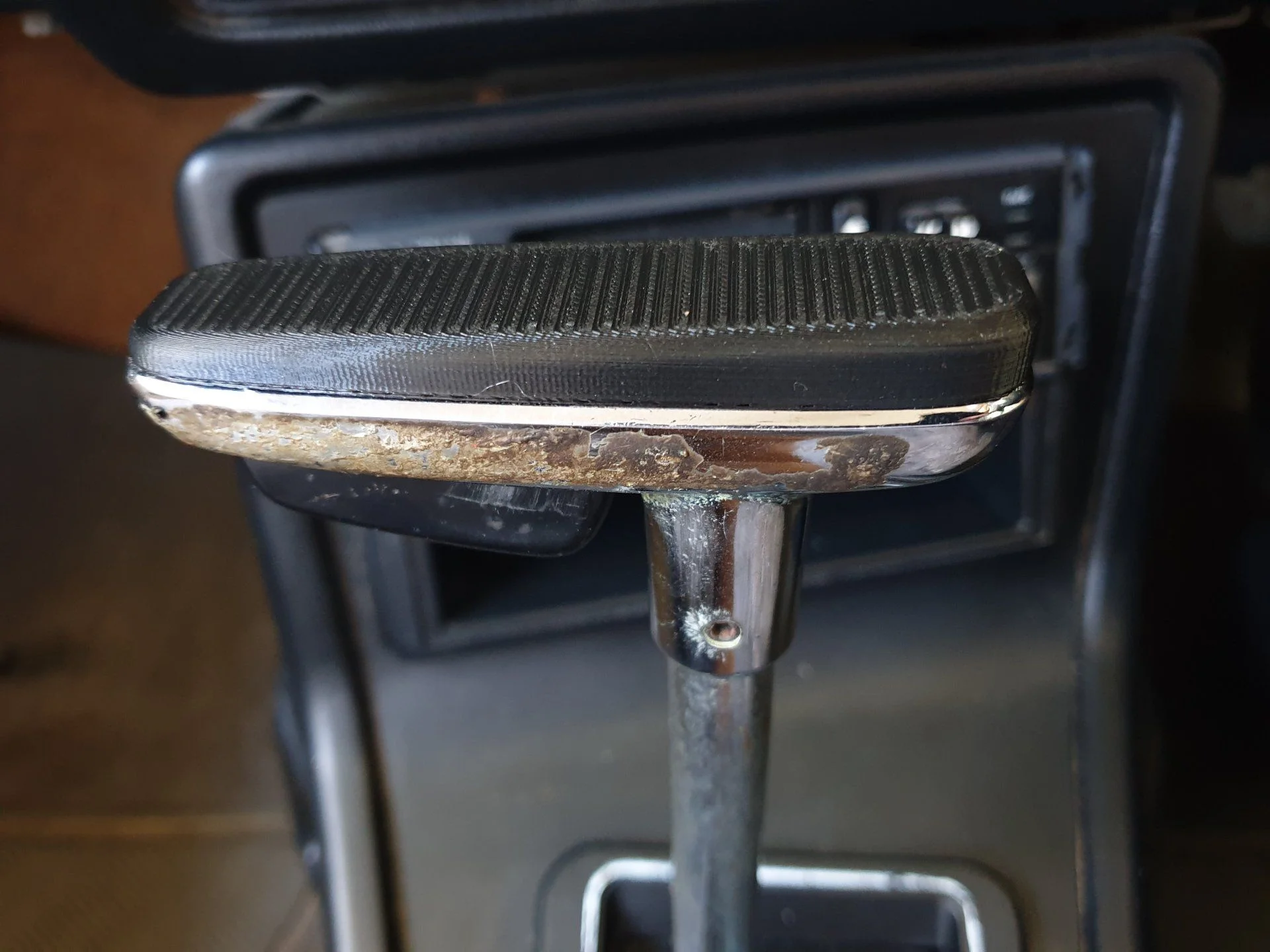

I send them both to Mum via post. Now the door knob guide fitted perfectly, but the gear s*** cover needed some work.
I coached my sister through heading the part in hot water and pressing it to fit, then photographing and measuring the required changes.
Another print and post, and we had a perfectly fitting custom part, correction parts.
Photo's here FYI.
Modell views.
Shifter Cover before and after installing. I don't have space for the guard in this post.
