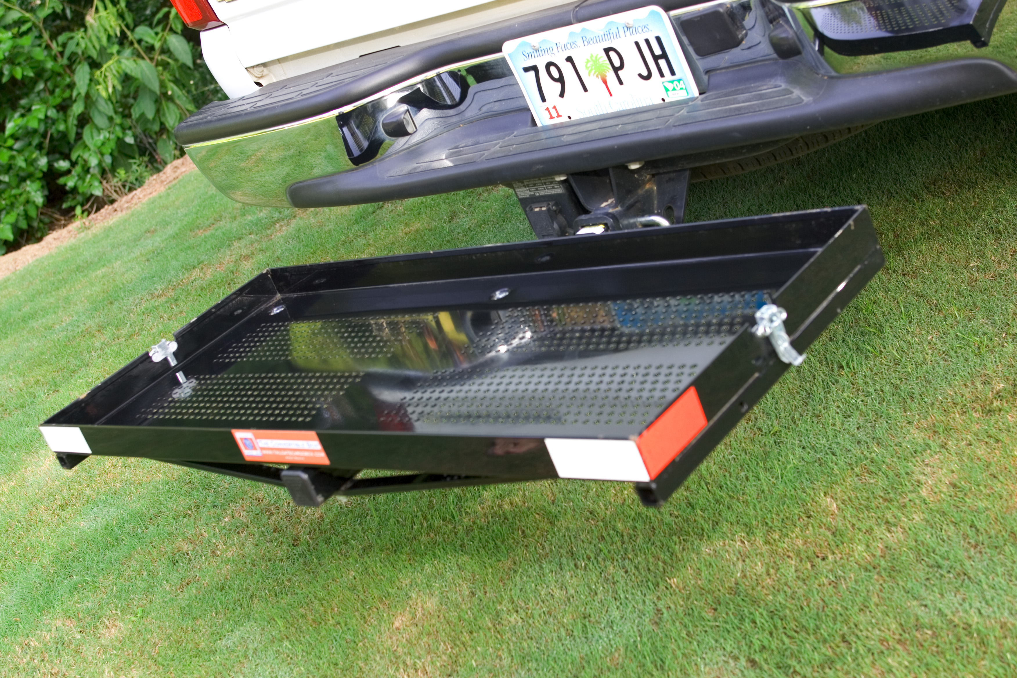

But there's no way I'd bring dirty/muddy/yucky stuff into the cabin area, let alone bloody carcasses. I would think external options might fit the bill better. Something like this for hunting/serious fishing -

Looks like that would block the cargo area access.
I have a smaller one, it's unobtrusive when it's not loaded. But yeah, if anything is on it, makes getting in the hatch tough. I mainly use mine to carry a big cooler when we hunt, or if we are really short on space for a trip.
