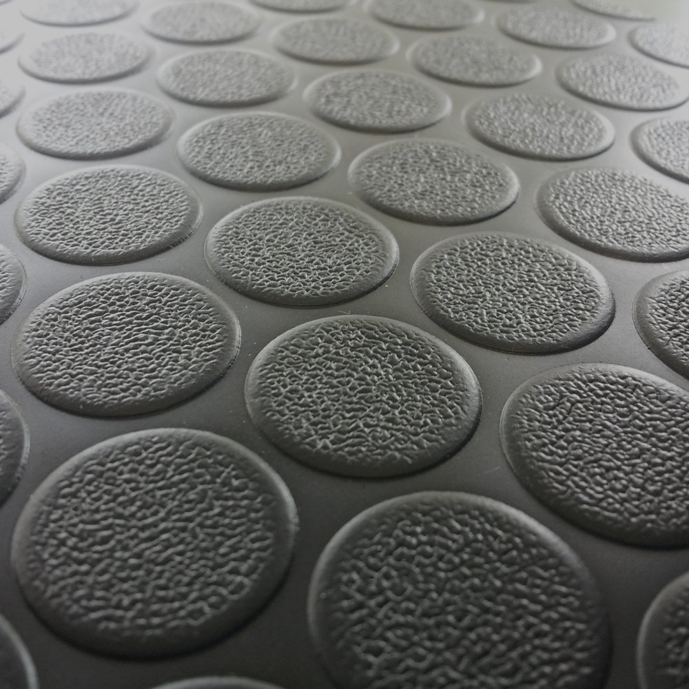

That material posted by tripreed looks really good. I like it a lot. I just might try that.

Wow! That Rubber Cal Coin-Grip Flooring looks like it may fit the bill.
Wasn't a fan of HDPE if only because the tail gate in the LC gets used for so many things. But this stuff looks like it may work for a variety of needs.

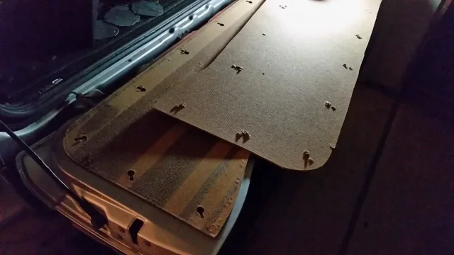

Last week, I began replacing my tailgate carpet as well. It smells and is ugly. It being gone is an improvement. I ripped it out and dynamatted the tailgate. What was interesting was that the tailgate carpet is simply a patterned fiber board with a stitched carpet. It's lame, would be easy to replace in nicer fashion. I found a product called ''Eucaboard' that is similar to what is stock(yep, Lowe's), and I used the stock board as a pattern to cut a new piece. You'll need a drill to cut the holes and a jigsaw to handle the shape. Cuts very nicely. Once I cut it, I realized it would be straightforward to reinstall the tailgate piece with the previous red snap in pieces.

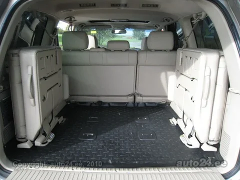

However, the central problem is the tailgate carpet(and underboard) absorbs fluid. I'm in a bit of indecision regarding what surface to use on the tailgate. It would be better if there was a waterproof surface that was still soft and waterproof. It would be difficult to beat a foam/rubber truck rug product. So I'm reaching out to some auto upholstery folks for their opinion, but would like to end up with something like the latter two photos. Not finished yet of course, but I nearly have a Master's in auto upholstery at this point, thanks to hogring.com
