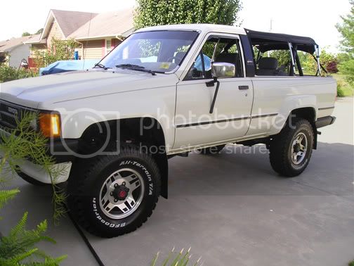

I'm new here, but this is my 88 with 1 1/2 BJ spacers and larger torsion bars cranked a little. About 2 1/2" of lift.
