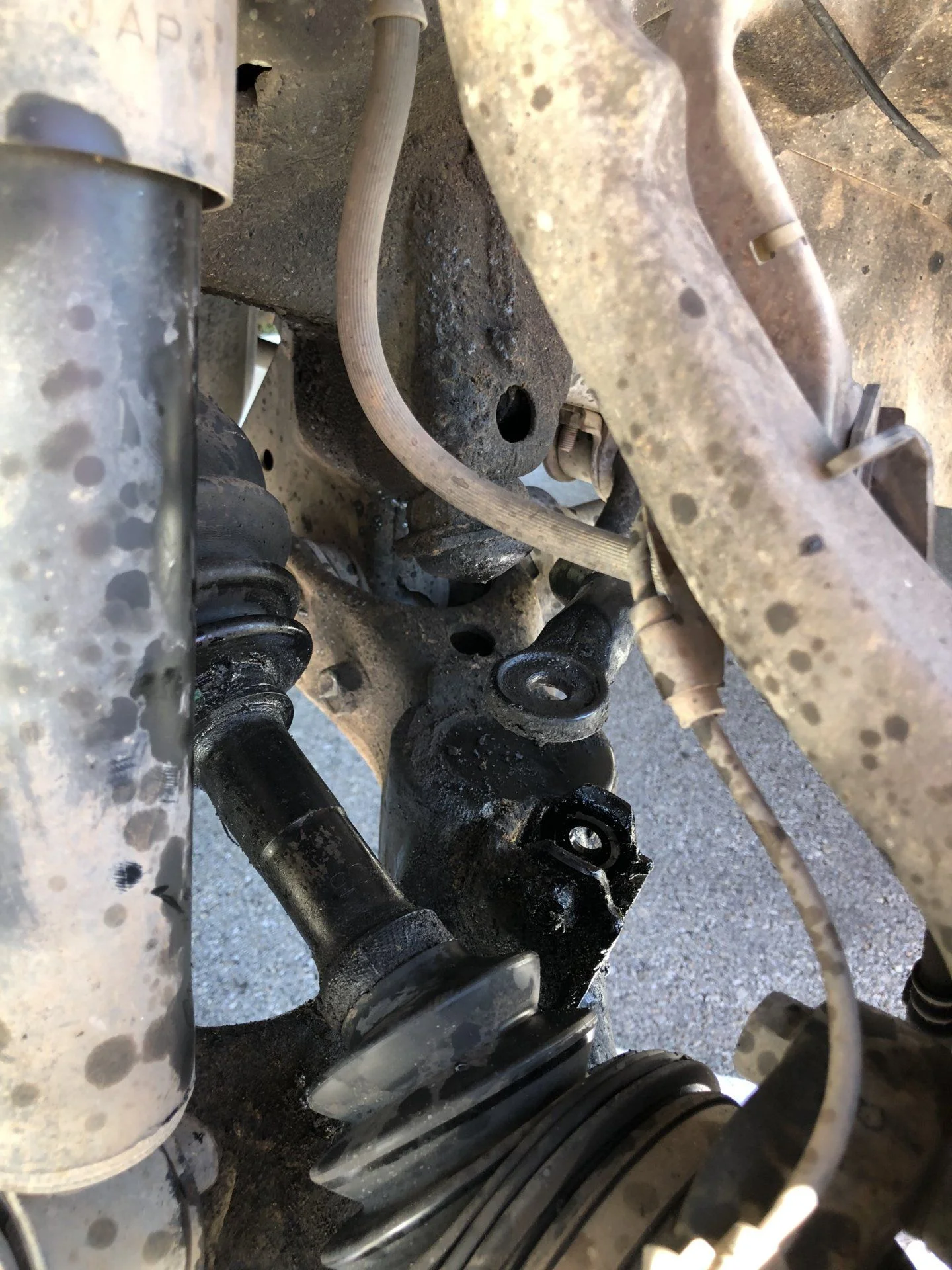

Ah, ok. Mine is shuddering a little when I turn and accelerate. Mine have slung out a ton of grease. Definitely not the differentials or driveshafts (LC Specialists confirmed). Said it was the CVs. Concerned I might be damaging something bad. Going to park my LX until I can have someone look at it.
Photo was after I pulled the stabilizer bar links and before I put in the new ones. I had cleaned the CV with brake cleaner and a brass brush. There was TONS of grease all over it.
