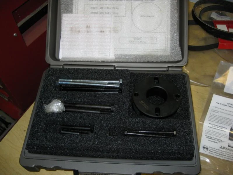

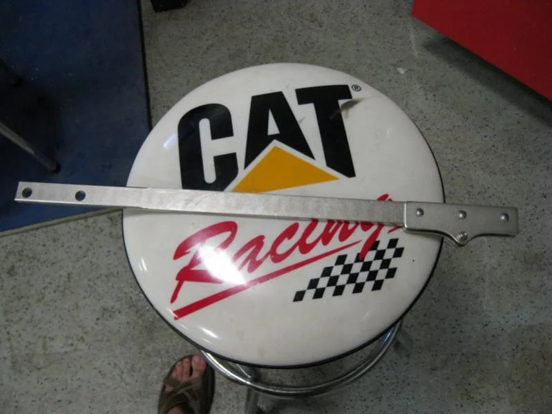

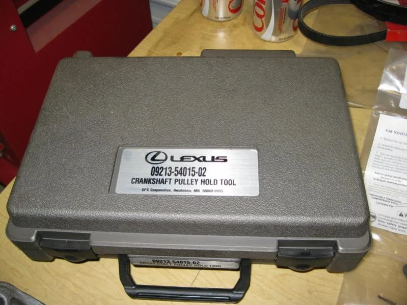

Anyone have one of these or a simular impliment for holding the crank for pully removal and installation?

What's your timeline look like Rob? I am doing a timing belt on the 4runner in the next few weeks (still nailing down the date), and will have the toyota part equivelent tool on loan for a day...maybe we can do em together?
Take the old belt (you're going to replace it...right?) and cut it to fit around the pully. Then take a chain wrench and wrap the it around the pully...that will capture the pully and give you the leverage to hold it while removing the bolt. BTW...That bolt on the 2nd gen 4Runner I did was 250lb's or something crazy like that. I had to stand on the damn thing to get it off. The chain wrench at snap on is ~$40, I'm sure you can find it cheaper.
The cheaper option is Kevin's tool...i'm sure it works too...
