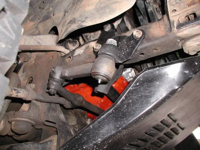

I had the relay rod, that was under recall replaced and while they were in there i asked them to find what was causing a popping sound..
Well the guys started snooping around and found the sway bar linkage on the drivers side was broke in two pieces causing rubbing at certain angles. He also discovered that my Idler arm on the passenger side was a little bit loose for his liking and showed me the movement in the arm....
Now i have to replace the Idler arm and the linkages....i might just do a write up....

Call around for the bushings, you should be able to find them pretty cheap and save the $$$ on the entire arm.
so i can use the old idler arm and just replace the bushings? The guy at toyota said i would need a new arm,.,hmm

Screw the factory arm. Its weak and bends easily. Autzone sells a beefier unit for about what the dealer will rape you for the bushings. It is twice the diameter at the pivot and the arm. It is greasable as well.
Grim, no offense but that arm is the biggest POS. If anything get a stock arm, replace the bushings and get a gusset. I went through 2 of those crap arms, they allow for upward/downward travel which is NOT what you want, the arm should only move left and right.

I never removed the tie rod. Just remove the metal cap, the nut under the cap, then the bolts holding it to the frame. Pull the bracket housing off of the arm, install new bushings with plenty of grease and reassemble.

I have seen three bent factory Idlers on three different stock trucks. The shaft is thin and they bend right where the go into the bushings. I can even tell you how it happens. Extend the suspension on passengerside, wedge the wheel while turing right. Good chace ytou will bend it about guranteed if you have a suspension lift.
Even if this is junk It has a lifetime warranty that the factory unit doesn't. I'll stick with my $59 unit and get new for free as needed. Its been on nearly a year and 2-3 trail rides so far so good. I Check it and give it a shot of grease every oil change or after every trail ride. So far no play.
