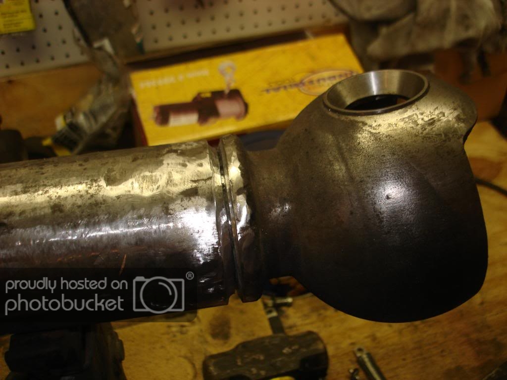

Tom, use a very bright light and look carefully, it is just a hair line crack and not easy to see in poor light.
Take your time and keep nipping away at it, once you've found it it's easy to follow around.
Jr.
I was going to try to force it with a breaker bar or long pipe, definitely cut past 1/4", should I cut more?
i think 1/4 inch should be enough and u should see the line, if not try to turn it with a long pipe.

Yup I just had to look closer, I bolted it in the truck aligned it, then used a breaker bar and a hammer with an angle gauge, worked beautifully, I tend to over think things too much, it really was easy
