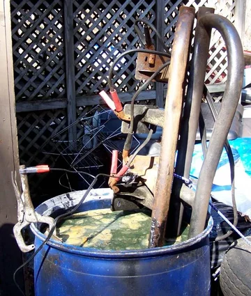

My juice barrel holds about 60 gallons of my special clear juice, but it isn't tall enough to totally immerse a rail. The next step was to hook up the battery charger. I dropped one rail in and hooked the negative clamp to the rail. I added one of St Pam's brownie pans (I'm too fat anyway) to the barrel and hooked up the positive.
Initially I went with 50 amps, but cut it back to 10 after about an hour. You can see the water clouding up a bit as the chemical reaction is starting, that isn't a camera reflection. There's plenty of chemical reaction going on now as I'm writing this and I should have more pix after another day or so. If this works like I think it should,
I may have to buy a pool to be able to do a frame, or maybe a whole vehicle at once :grinpimp:
MMMMM - soup. This stuff looks like an EPA supersite, but it is really just some floating rust colored goo. Nothing harmful in here.

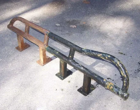

This is the first look at the rail before rinsing. It still has some residue on it that will be hosed off. Rinsing and brushing with a broom gets it down to your basic black.
Looking better after being hosed off.
I gave the rail a quick pass with a handheld wire brush and then tried some light sanding with 100 grit. (My finger is too sore and swollen from yesterday's fiasco to tempt fate with the angle grinder, I think it may also have a mild sprain.) You can see that the blackness is being replaced by some shiny steel color where I did the brushing and sanding. I'm optimistic that it will clean up nicely once the dipping process is complete.
I flipped the rail over to do the other end and decided I'd get the second rail going. I connected the 2 rails together with a set of jumper cables. I hooked the charger up again and set it on 50 amp to get the reaction started quicker. I'll drop it down to 10 in an hour or so and let it simmer until this evening. It needs to go about 12 hours or so to be effective, so I will probably leave it in overnight at 2 amp to finish it up.
