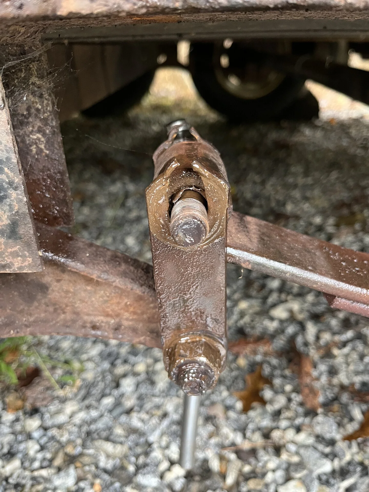

Fixing trailer before FG.

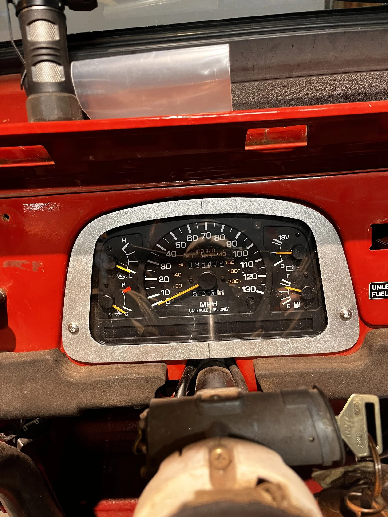

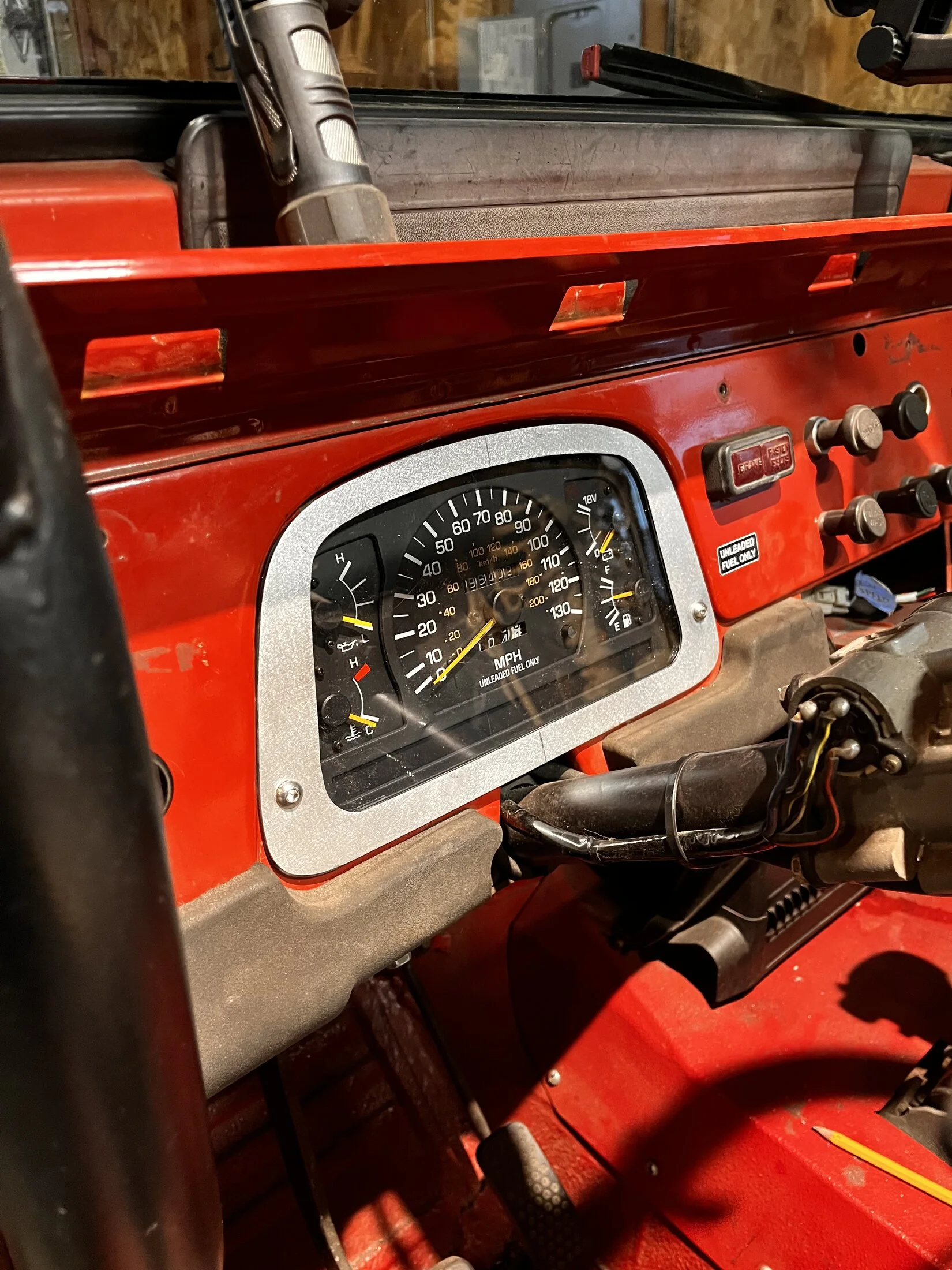

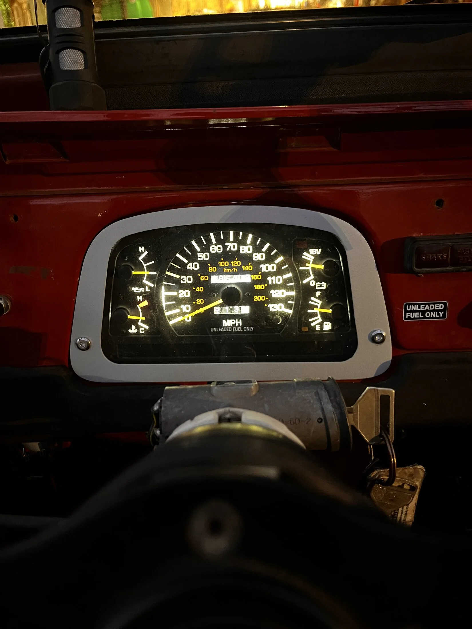

Everything works, speedometer and all gauges, had to splice through some wires for temp gauge to work but its all set, even got the lights to work.

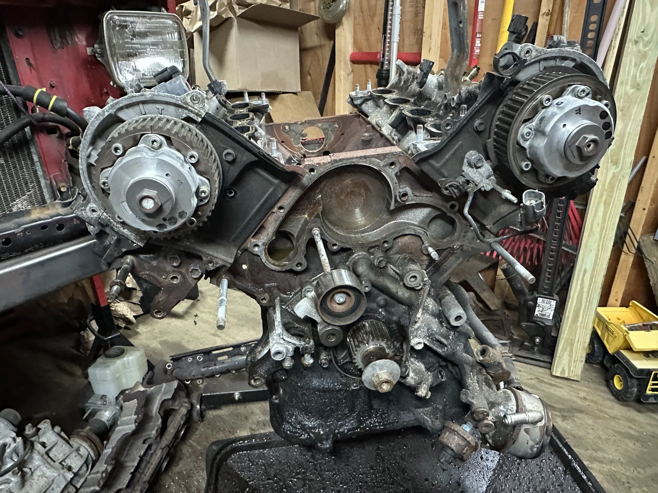

Have to use a transmission out of a LC/LX for the transfer case to bolt up. Different output shaft and adapter housing than the other variants. I’m running a later 2uz with VVTi and the A750 5 speed. The VVT engine puts out a little more power and the A750 has a lower first gear, 3.52, over the A343, 2.80. Figured while it was out I’d reseal it since it was going to be half apart for the timing belt anyways.
