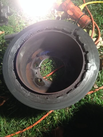

Burning the midnight oil for the ex
last night. Worst rotor I've ever seen. What we do for our children...

Holy crap!
Holy s*** Josh no wonder your brakes worked like s***.
Odd.... Josh, Josh. Right rear, right rear. Except I just inherited this truck last night.

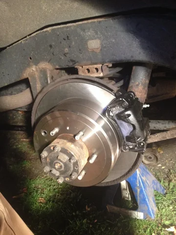

My thinking is LSPV is busted, stuck open? All braking force was going to rear? Fixed rears, drove it last night and still no pedal. Seems like no front braking power. I'm very new to 80's but that was my deductive reasoning. Dunno. How are your brakes now Josh?
Keep bleeading.....
