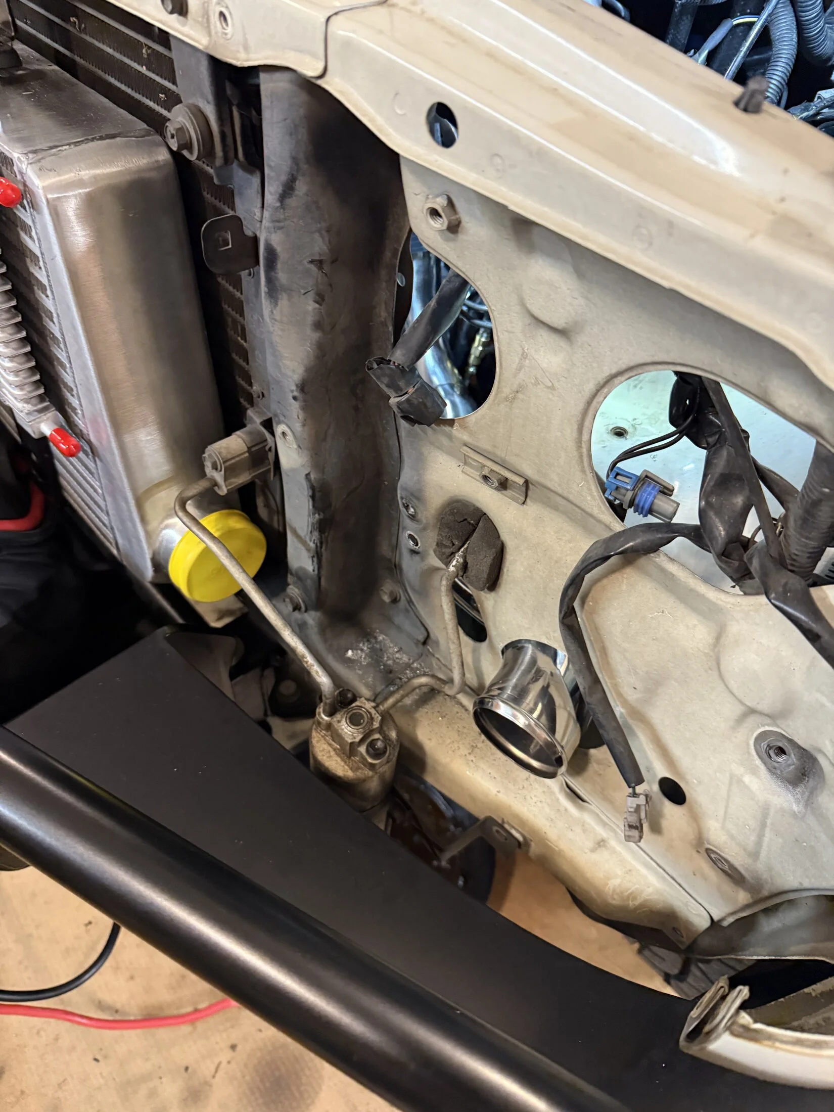

Ok, now 6boost creates another challenge, A/c suction line has to be re routed “ no big deal if you are changing the compressor anyways - and have the tools and I do” got swivel block fittings awaiting new line to make up.

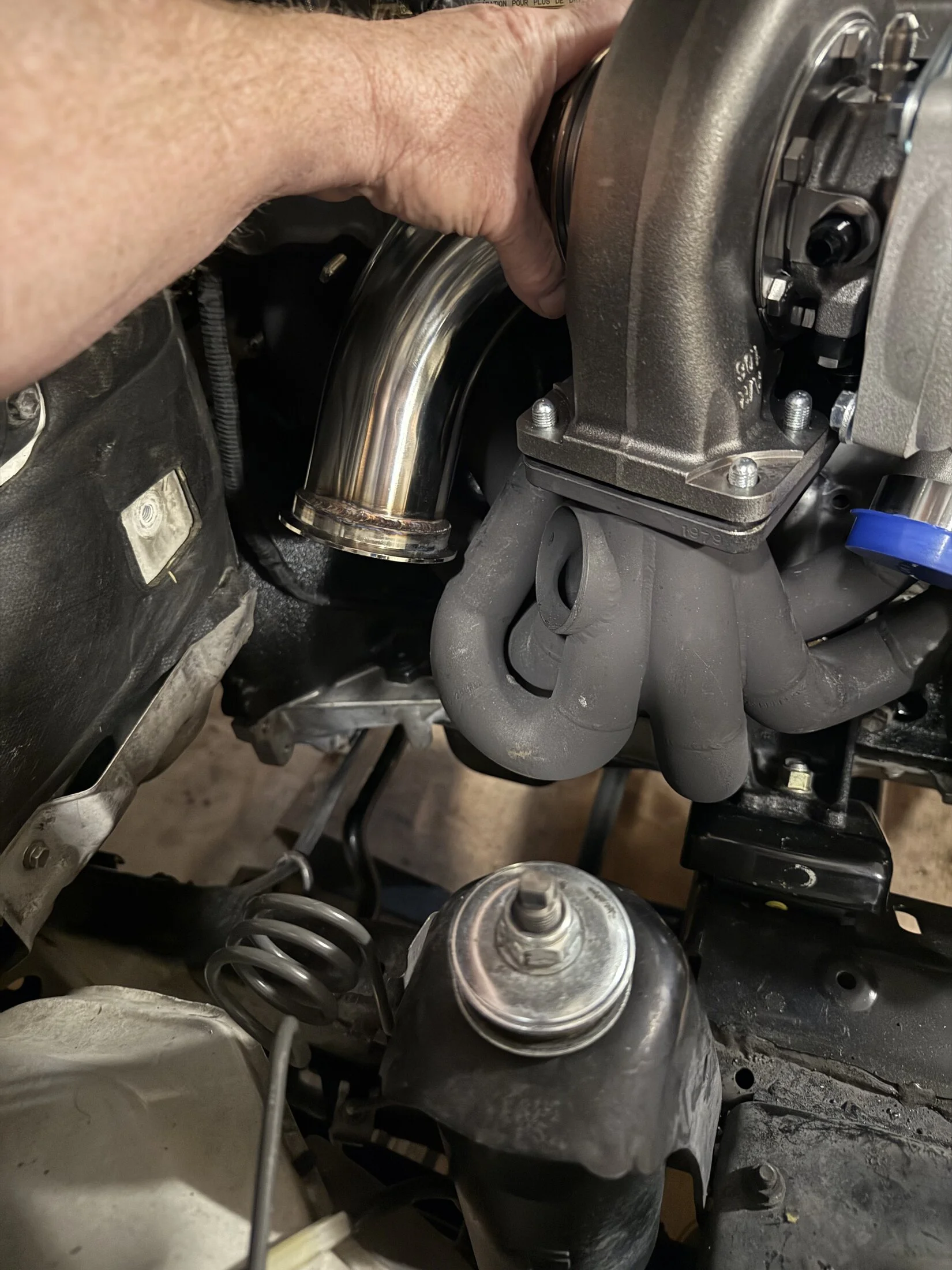

Next dump pipe, the one provided from
HD auto the 02 bung and sweep is not totally correct for my setup. In the process of cut welded flange off , flip the pipe over. Shorter at the turbo connection and tack new collar on provided with the turbo. Ok, not a big deal. Next new 3 inch exhaust , stock exhaust IMO is two restrictive and need better flow. I went with stainless 3 inch Manta quite muffler diesel version. Cat isn’t required for my age truck where I live for its age. I am held up right now on the muffler for the exhaust. It mistakenly got left behind in Australia however it on its way.

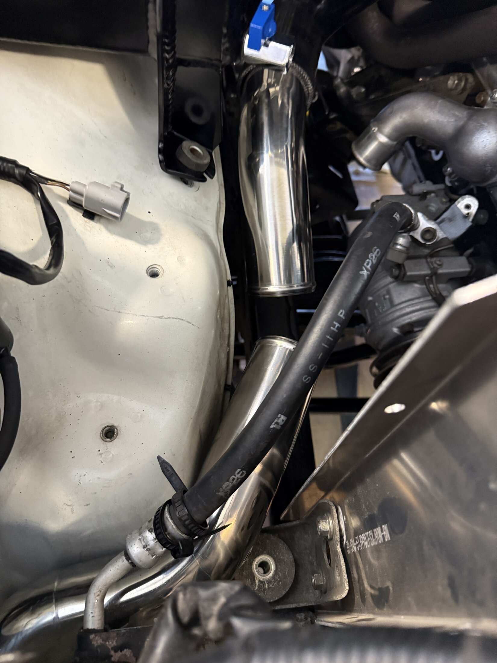

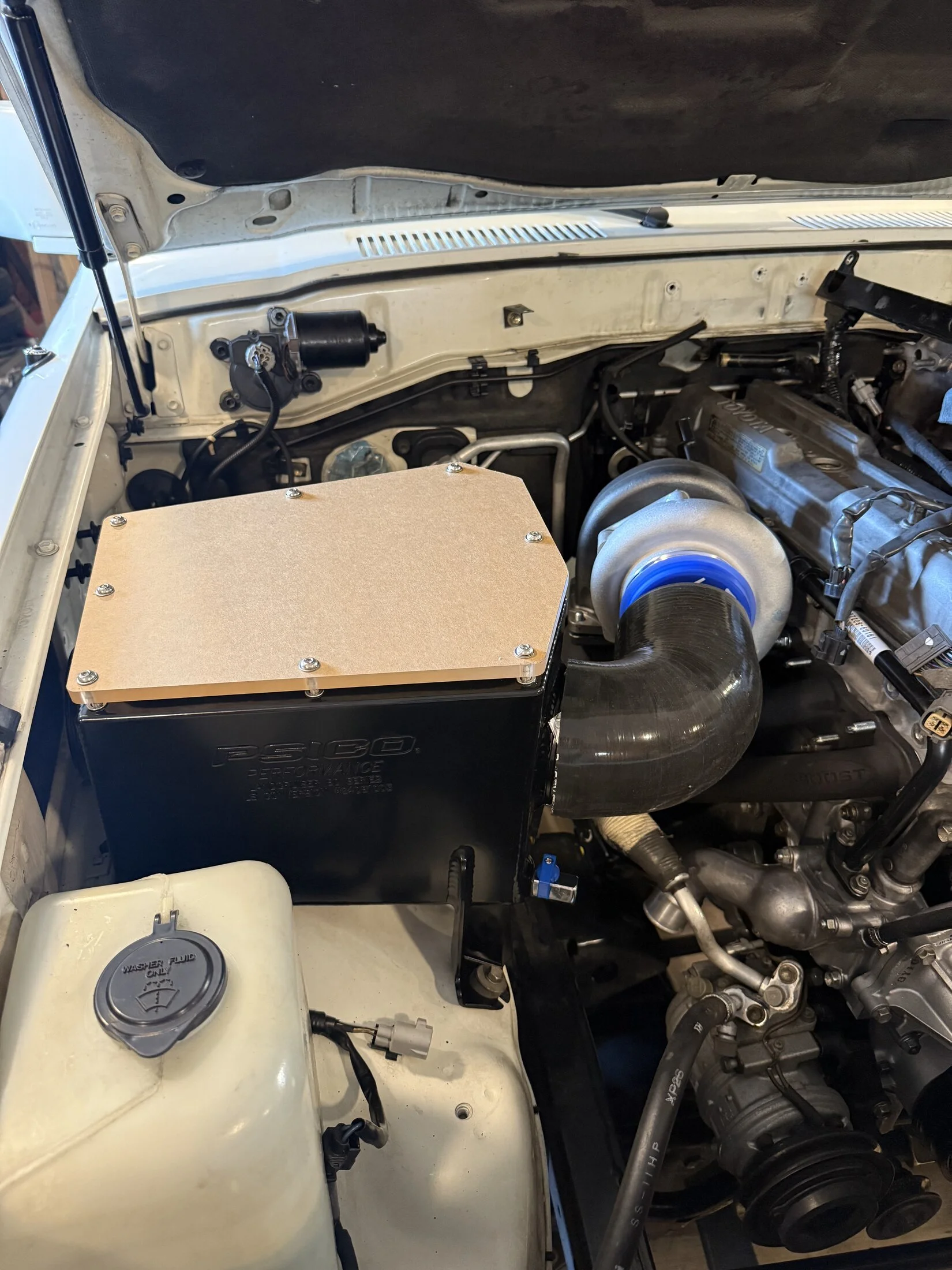

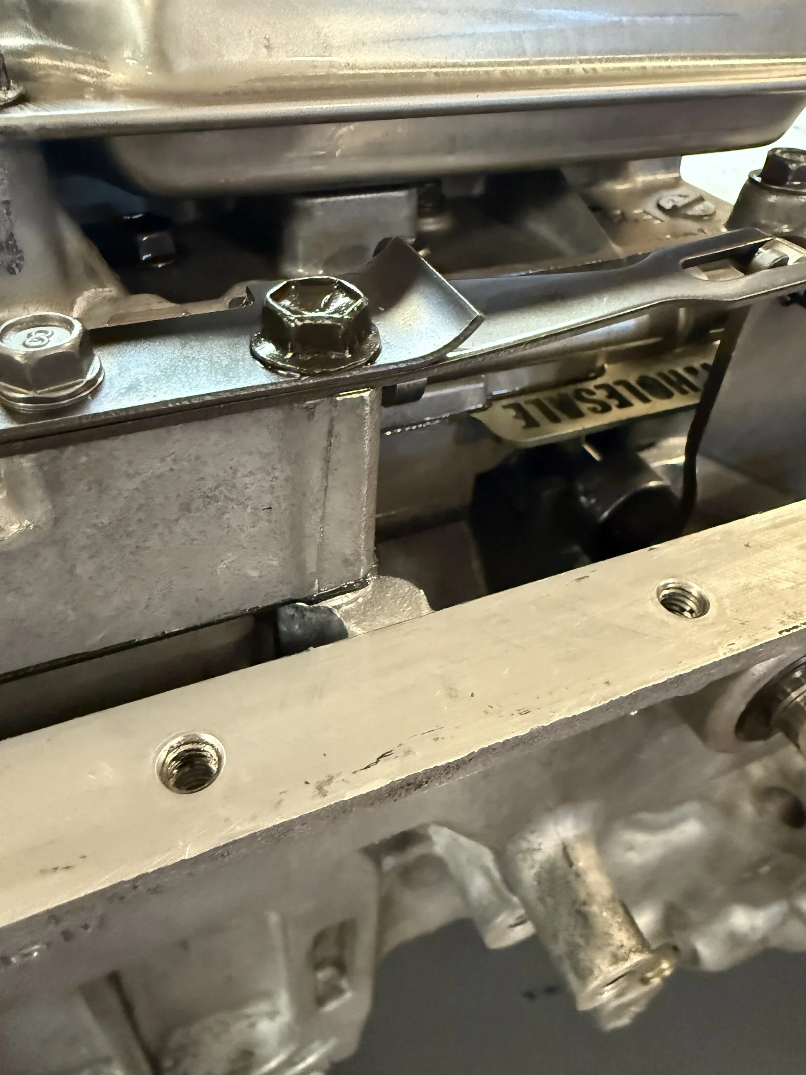

To address the air box I went with 4 inch opening PISCO from Australia to upgrade that too. The brown on top is a protective coating and peels off. It’s clear looking through it.
Part 2,

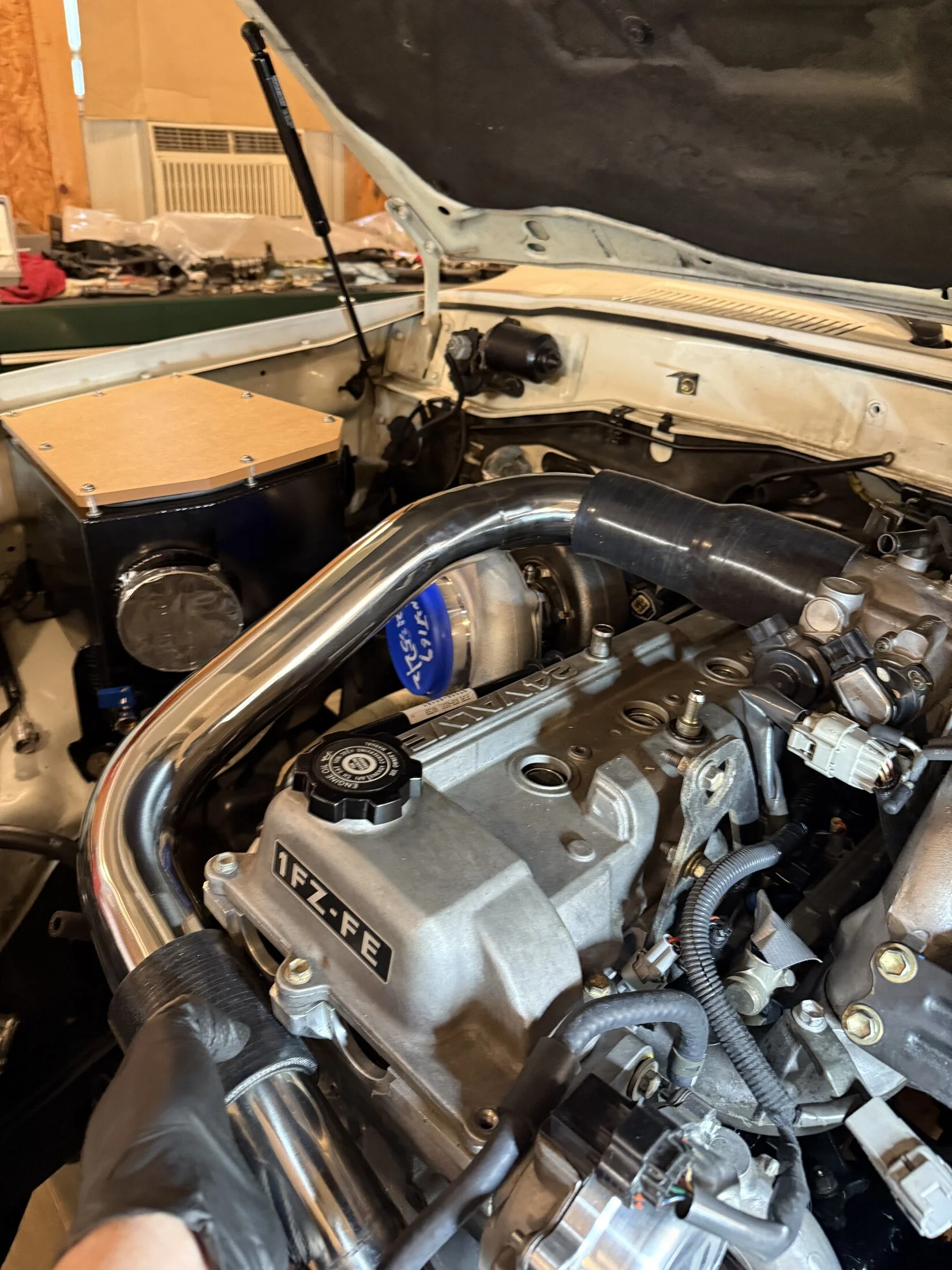

The silicone connection hoses will have to be trimmed to fit but basic mock up looks good. Drivers left brake lines and os lines are kinda in the way. I replaced my ps pressure line and twisted it towards the center of the truck a touch, took the brake frame bracket off the frame and used 2 10mm unions to reconnect the brake lines and massage them not to rub on anything. Per the PDI instructions I was to loosen the frame attach bolt and push the top of the bracket back. However there is a steering box I was originally concerned about being left hand drive in the way. Removal of the bracket and two unions solved the issue.
The new US shipping my shipments are staged being sent because of value. The new valve cover / oil cooler are in the shipment that’s on hold. Dang it if I would have known I would have the 1st shipment sent over a week ago, Lessons learned.
The muffler coming from Australia is another issue awaiting its arrival to mock up the exhaust system cutting and spot welding it together to join the 3 inch system. An oversight my part and HD no pic list to check off items and not realizing no muffler.

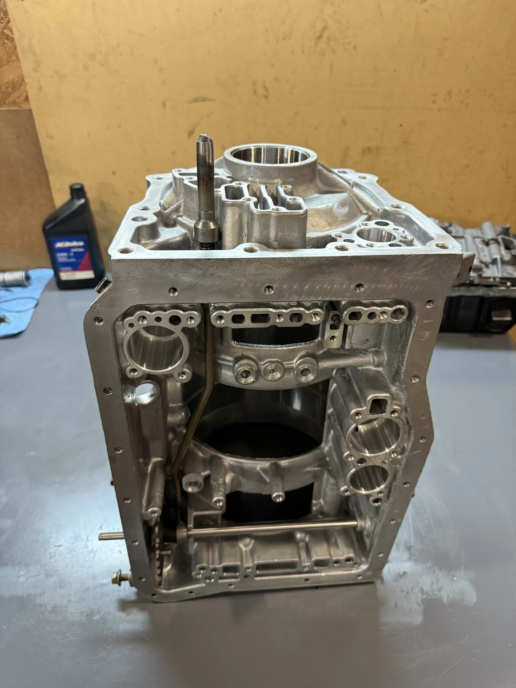

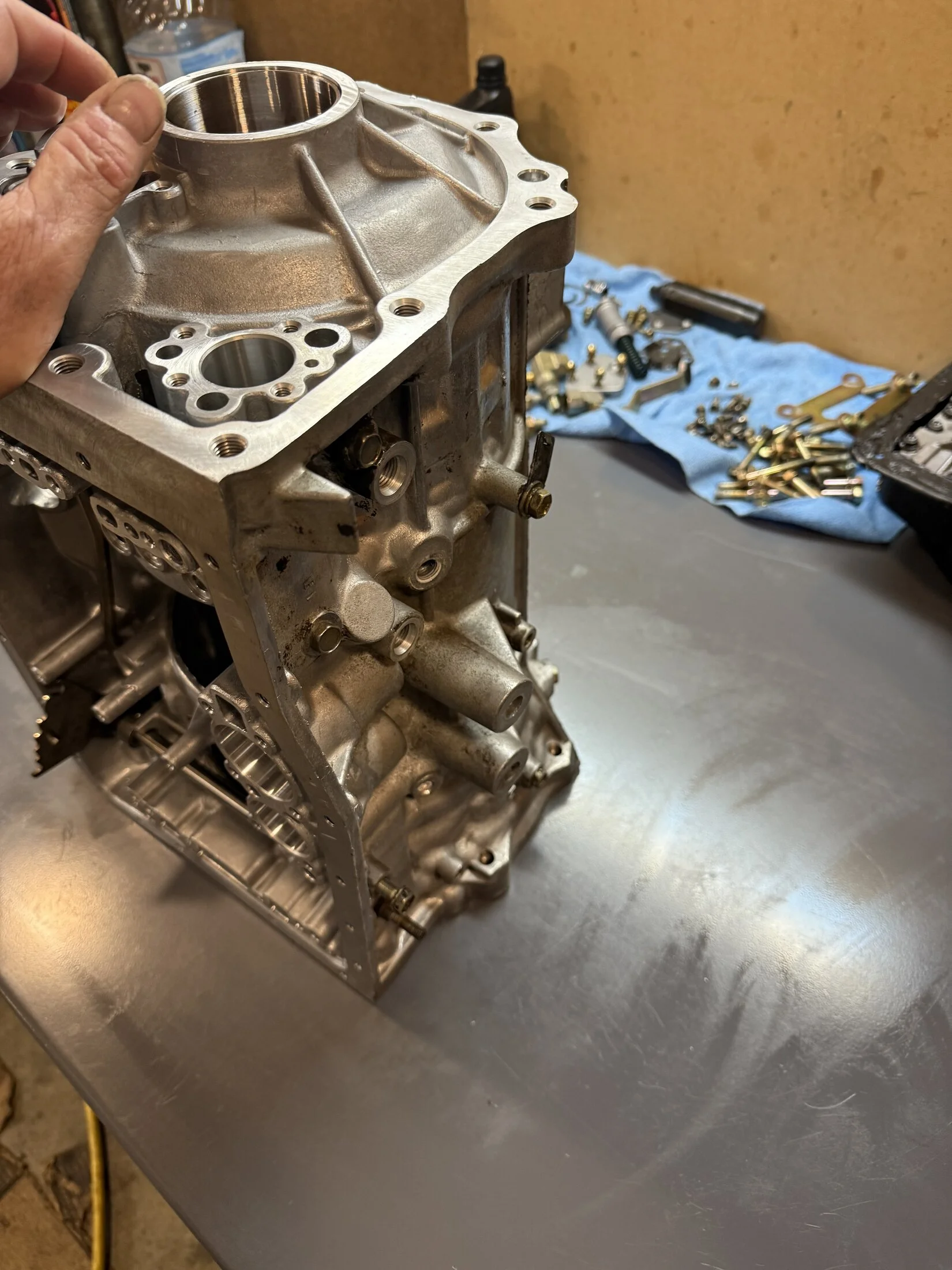

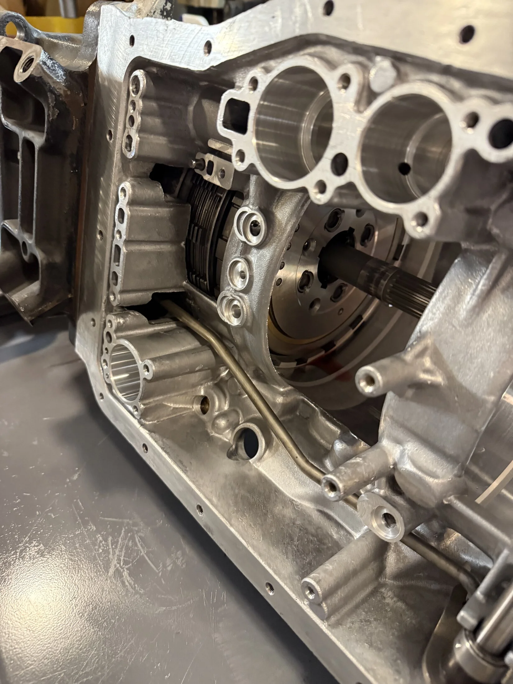

So in the mean time switch gears and today scattered the transmission. I was very surprised just how good it looks inside. Very little material in pan, zero scorched clutches in the clutch packs. It was working perfectly before its removal.
I am looking into a clutch piston mod and adding extra discs to some clutch packs. This hopefully will help hold the extra engine power that is to come. Plus a modified Nomad valve body and line pressure actuator to help made increases like pressure as manifold pressure changes.
No oics today… will start case clean up tomorrow and washing hard parts

Transmission going together. Got the case cleaned up
today after work, cleaned and resealed the Low / Reverse
Piston, and stacked the Reverse / Low clutch pack. I proceeded to verify the Piston travel when air checking the clutch. Set in the rear planetary and tail shaft, then the one way sprag clutch, finished up with the speed reluctor 18 tooth / parking gear. Installed the tail housing on with a new seal/ gasket.
Called it quits for today.
As the world turns, continues tomorrow.
Tex

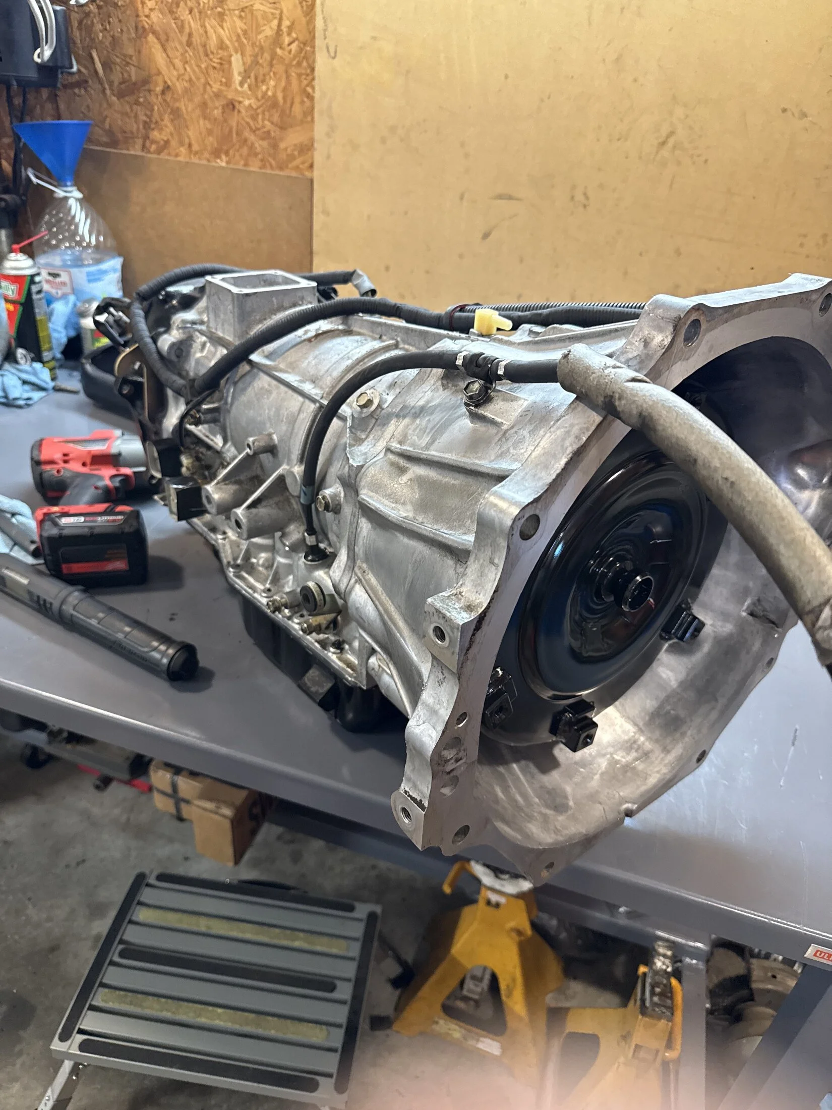

Part 3 completed. Transmission with extra clutch discs in intermediate “2nd gear brake” and rear clutch “Direct” plus built up converter, with wholesale Nomad Valve body is completed. Got it installed back in the truck.

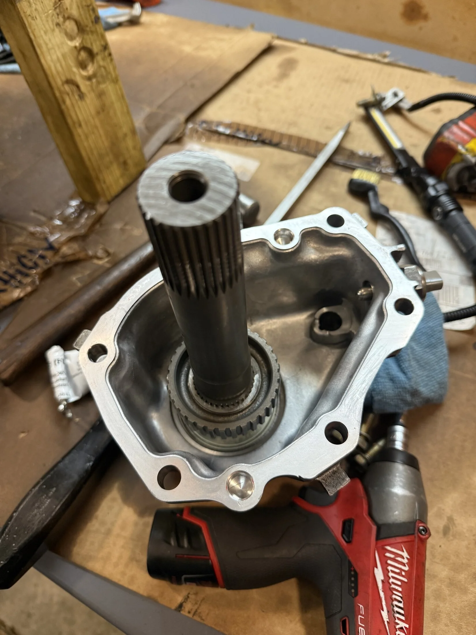

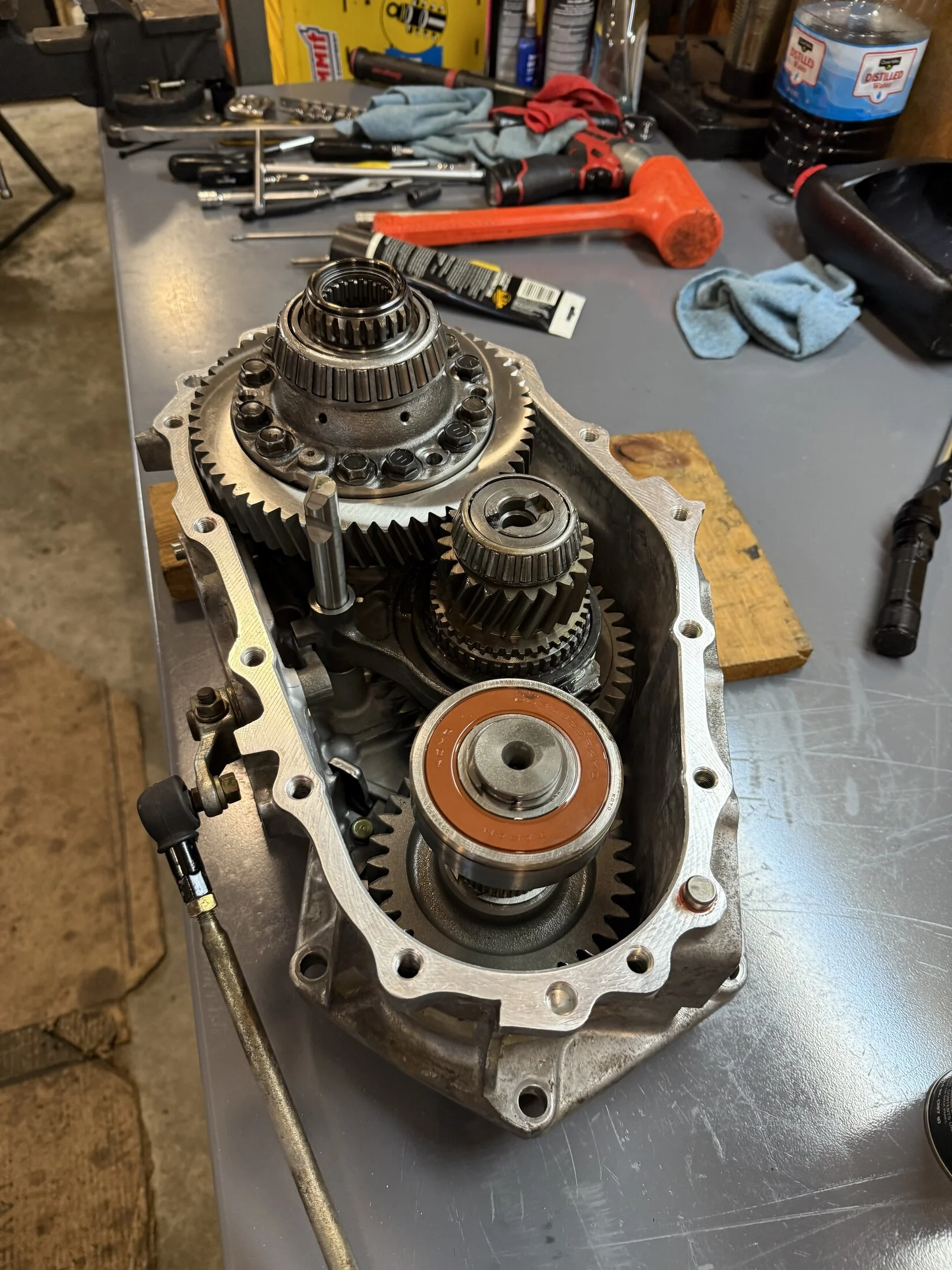

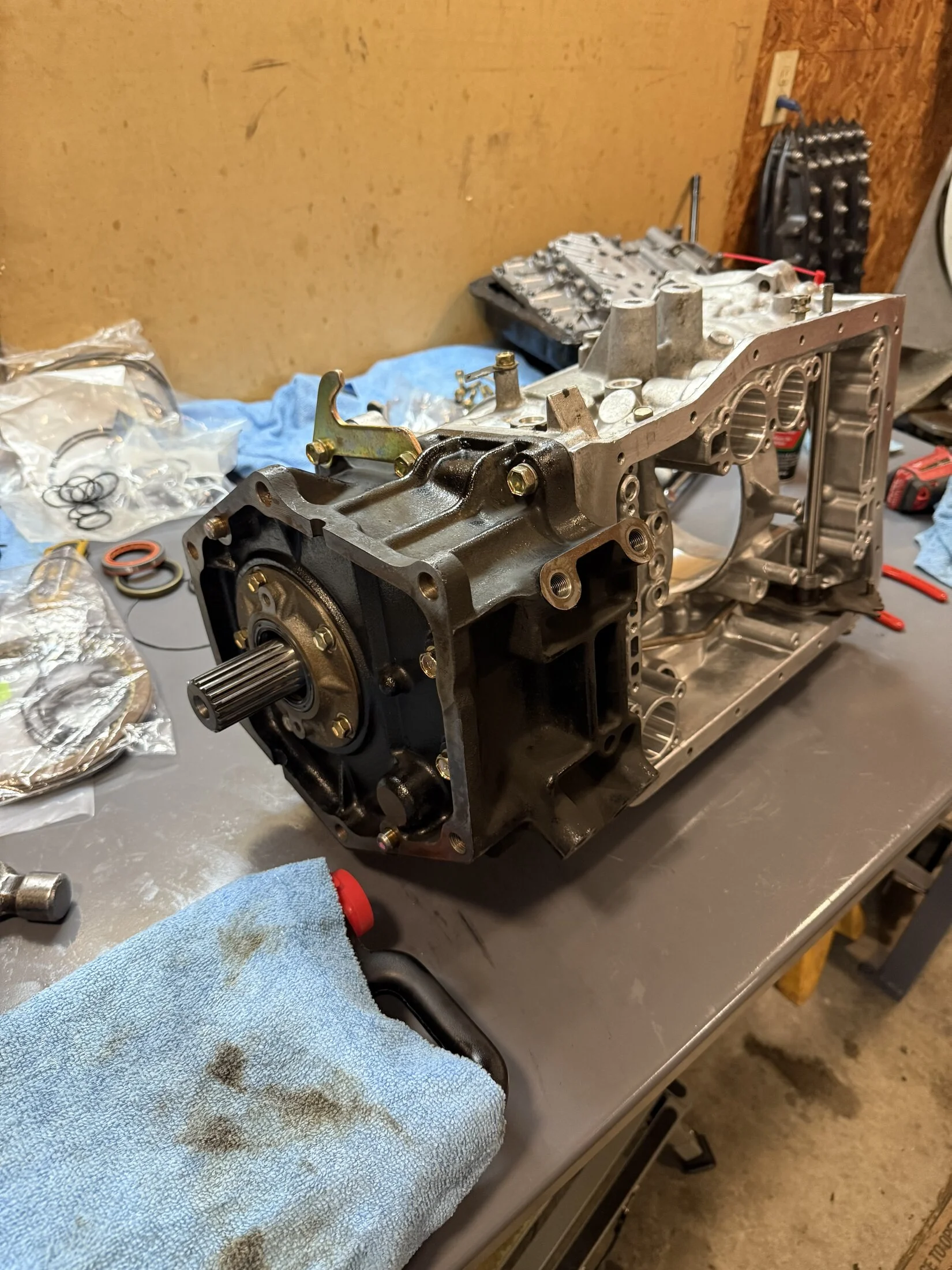

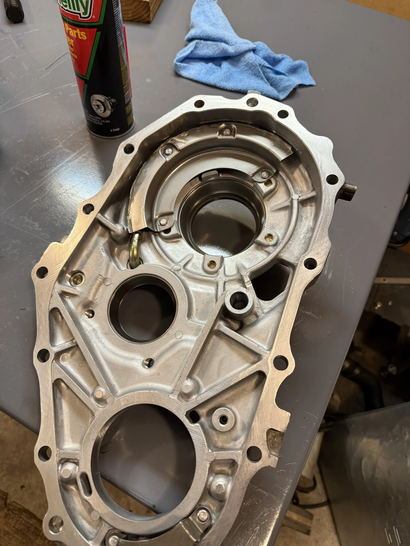

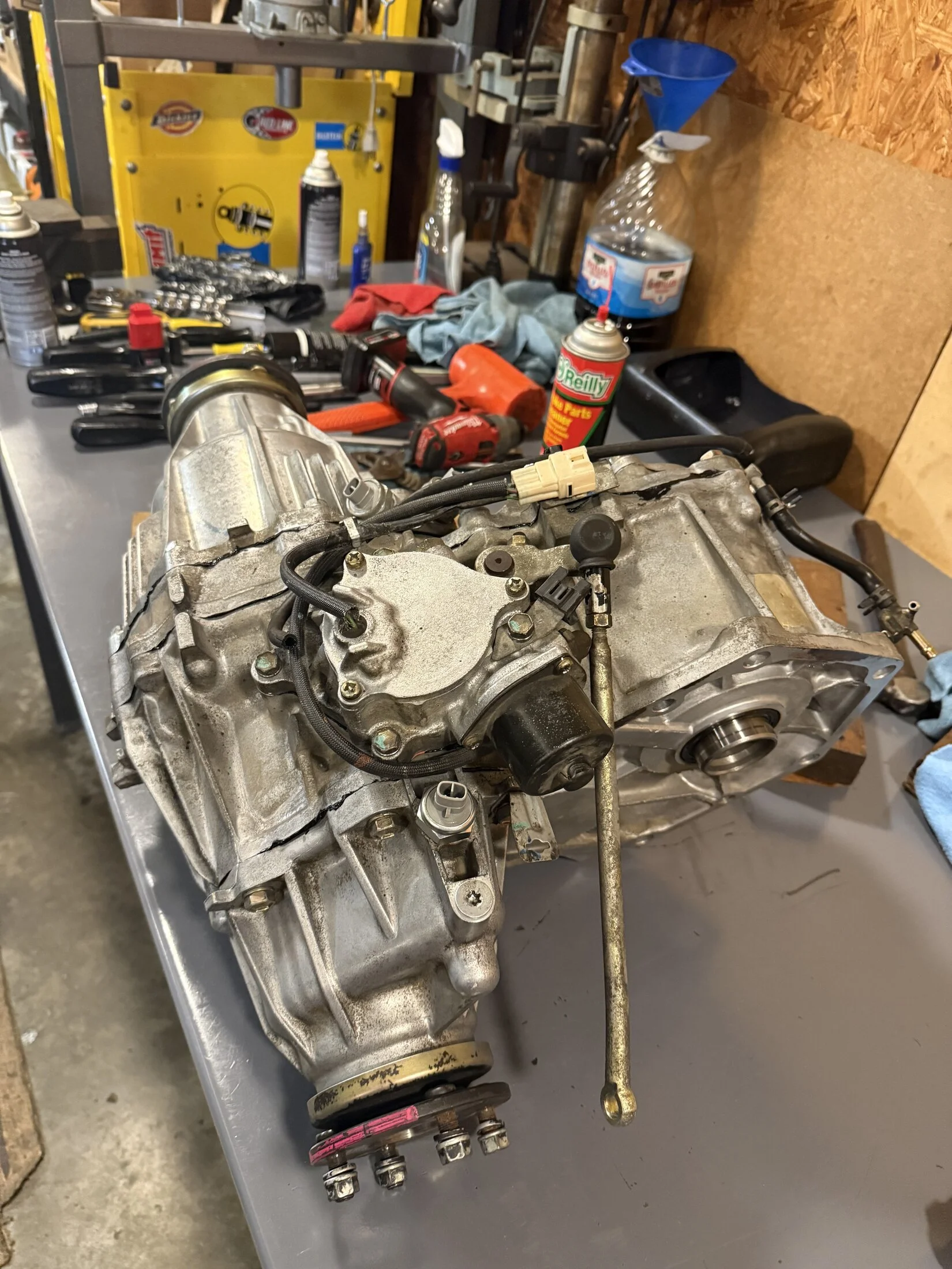

Part 4, Transfer case
Put it on the bench with the purpose of reseal extension housings and install low range gears.
Finished that today.

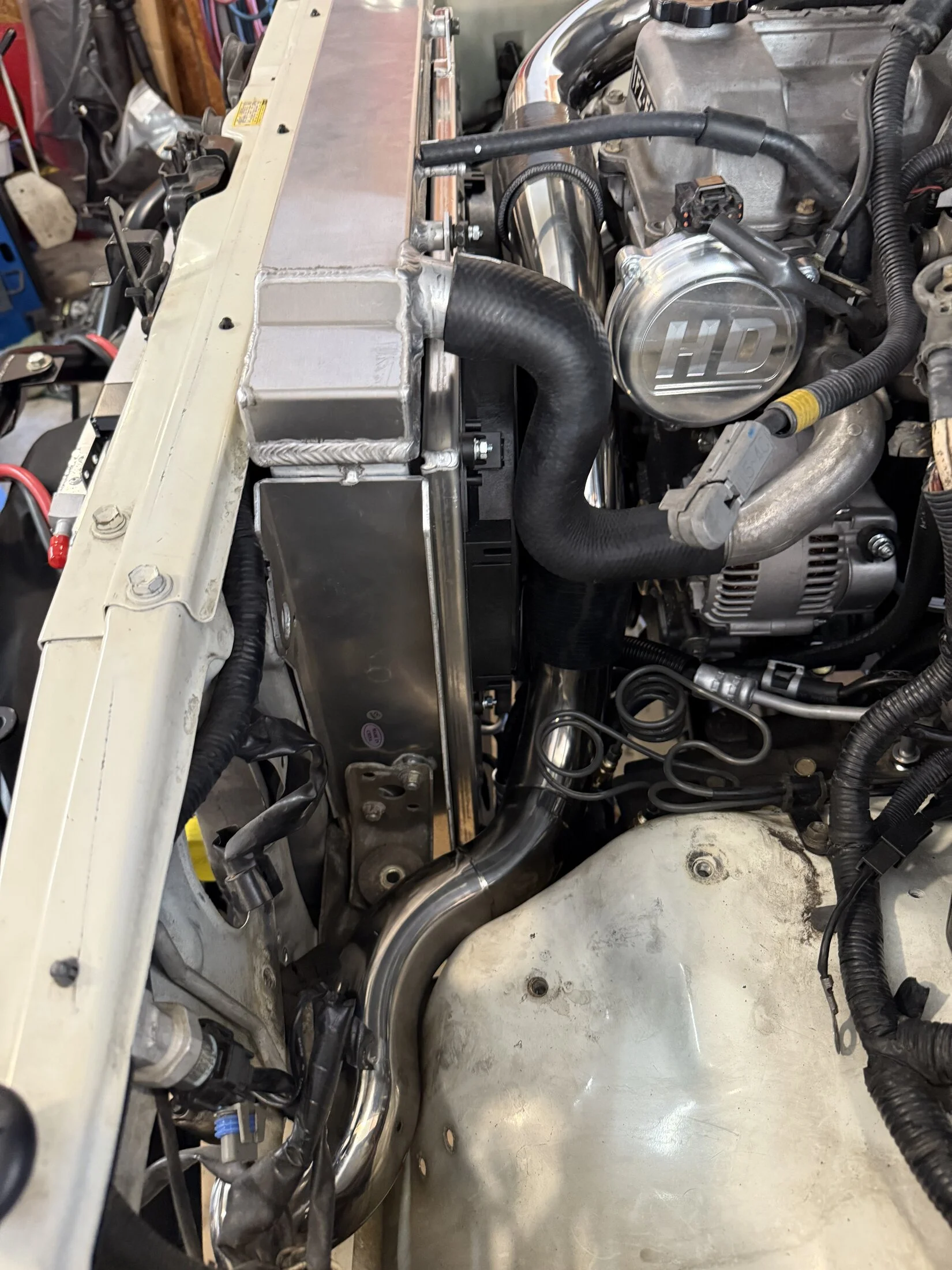

Test driving revealed Electric Fans can’t keep up with temps no ac in 90 ish degree heat. I have a 4 row aluminum radiator and space to engine reduced. Tried supplied electric fans and no good. Went back OE shroud, OE Fan blade and blue clutch. Removed the orange new clutch because it’s hyper active to my application. I bought it when needed it for spacing for the supercharger trial.
Can report perfect temps on Blue clutch and oe shroud.
Without AC so far.
Awaiting Reduced Barrier Ac hose to arrive to make my new hose. I ordered incorrect hose Ac barrier hose and does not fit my fittings.

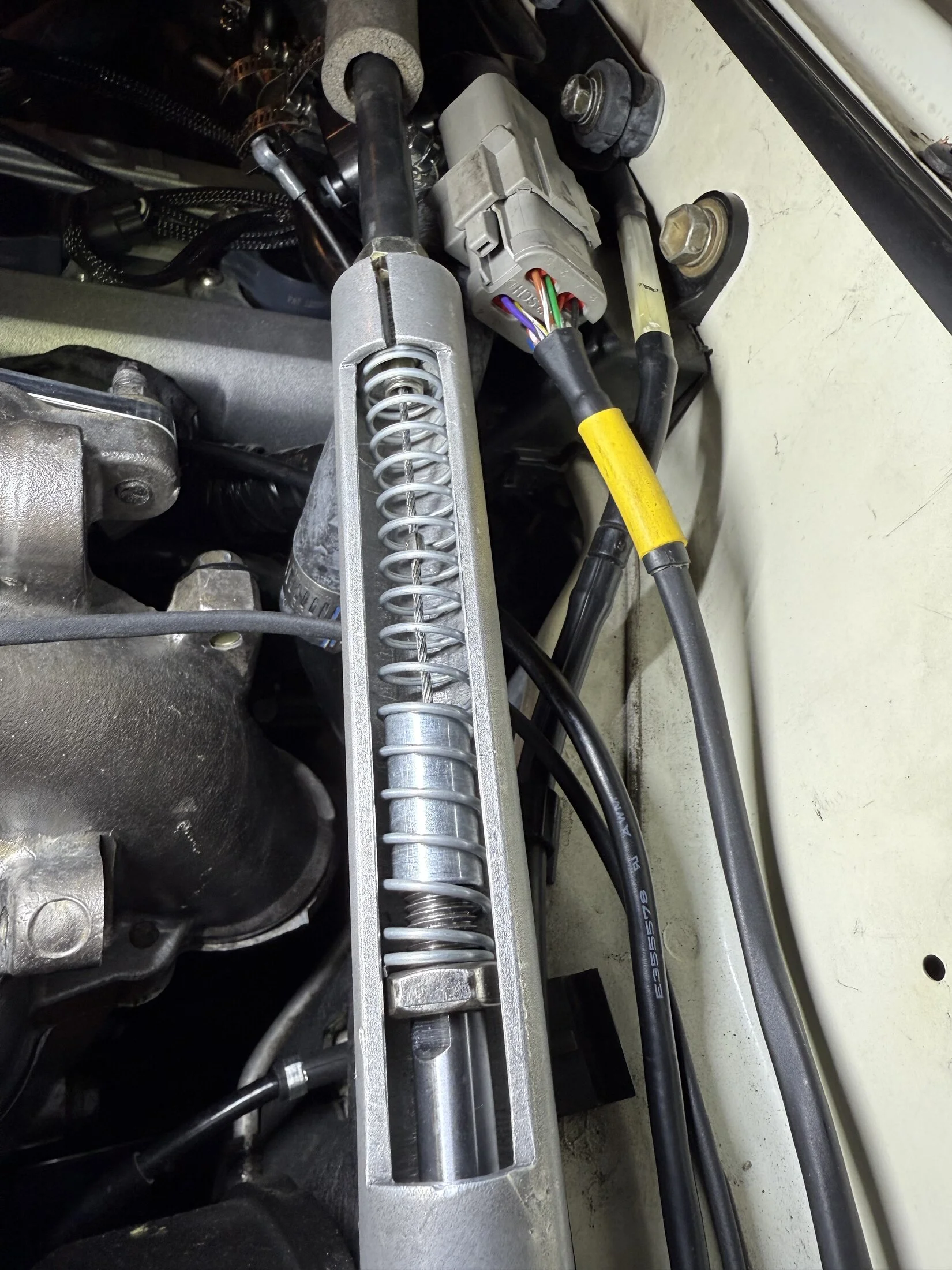

Trans working as espected fine tuning the spring tension to aid throttle pressure under boost / vacuume.

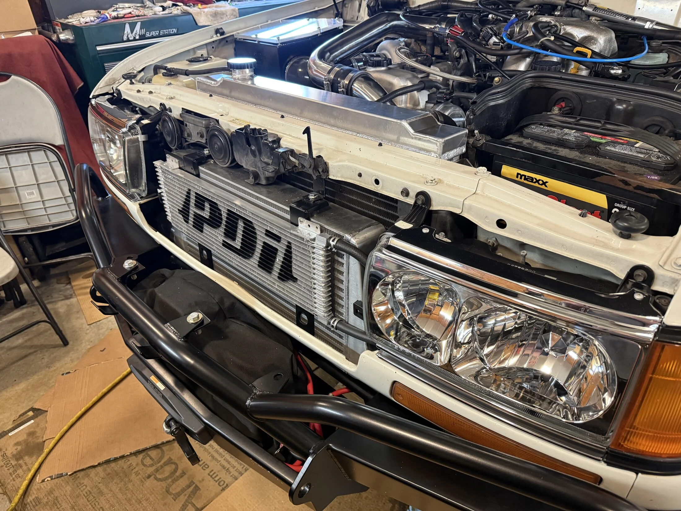

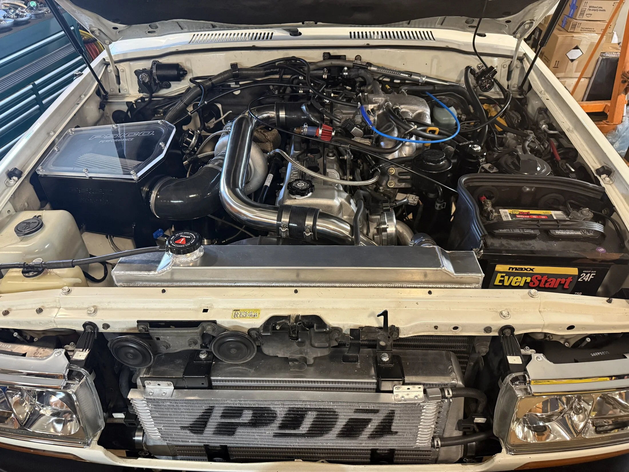

Intercooling YES! What a difference that makes! Have only 5 lbs spring in waste gate now as I break the engine in. What a performance difference between Turbo intercooled vers supercharged, wow!
Heat soak at Starbucks coffee time, 150 degrees IAT , take off 1 block 130, 1 mile 115-120 at 45 mph. Yes! Intercooling works!
I Highly recommend that! Numbers do not lie lower IATs is more dense air.
Engine power is great, the stall in the converter as you roll in the gas hit the sweet spot of the turbo. Spools fast and responsive.
70-85 blip the throttle and it’s there. With no down shifting depending on how aggressive torque converter unlocks.
I could not be happier.
