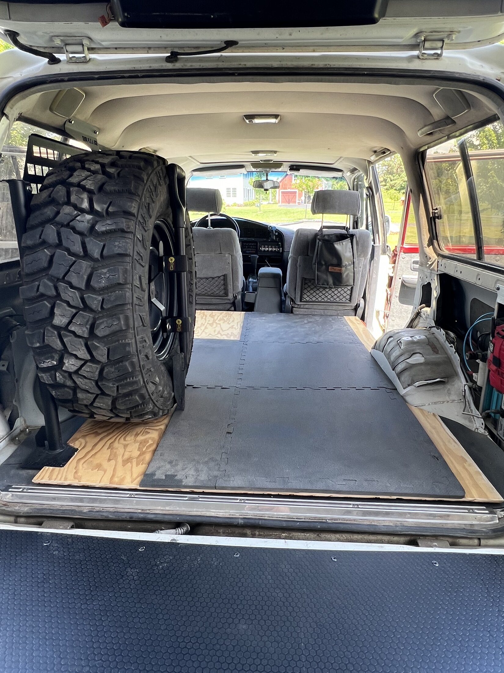

Space isn't really an issue for me. Here it is unloaded.
