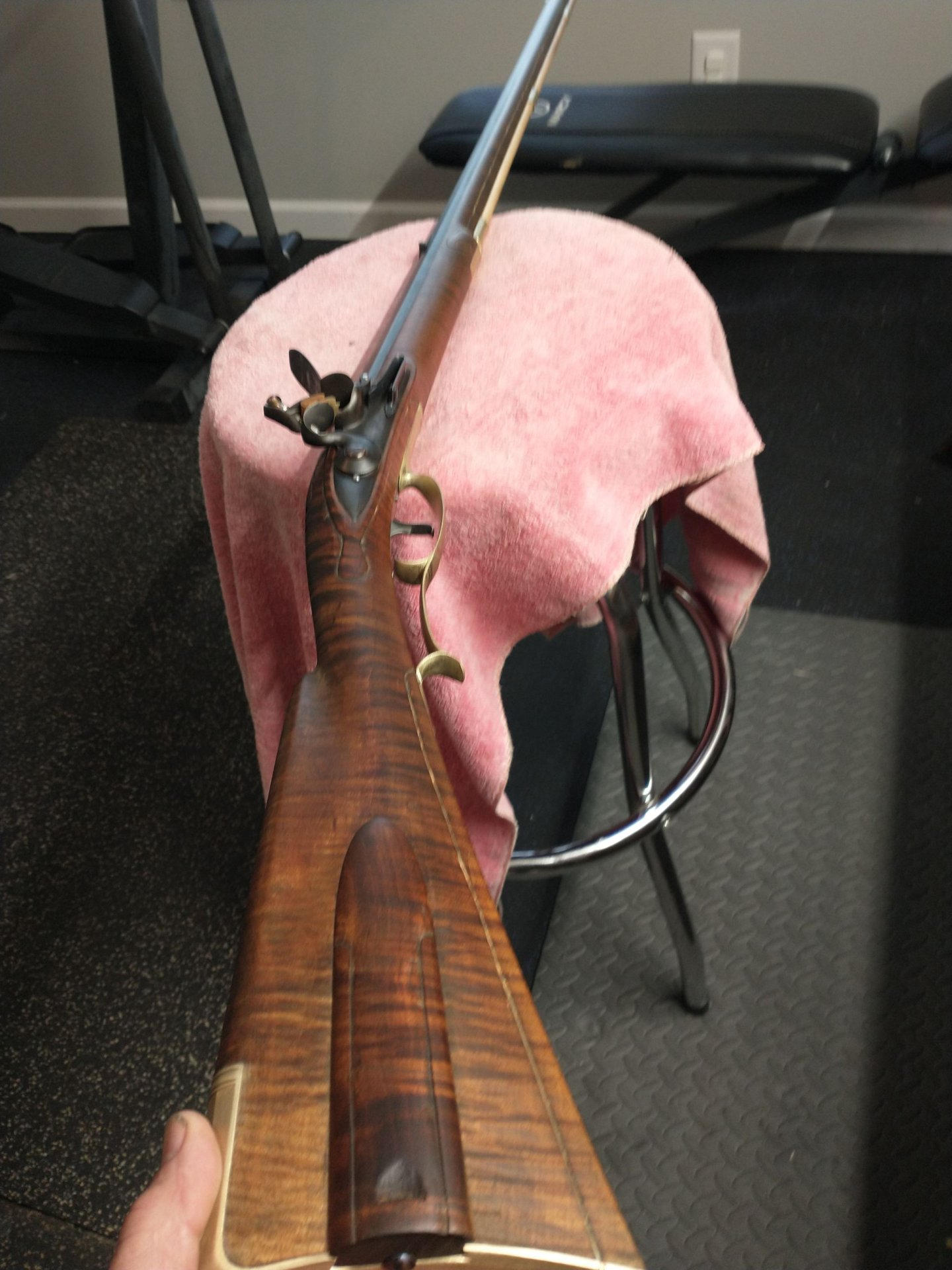

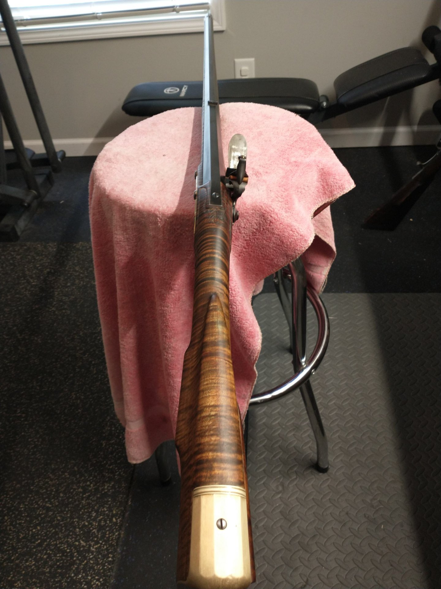

I'm also wanting to get into historical trekking. Have a flintlock kit (since 2006) that I need to finish, and a premade flintlock. My nephew and I are talking about doing that together soon.
Love your rig, and the trip you took.
I would highly recommend not wasting time and energy on a mass produced flintlock, or flintlock kit. They have lots of retained value, so I'd sell both the premade and the kit and get something better.
Very few of the mass produced stuff can be made to operate correctly, and the frustration of having a cheap, poor working flintlock could sour you from the hobby. And that's not even considering how historically incorrect the mass produced flintlocks are.

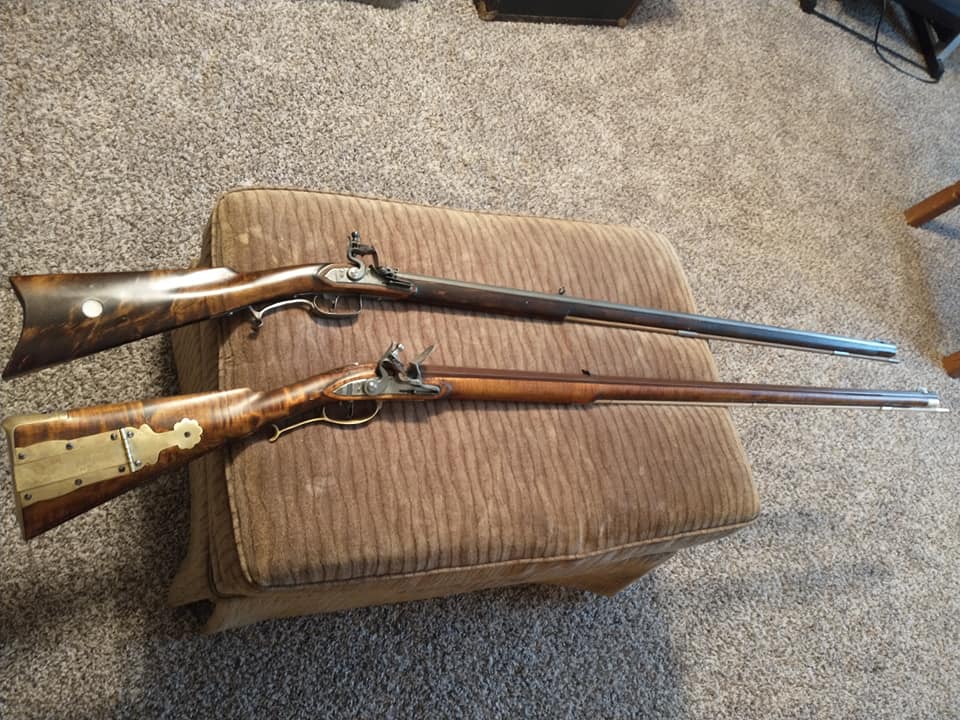

I do some historical stuff and make my own flintlocks, and I HIGHLY recommend spending the coin on either Kibler's or Jim Chambers kits. For the money, vs effort, I give Kibler's the slight nod.

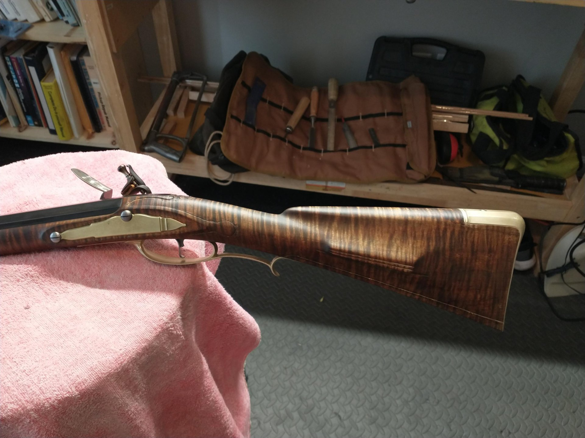

The bottom rifle is a Chambers kit with plain wood. Requires more work with chisels and shaper, but they work really well.
That one is my competition/living history gun, with a little better wood. Cost more to purchase up front but it looks amazing, was a relatively simple build and lock time is nearly identical to the high end cap lock guns.

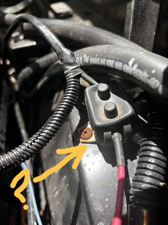

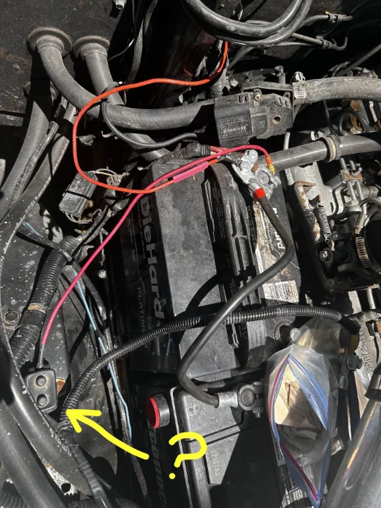

Does anyone know what this little box is? Fuse?

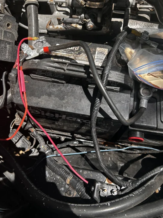

The other more orange wire is for a cigarette lighter power plug I put in for now: allows me to charge my phone and a little blue tooth speaker.
But the other wire is obviously not OEM either, but leads from the battery to that little box thing that looks OEM. Or could it be part of the AC system?
Pretty sure this is related to the AC unit.
And, I am pretty sure I am taking the AC out. Trying to find a way to make a working bracket that doesn't interfere with either the alternator or the oil filter, or something else, but no luck. In addition, the thing was rigged onto the truck and I don't know what is what.
AC worked fine until I lost the coolant, so I would also have to deal with that.
Maybe I can take it off and sell it, and install one of those undermount 12 Volt units. Less mess under tha hood and more power for the engine.
Still on the fence though. Tough to decide. It's pretty damn hot right now even up here in the mountains, but then it'll start getting cooler in about a month, and then I'll have to deal with freezing temps and below.

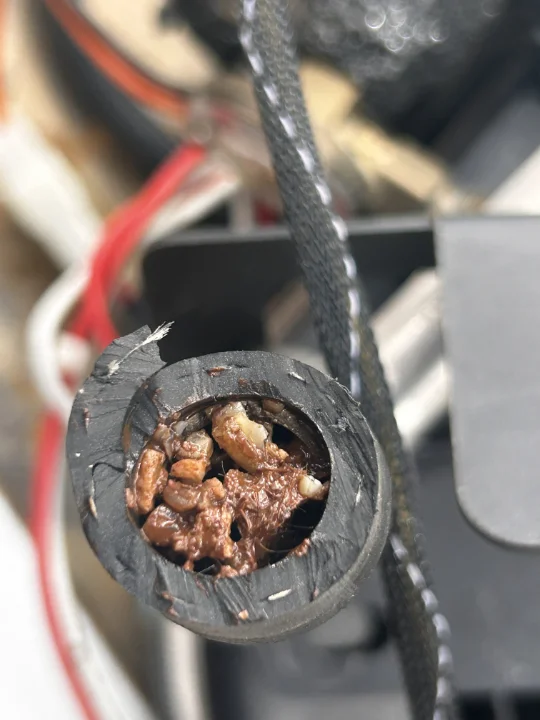

Look what I found when I cut one of the hoses:
WTH!!!!
Looks like river pebbles and hair!
I don't know how it could get past the water pump without shredding it, but maybe it was introduced during the AC install because it was right at the AC connection.

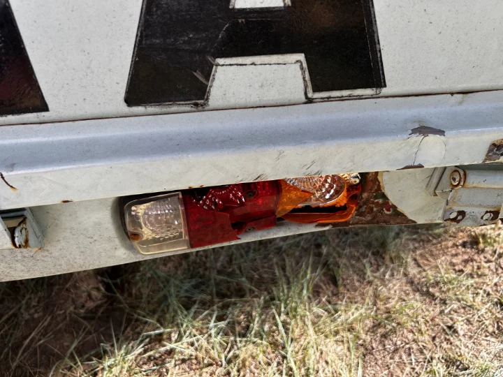

I fixed the tailgate!
Sort of...
At least until I start the restomod:
I fixed it by laying a 2x4 on the ground, and laying the tailgate (bent section) up (arch of the bend pointing up). I then carefully and slowly drove over it along the bend.
After that, I flipped it over and drove on the other side.
Came out pretty good, considering!
I'll do the finishing touches once I do the restomod. Same goes for the taillight area.
However, I have to find new taillights and housings now!

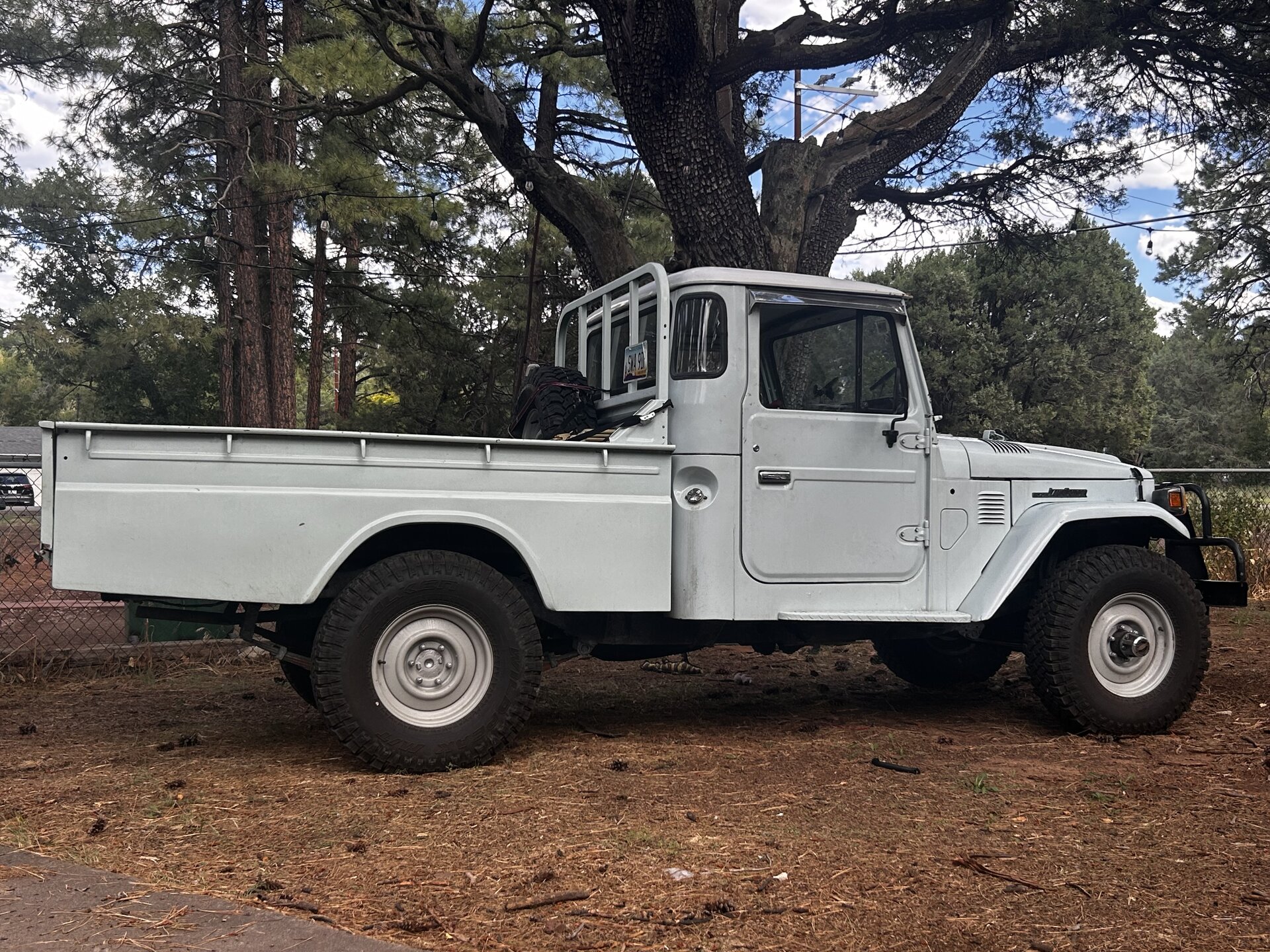

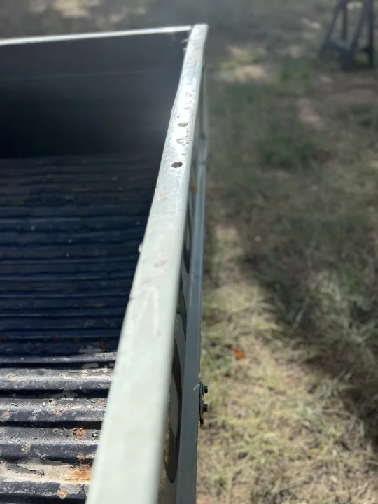

Sitting on a camping chair, looking at my HJ, I am pondering which way to go with the camper build..,
A. Use the existing bed with a box built on top and a pop up top for sleeping. This would be removable, but meant to stay on.
Make a trailer in the style of the bed for my business and long expeditions-maybe-like Alaska.
B. Build a box that replaces the bed. Same pop up design.
The existing bed would then be used to make a trailer. Concern is the placement of the axle forward of 50% of tub’s length. Maybe the tongue, a small Benny, storage box, and auxiliary fuel tank would help in weight balance.
I want the camper area to be like a troopy, with space to sit out if bad weather, and to edit videos, etc.
Other consideration is whether to keep the rear window opening the same and replace window with a hatch for emergency access to cab/cockpit, OR cut the window opening lower for same reason.
If you don't want to tent it on the ground, I say build a rack system that you can put your tent on the top. The idea being is keeping the bed open to pack all the necessities that you want with you while camping.
The problem I see with bed tents is they tend to restrict any storage space.
Definitively option A!
Not much point to drive a 40 and lose the original style.

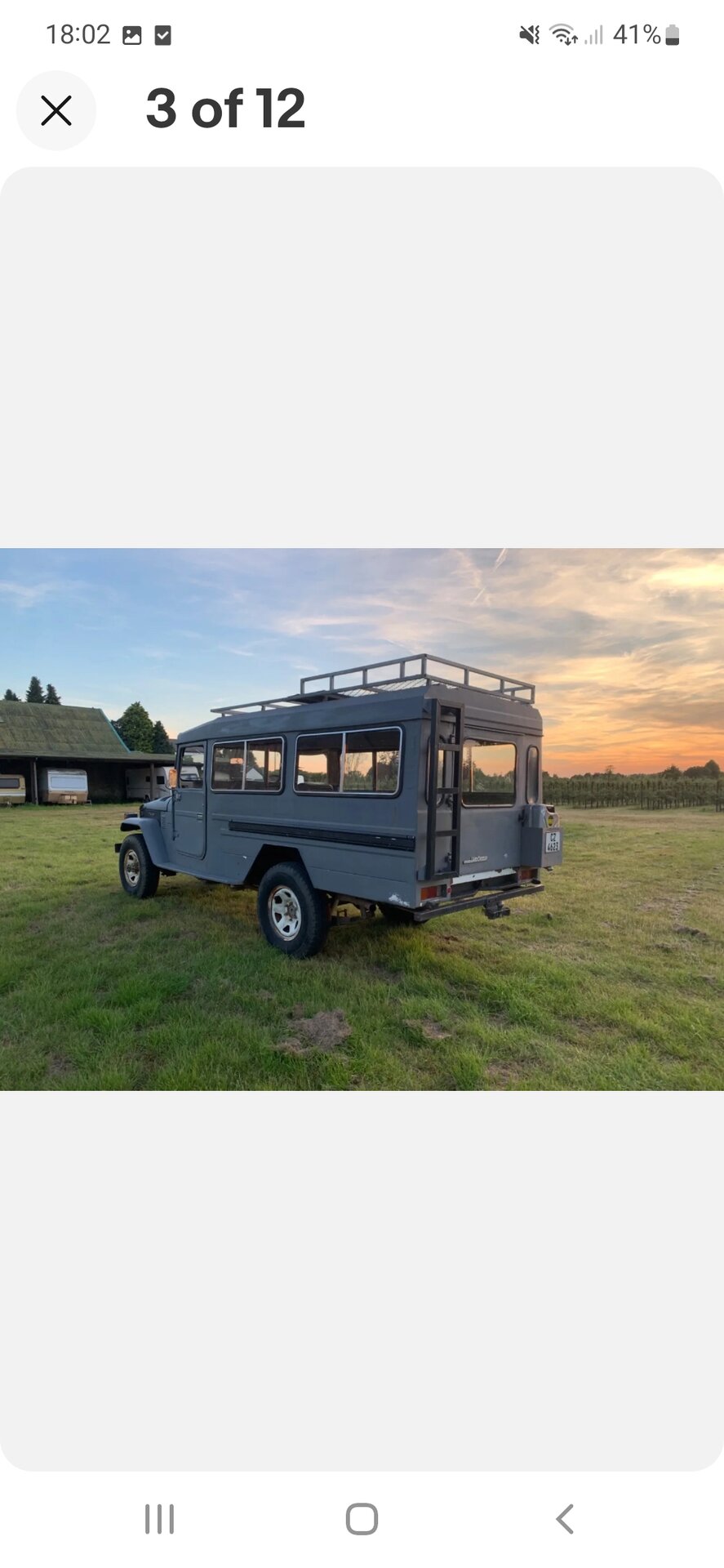

The bed is quite high off the ground though, so you'll need to lift the roof above the existing cab roof in order to sit comfortably inside - mine is just about ok but more would be nice. Try putting that camp chair in the bed and see where your head is.
I like the 40 rear design, but that doesn't fit with the 45 bed shape because it's square in the rear corners.
Because of this, people initially mistake my truck for a Defender. If you could somehow blend the distinctive radiused rear quarters onto the bed then that would be preferable to my eye.
You could fit a wider door in between the corner panels - maybe split 60/40 like the 70 series?

I can see the “Defender-ish” resemblance. Looks beautiful!!!
Still thinking out the rear doors. I could even use door/s for something else as long as they’re flat-sort of. Have thought of even making them from thin wall square/rectangular tubing and sheet metal.
I don’t mind the sharp corners. Kind of prefer it. But yeah, I see your point too.
