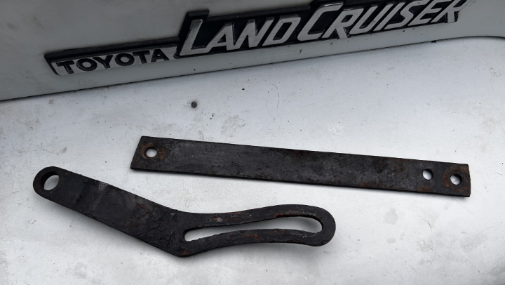

As I was driving through the Great Smoky Mountains a few weeks ago, I heard this loud clanking sound under the HJ-like something metal tumbling. I turned around and found this (the bottom adjustment bracket) sitting on the road:
The top straight bar was in the HJ. I think for the battery hold-down. Not sure.
I thought I had just run over it, from another vehicle, but collected the piece just in case.
Does this look like it could be the bracket for the alternator? It seems to be deformed on the cut, but that can be fixed by heating it up and straightening it.
If it isn't from the HJ, I can likely use it anyway.

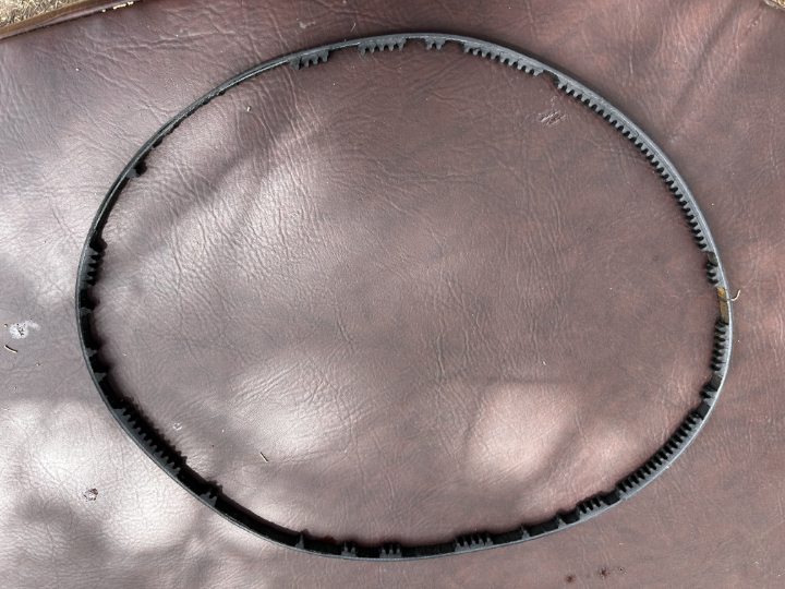

And here's the belt that I took off.
Pretty messed up.
Wondering what caused this: misalignment of the pulleys? Not being tight enough?
Hard to say whether that's the correct adjuster but it definitely needs beating flat again. Big hammer and a solid surface should do it.
Yes that looks like my battery strap.

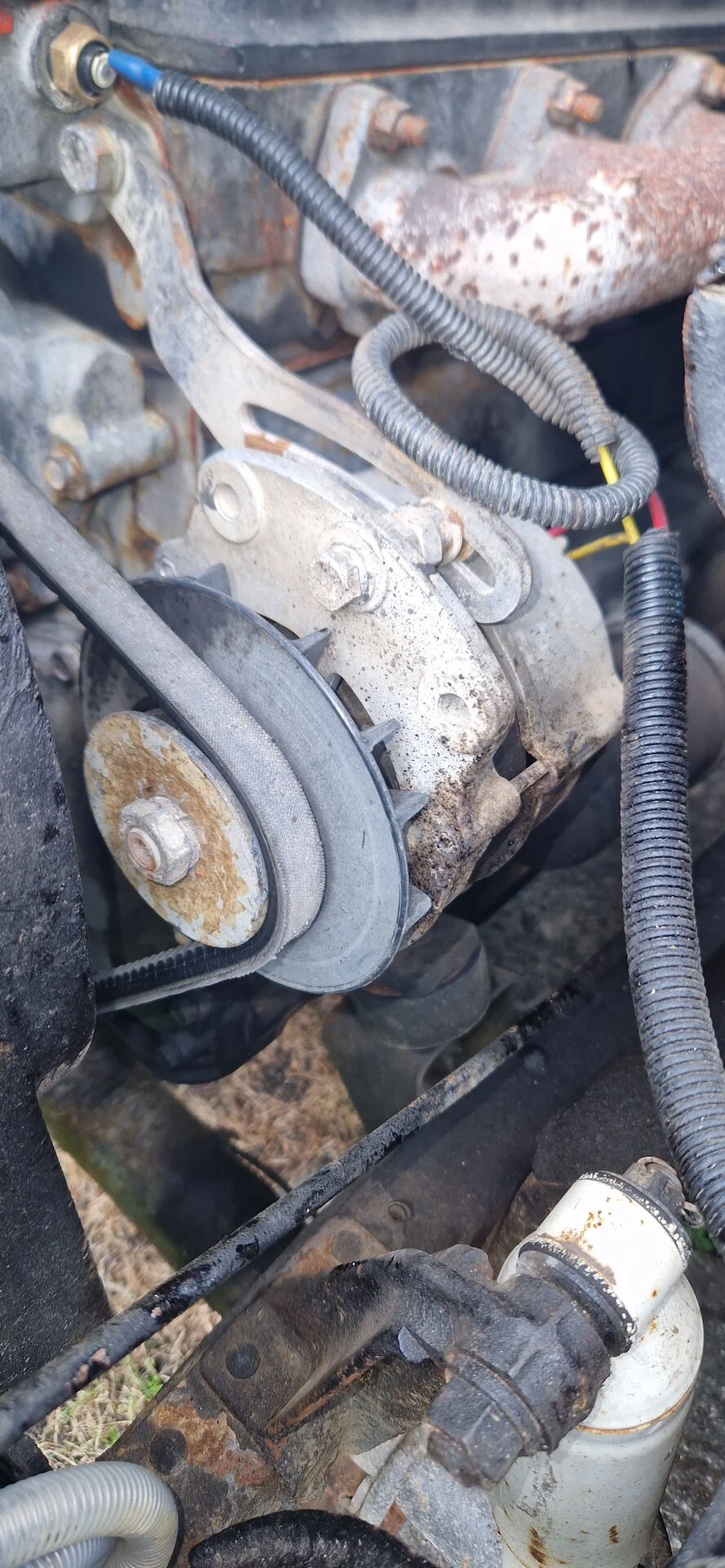

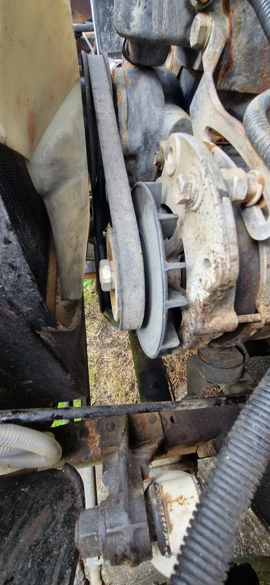

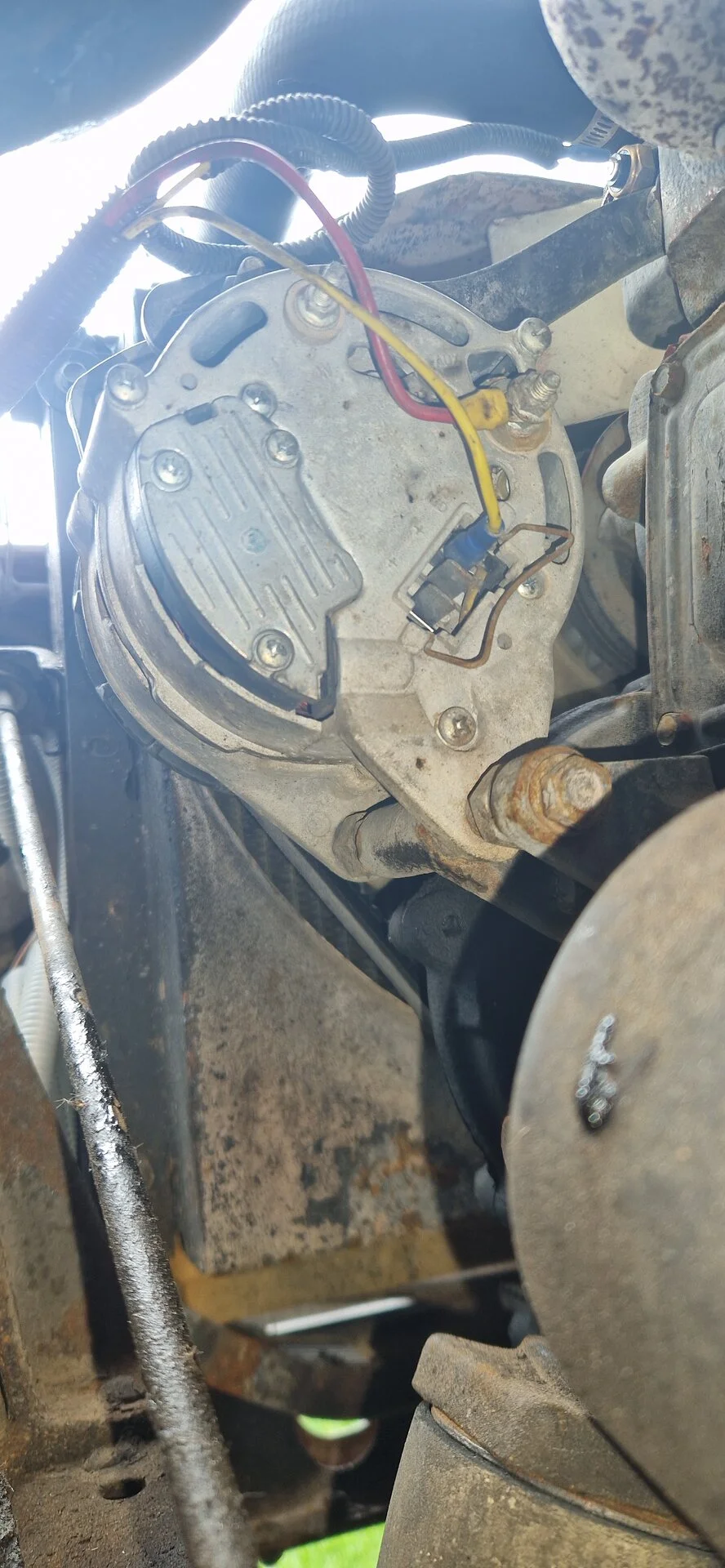

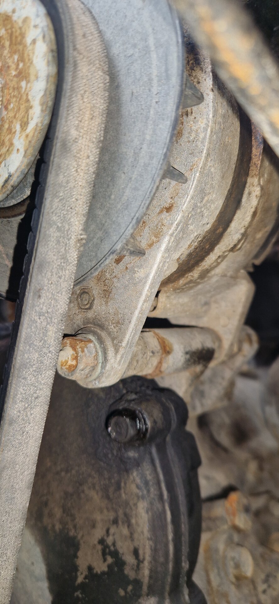

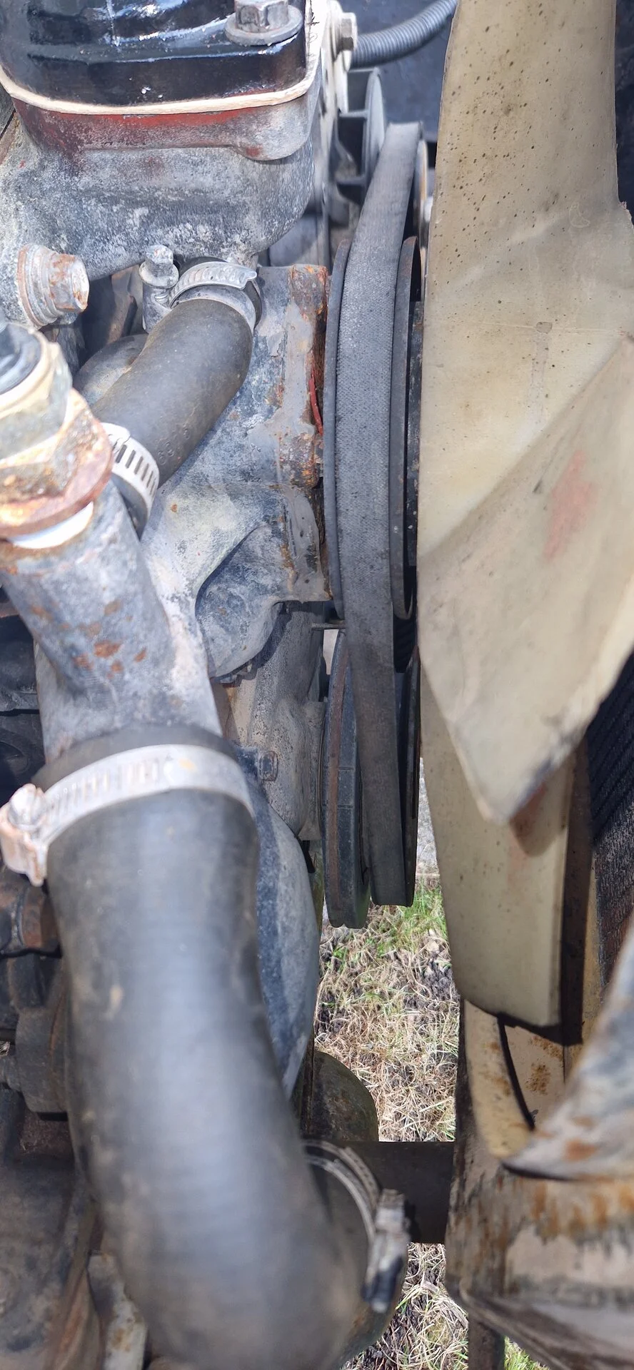

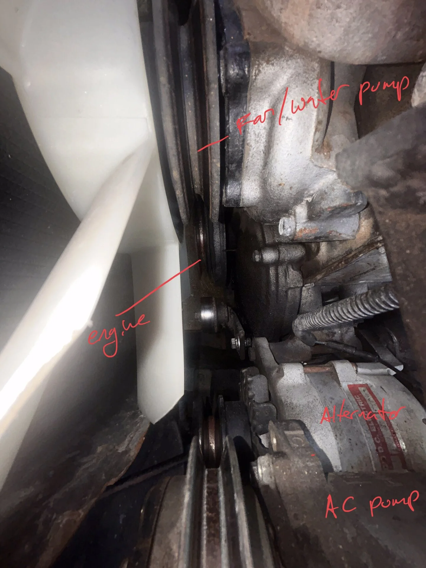

So I looked at the alignment of the pulleys. Seems like the alternator and AC pump are perfectly aligned, but a little off from the fan/water pump pulley. What do you think?

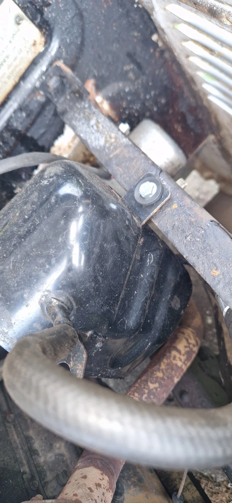

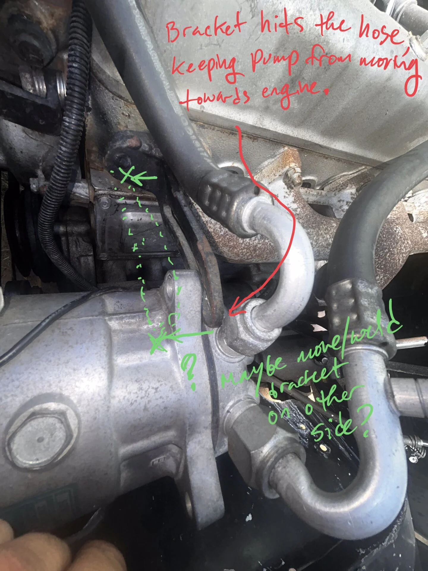

Also, the AC pump bracket bumps into a hose connector, keeping the pump from being pushed towards the engine. This prevents the use of a smaller belt and limits the travel, thus preventing proper tension adjustment. At least that's what I make of it.
I'm thinking that cutting that bracket and moving it to the other side would remedy this part of the issue, and allow me to more easily/properly adjust v-belt tension.
Does that make sense?

Sounds like you need to shim the alternator to bring it into line and then rework those adjusters. Weird that they've bent it to fit the wrong side.
Is a complex 3d problem, so probably easiest to do it yourself in 3d rather than suggest something here in 2d tbh.
You have three brackets to play with - maybe they work in some different arrangement?

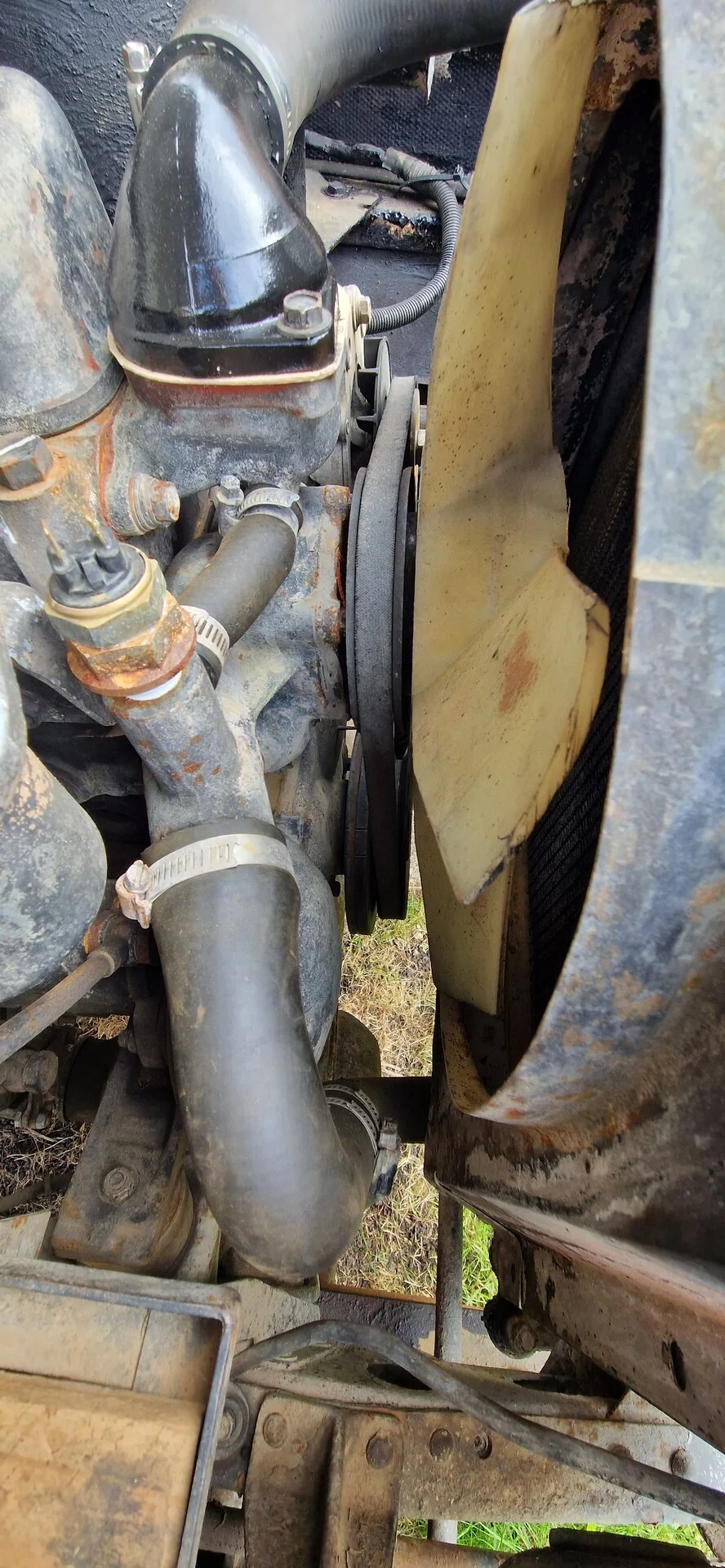

Looks like someone cut your fan blades?

I'm wondering if maybe making a static mount for the alternator, and having the AC compressor act as the adjustment part, would work. I don't think having both pivot, especially off of each other, is very effective.
Unless they both get fitted to each other-allowing no movement, and mounting them on a pivoting cradle?

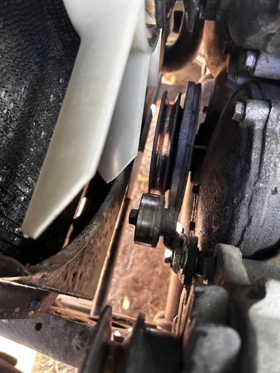

That pulley at the bottom; the one that looks like a tensioner, that's also a hack-job. Look at the weld. Looks like bubble gum. Seems like the idiot cut the fan blades to make that fit?
Worried about how much that affects the cooling capability of the fan.
Does anyone have a diagram of this? Of the pulley layout?
Now I am sort of stuck because even with making a braket, I'm stuck with a chopped fan and then doing this again if I get a replacement. Would rather start over with stock and figure that out, even if the AC has to go.
Maybe I should remove that bracket/pulley, run the belt straight from the engine pully to the alternator and AC pump, and either us that bracket pulley as a tensioner, or use an after market one.

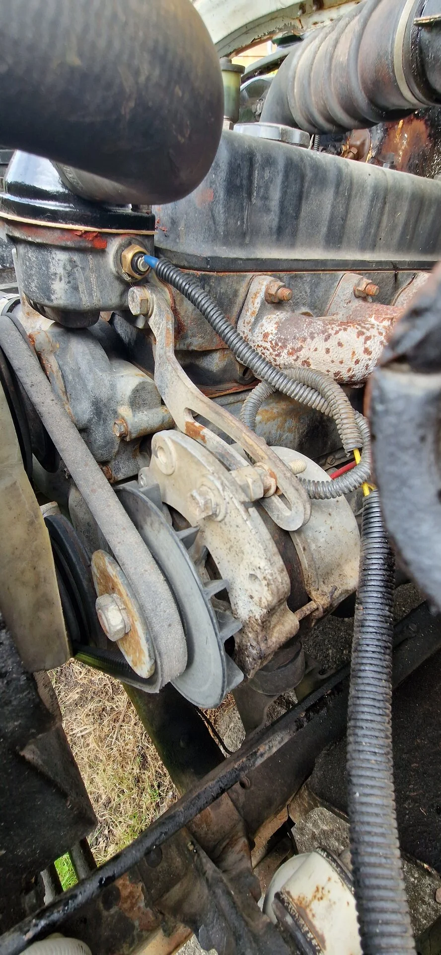

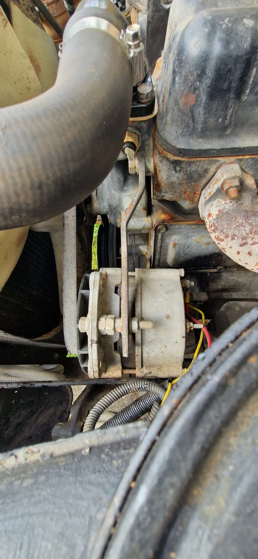

I'll try to take some pictures tomorrow of my HJ pulley arrangement when it's daylight again..

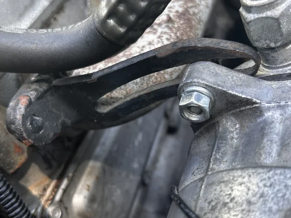

My alternator is clearly not original hence the adjuster is packed out with a couple of extra nuts, but otherwise it looks pretty original.
Oh wow!
Thank you! Thank you! Thank you!
That helps a great deal!!! It looks like the adjuster bracket I picked up off the road may be from the land cruiser after all; it has pretty much the same shape. If it is, then it sat somewhere in that engine bay for years only to fall off a few weeks ago!
Well looks like now I can at least have this thing running-even if its without AC.

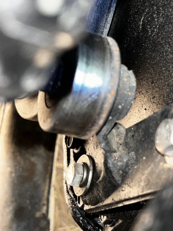

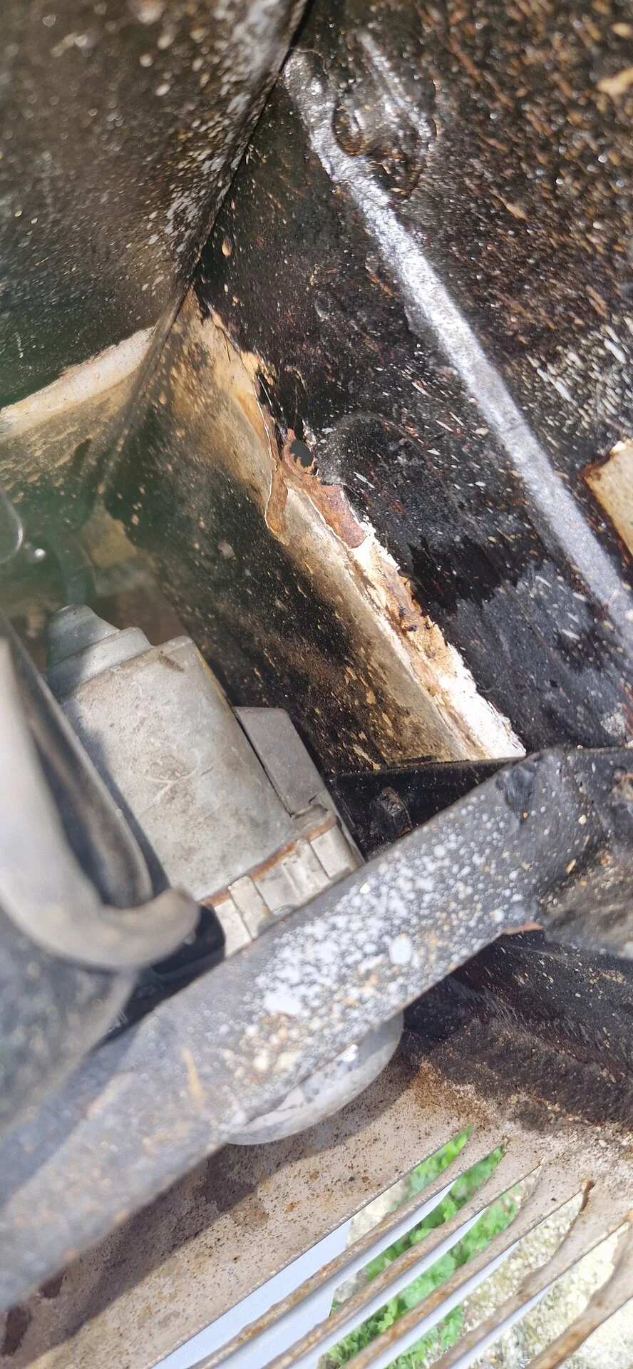

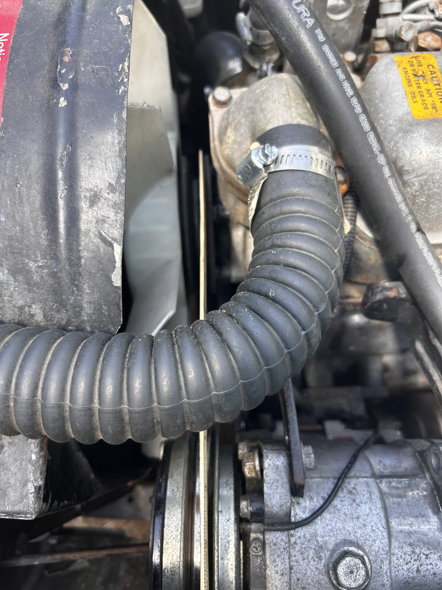

I'm my case it was missing, so I've fitted a modem electric pump, and a small reservoir on the bulkhead.
Crappy photo, sorry. Difficult angle. I think the pump is from a VW and the tank is from a Isuzu trooper. Anyway the brakes work now :)
