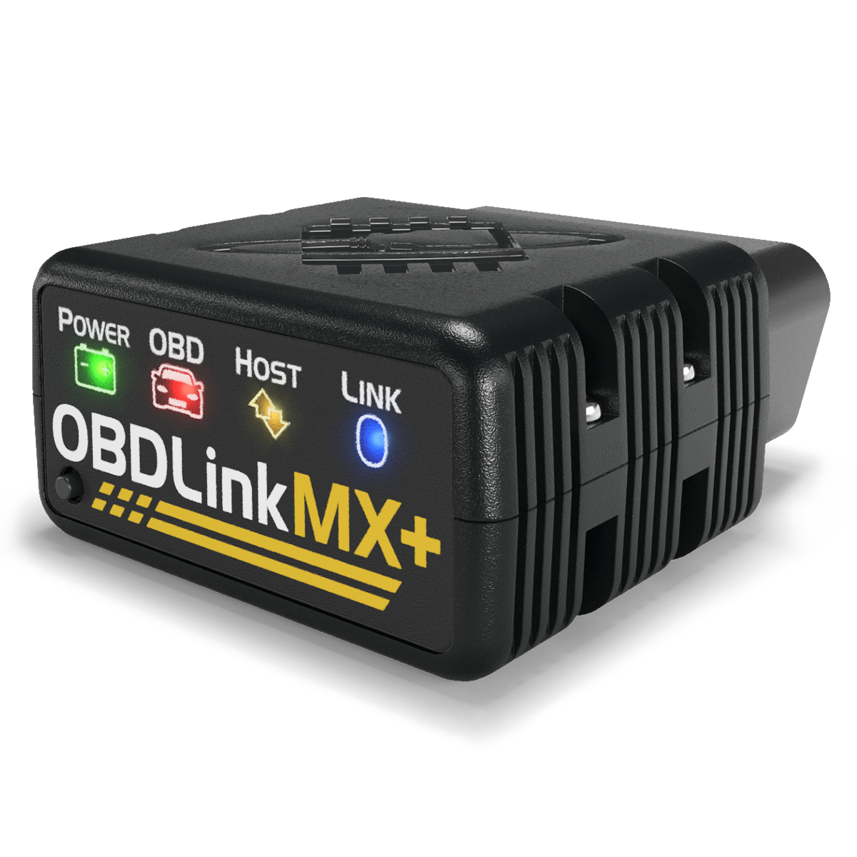

Not all OBD apps & adapters will access the TPMS ECU on 460. OBD Link definitely will. I know some like to turn off TPMS but with OBD link easy to check tire pressure all at once as well as the tire temperatures. TPMS sensors are cheap these days.

It more than likely can't read the Toyota/Lexus extended codes. The only ECU I can't query with OBD Fusion/Link is the one for KDSS. I do have a Techstream install setup for programming and other troubleshooting. That TPMS light should have given you a code.

You can use Scangauge (reportedly) but with OBD Fusion/Link (I use) you can tell which tire, You do have to identify which sensor is which as you add each tire to the app by dropping pressure in each tire.

Just change the name of each PSI gauge you have setup in OBD Fusion/Link. All of a minute or so. If you lose track just let air out of your tires to figure out which one is which :-)
