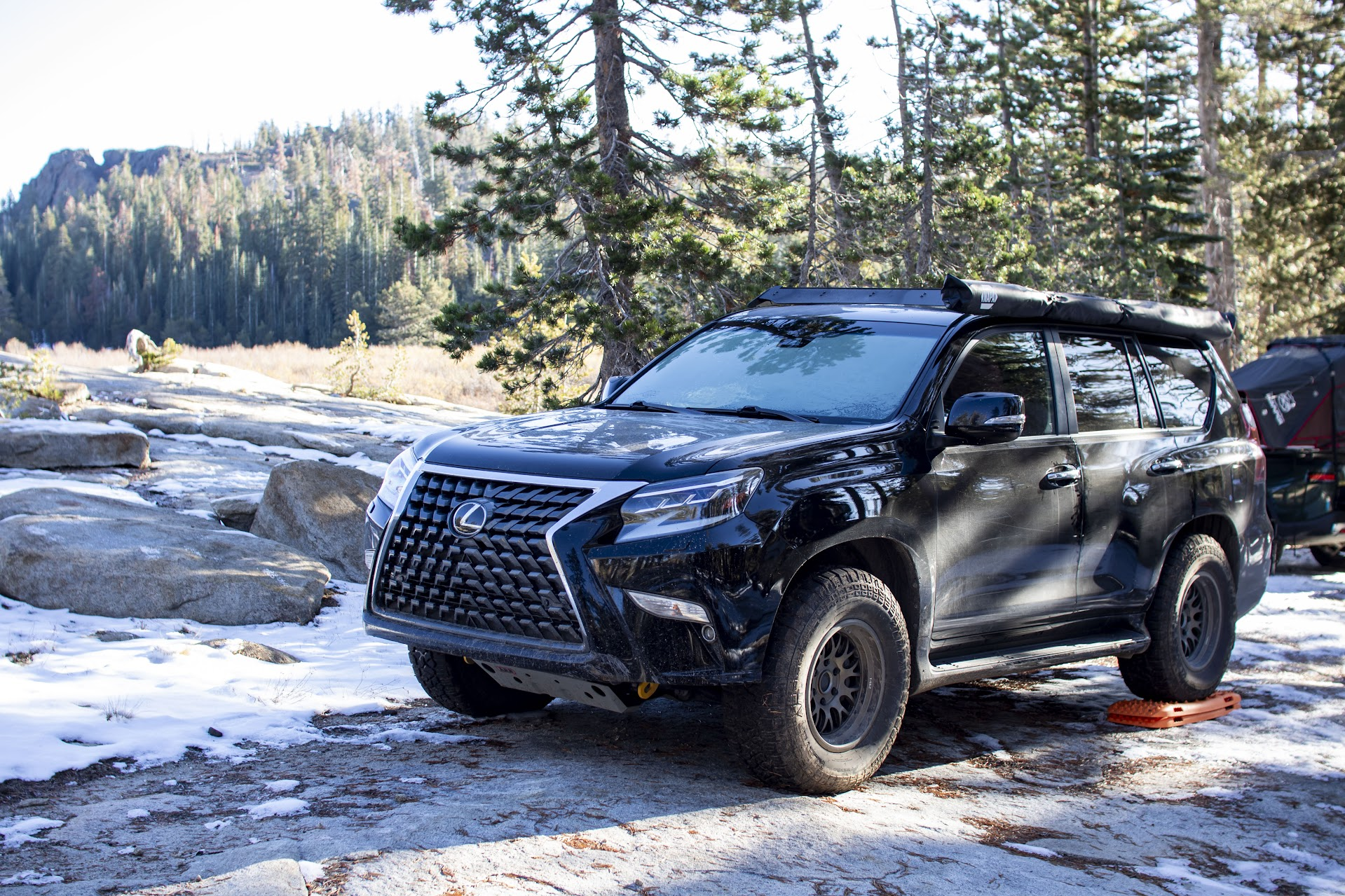

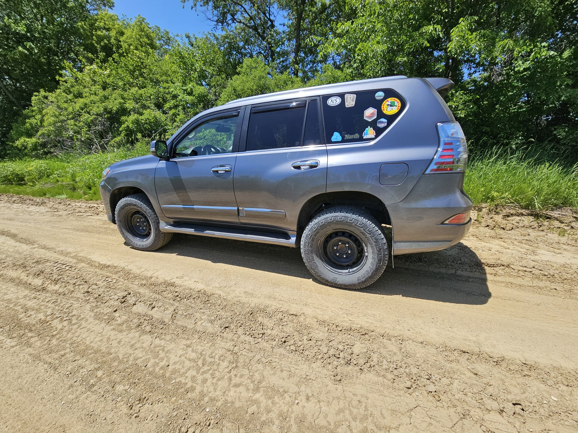

I mean if you want the look of the steel wheel, then you could always go a steel wheel. They're like $105 on eBay (17 Inch 6 Lug Steel Wheel For Toyota Fj Cruiser WE40596T | eBay - https://www.ebay.com/itm/364058247855?chn=ps&norover=1&mkscid=101&itemid=364058247855&targetid=2512152189032&device=c&mktype=pla&googleloc=9030872&poi=&campaignid=21214286338&mkgroupid=161030074701&rlsatarget=pla-2512152189032&abcId=9407521&merchantid=6490944&gad_source=1). I like stealing @Hiluxforever's pictures because he runs these. I believe those are 285/70/17s (roughly 33s) on stock suspension, and I've run the same setup with some trimming and a BMC. Do the trimming now to fit the tire you want and it'll save you that work for later when you change your suspension. The second picture is mine with 33s on stock suspension as well.
Mine were even cheaper than that. They also only weigh 30 lbs. So they are more weight but not a crazy amount.
I did not need a BMC for the 285 70r17 or 275 70R18s. Keeping everything tight to the scrub radius really helps.

How wide are those steelies? Can you get them at 7" or 7.5"
They are 7.5" thankfully. It just clears the UCA
