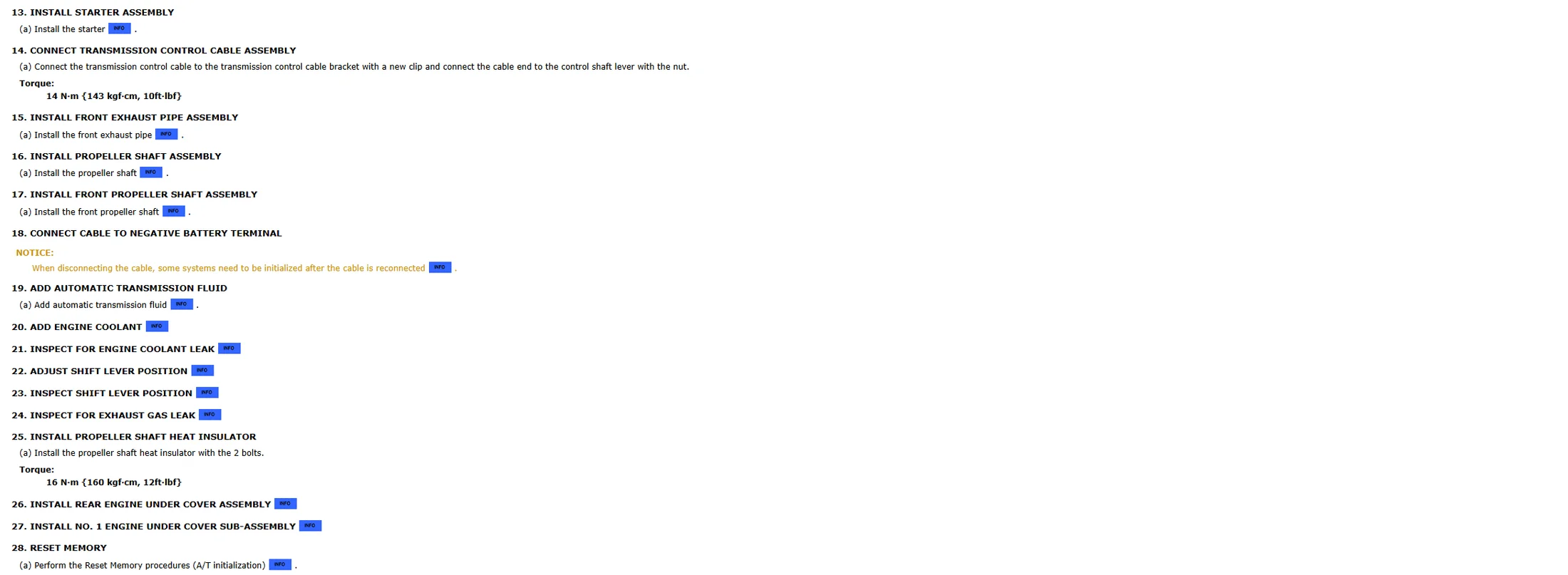

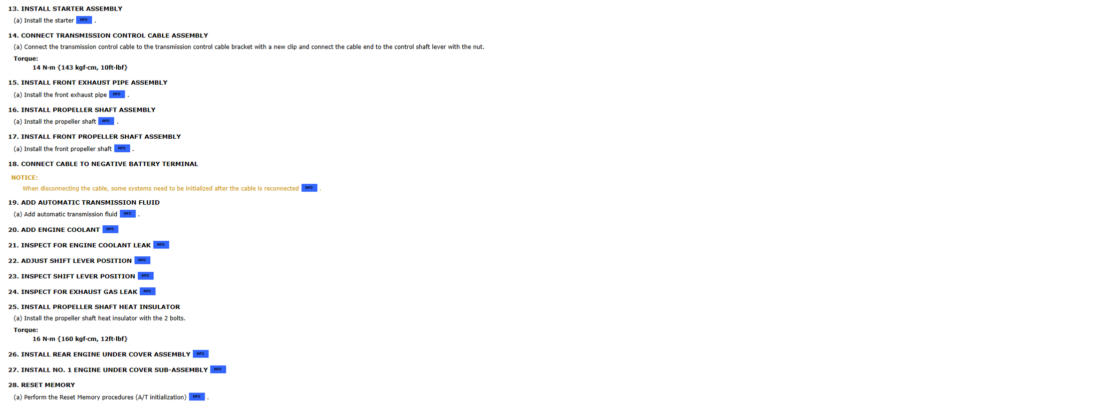

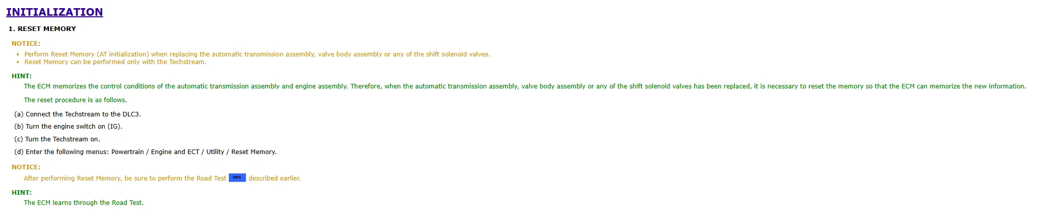

Fluid levels appear fine, filled to specifications in the all data. The only steps we did not complete are the initialiization that is stated is necessary after a transmission replacement.
All other steps were done as the instructions indicated except for the final step 28 which is where the TIS tells us it is "not available for your vehicle" when we attempt
I'm not positive, but I would assume Techstream is just resetting the keep alive memory.
Disconnecting the battery for a while may accomplish the same thing.

Did you ever resolve this? I am about to do the same on my 2011 Lexus GX460. I have techstream installed on a virtual machine on my laptop with VCI cable. I just tried connecting it an I am able to communicate with the vehicle but I havent tried resetting the AT memory yet.
