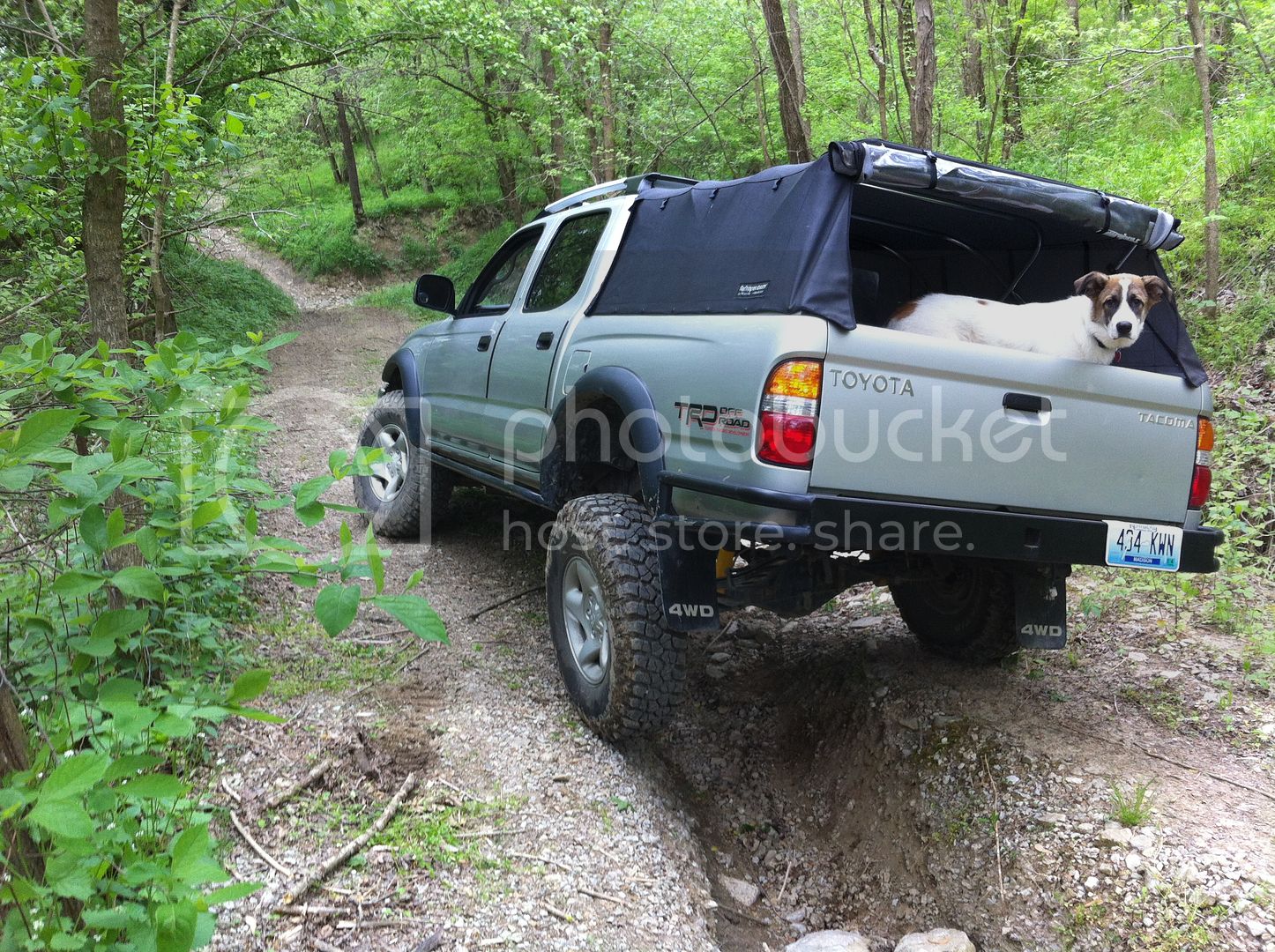

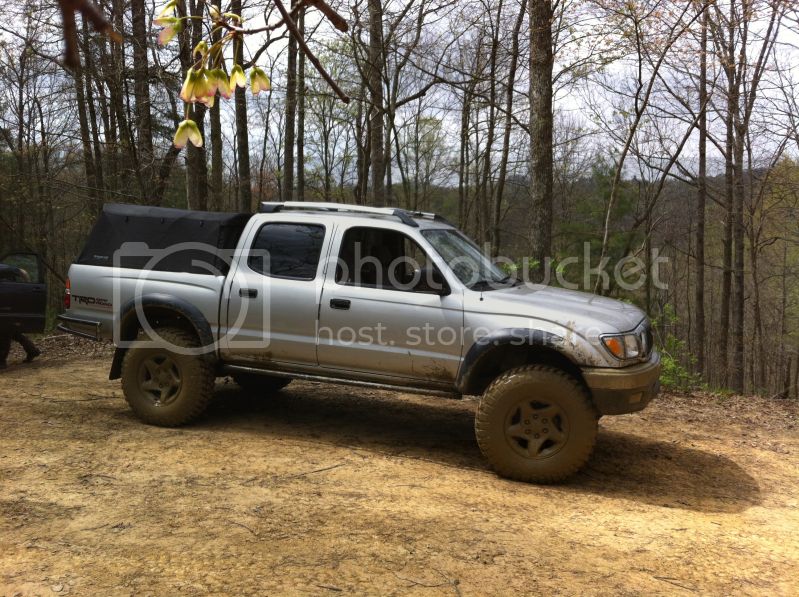

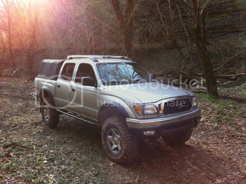

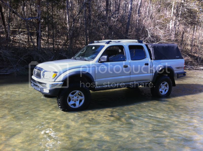

33/1050-15 on a 15x8 vs a 325/60-15 on a 15x12. Both are BFG MTs, the 33s are the newer version KM2. Roughly 3" of lift.
These handled good on the road, but they gripped every rut and wash bad enough to have to two-hand the steering wheel at times.
These seem are better so far, except the larger sidewalls are highly noticable to me when passing at highway speed.
Sorry for the amount of pics, but it's the same truck, with the same amount of lift, but at opposite ends of this tire discussion. I prefer the short fat ones on the road, and the tall skinny ones off the road. I could go where ever I wanted with the short fat tires, but I haven't pushed the 33s near as far and hard as I have those others.
As others have written, terrain determins the tire.
