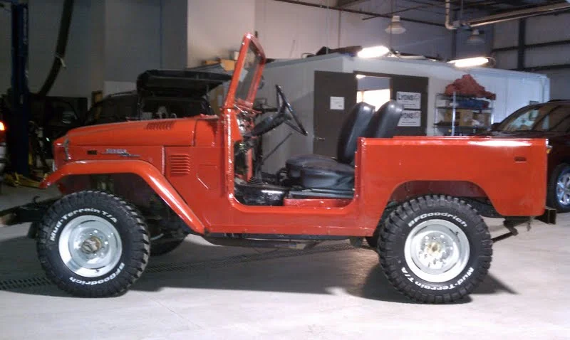

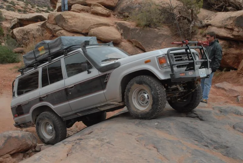

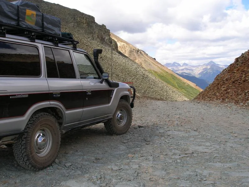

I run BFG A/T's on all my trucks and have had really great luck. The first 60 pic is with 33x10.50x15 on OEM 15x5.5 steelies. They tended to balloon up in the center of the tread area due to the narrowness of the rim (5.5). The second pic shows the the same tires on a wheels widened to 15x8. Much better contact patch.

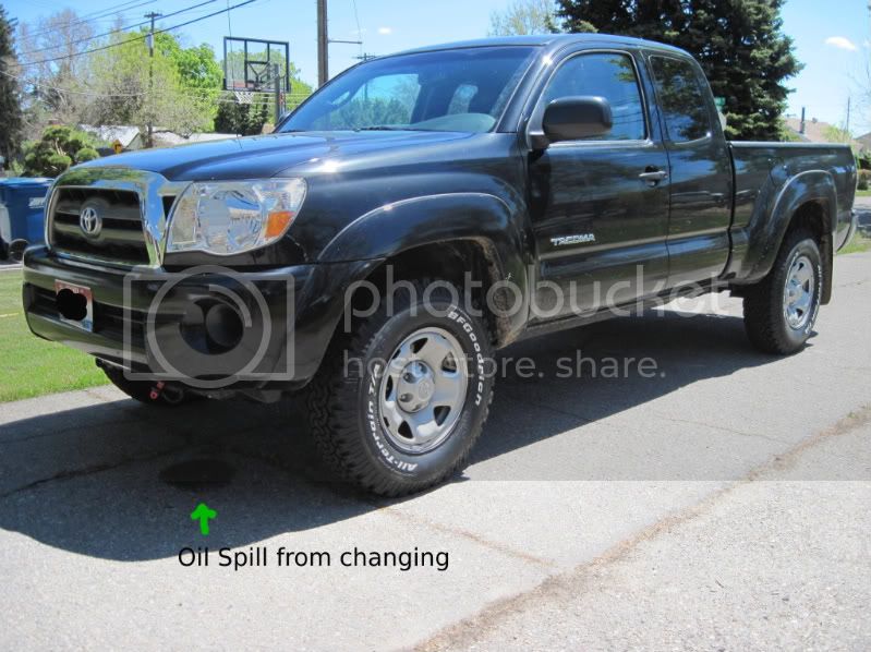

Here's my truck on BFG AT 235/85R16
This is probably as clean as the tires will ever be :bounce:
