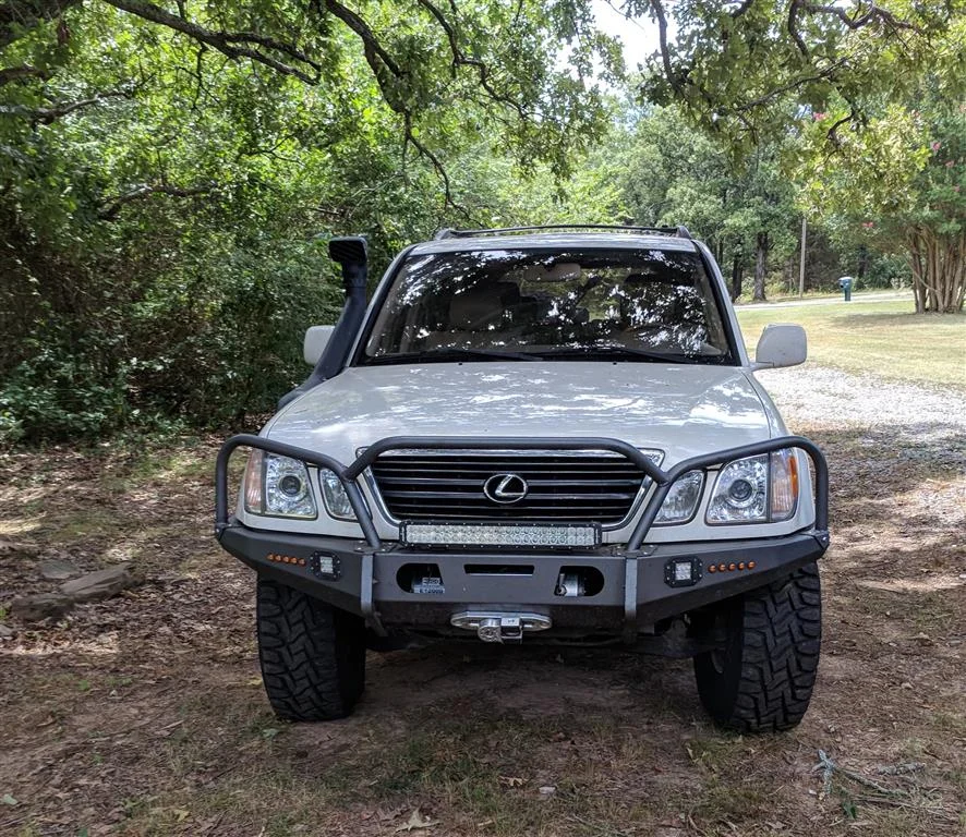

Post pics. GL

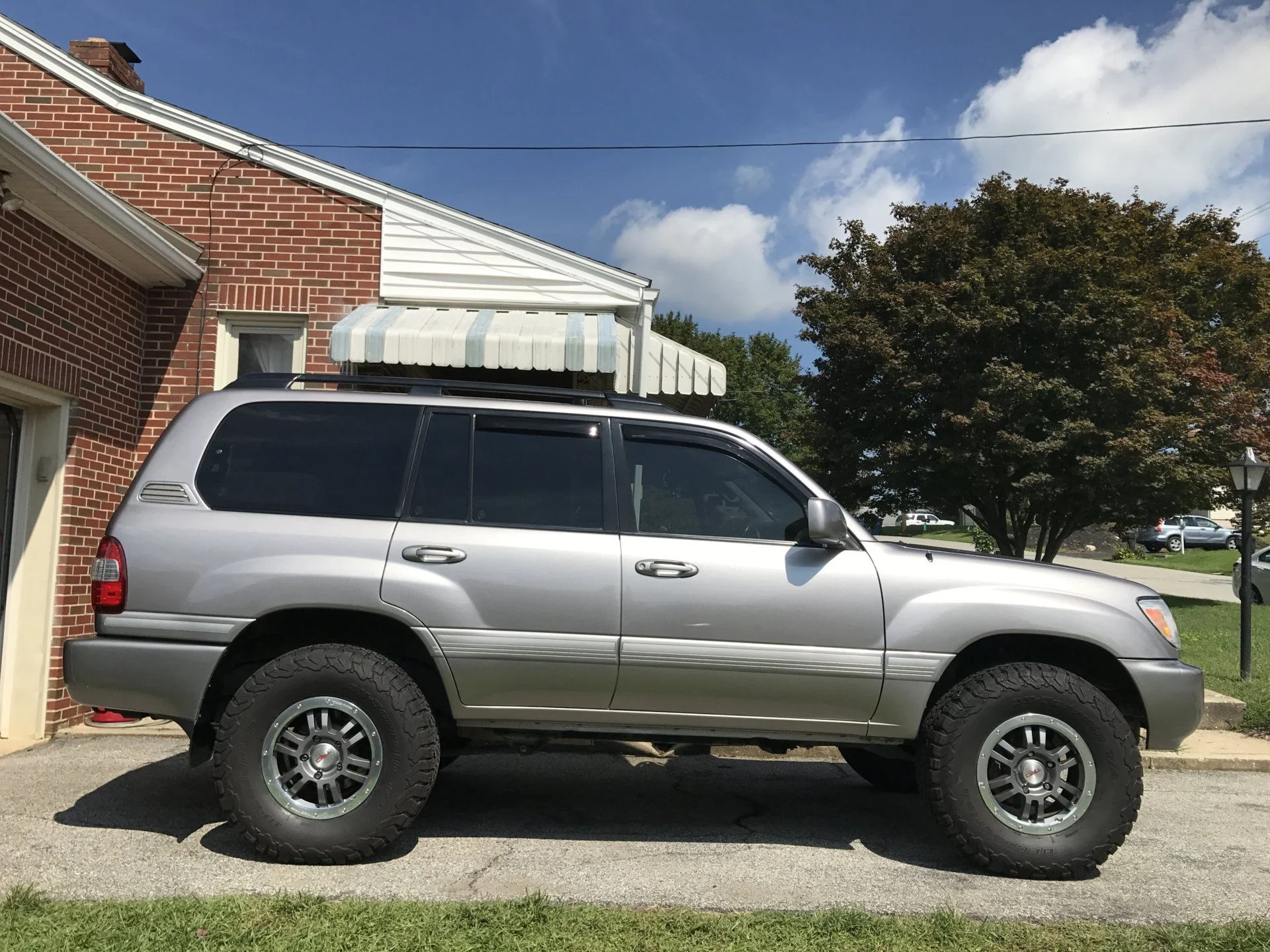

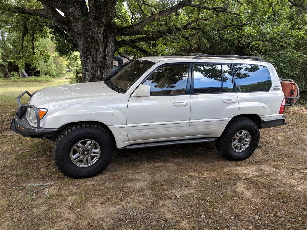

Any pics? Even im planning for 315' . Rite now 285/70/17 fitting on rig. But 315 look beefy ;)
315/70/17 look pretty good.
Good grief...looks like one of those snow trucks. Got a front view?

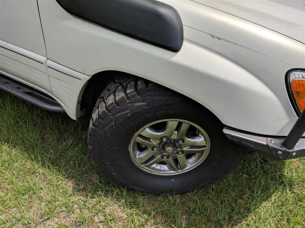

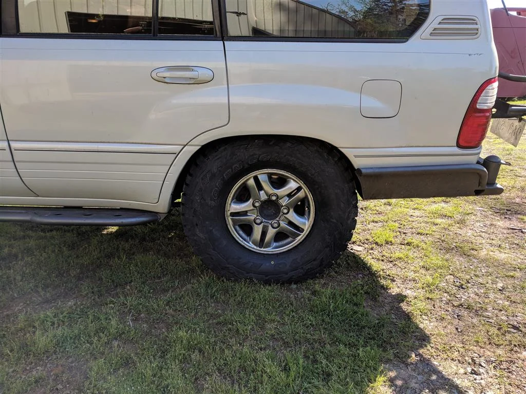

Here's another example for folks. 315/75/16 Toyo RT. They are a fairly narrow 315, so stock wheels and a 5mm spacer in the front clears UCA... Running AHC with stock sensors maxed. Only about a 1" lift in N, but of course I have another 1-1.5" lift at the push of a button. Not that it really matters that much...without a body lift if they are going to rub, then they are going to rub...it's just a matter of where in the arc of movement it happens. Running wheeler soft bumpstops in front which should mitigate rub in most circumstances. Remember you WILL 103% definitely have to trim the plastic at the bottom of the wheel well and flatten the pinch weld.
