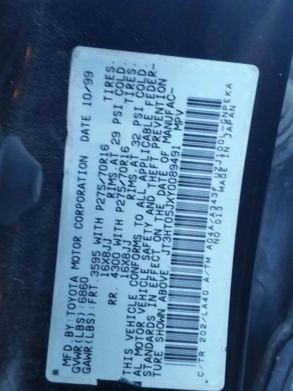

From Page 25 - LT275/70R18 Single 2070 @35psi
Where did I mess up?
Far be it from me to pontificate.... Depends on whether you go by door plaque axle weight and GVWR, or by trying to match the chart weight rating of the OEM P275/70/16 @ 29/32 psi. 32 psi on P275/70/16 is 2480 lbs (pg. 16).
Far be it from me to pontificate.... Depends on whether you go by door plaque axle weight and GVWR, or by training to match the chart weight rating of the OEM P275/70/16 @ 29/32 psi. 32 psi on P275/70/16 is 2480 lbs (pg. 16).
OH FOR GOD SAKE! Just when I thought I was okay with 35 psi now this comes up! I think I'll just buy a Segway. I need a hot pocketo_O
It's a p-rated tire on a light truck, so you have to divide 2480 by 1.1. So the actual capacity is 2254. That works out to just under 45 psi on an LT tire.
