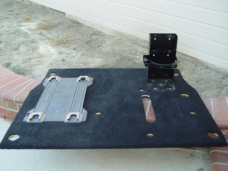

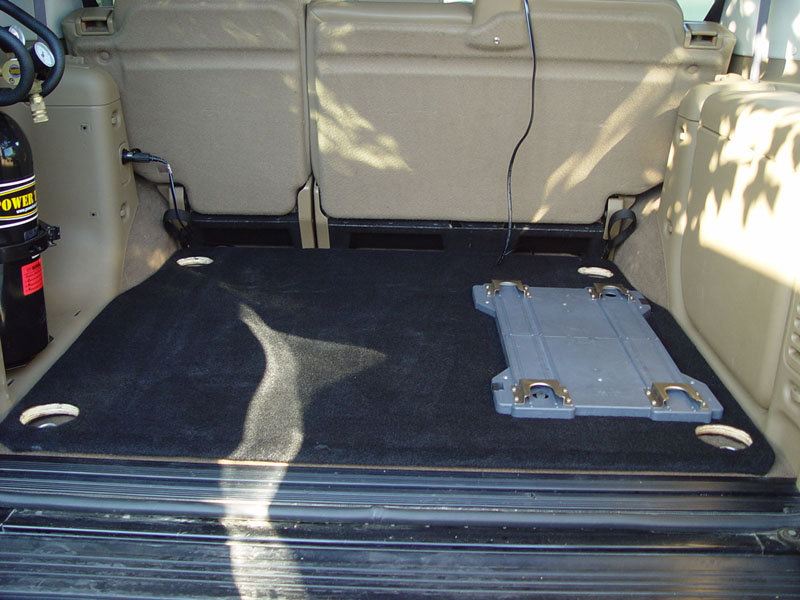

I'm also thinking about a storage system for the rear. I still use the rear seats when family is in town so I need something a bit unique. I'm thinking of building a plywood/carpet "base" with fridge slide, tie-down points. and maybe a single drawer. Basically a simple way to run the fridge and have some basic storage organization but done in a way that's easy to remove when I need the rear seats. Something similar to this, using the tie down points in the rear to hold it in place:
