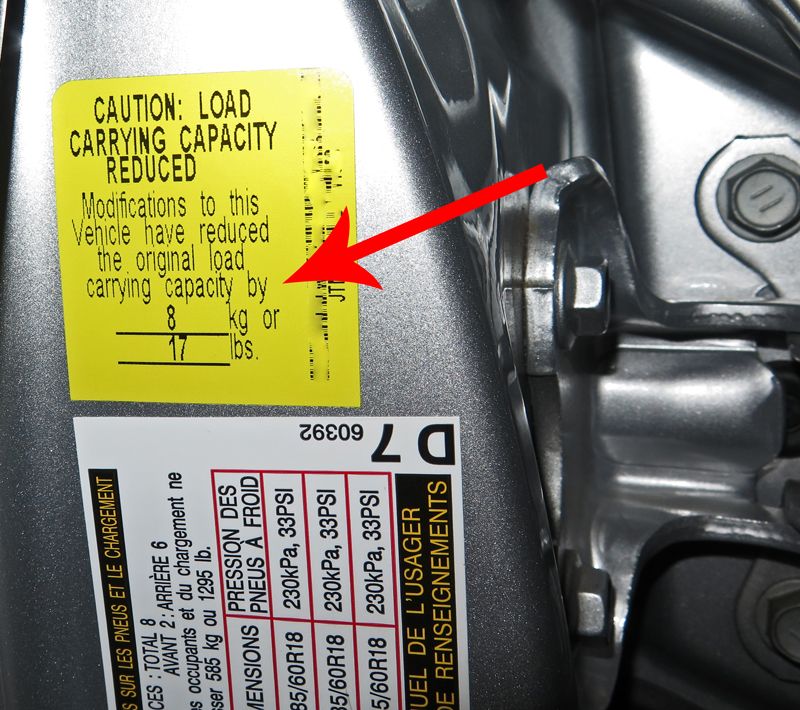

You really should weigh your truck at a commercial scale. What is not subject to marketing whimsy is the GVWR - 7,385 pounds. Yes, it's critical. If it were not, would Toyota go to the trouble of requiring a sticker like this ...
... reminding us that the Load Carrying Capacity of our vehicle has been reduced by 17 pounds because the port installed a rear entertainment system?
Add an extra battery? Reduce the Load Carrying Capacity by 60 pounds or so. Add a bumper? Add drawers? You get the idea. So, even if you keep the total vehicle weight under the GVWR of 7,385 pounds, you may have accessorized yourself out of being capable of carrying any passengers o_O
The Owner's Manual does a pretty good job of specifying the exact weights for load, but add any additional "stuff" and that capacity diminishes accordingly.

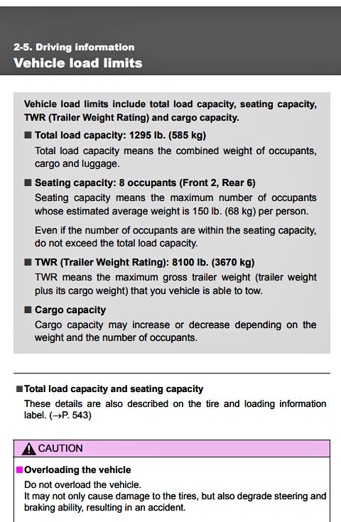

Here's what's in the Owner's Manual:
It's pretty straightforward - as far as load is concerned, in a stock truck, you have 1,295 pounds to play with. Everything you add counts against the load. Seating is provided for 8 persons, but how many you can safely carry is based on how much other load you have. Everything you have added to your truck gets subtracted from the 1,295 pounds.
How much you think you have increased the Load Carrying Capacity of your truck with suspension, tires, etc, is entirely on you.
