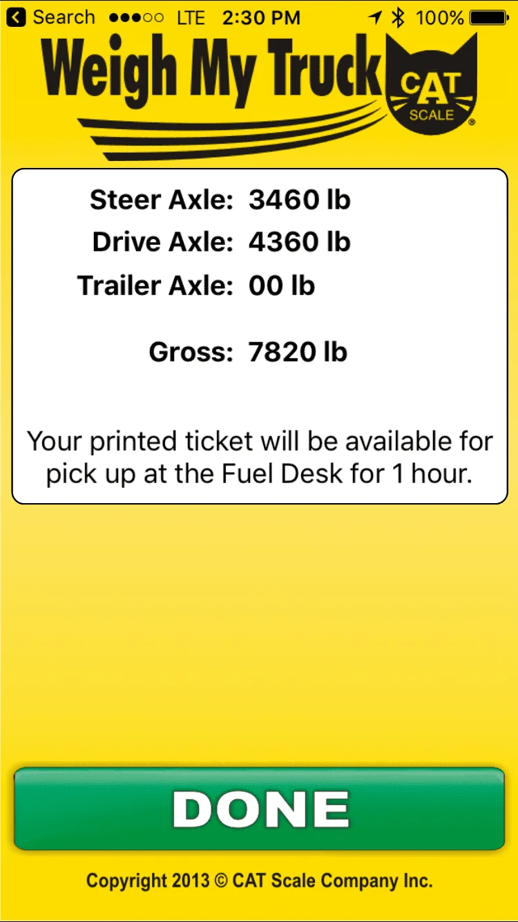

This is from a while back. I'll weigh again once the new bumper is on.

No front bumper. No rear bumper. No winch. No prototype off-road-use only aux tank.
I did have James Baroud RTT, two spare tires (second was on a 35 lb wilco carrier), 10 gal fuel, 15 gal water, camera equipment, fishing equipment, some target shooting stuff, hiking/backpacking gear, full camping loadout, lots of tools, recovery gear, luggage and personal items for my wife and I for a 3 wk trip, and probably some firewood as well.
