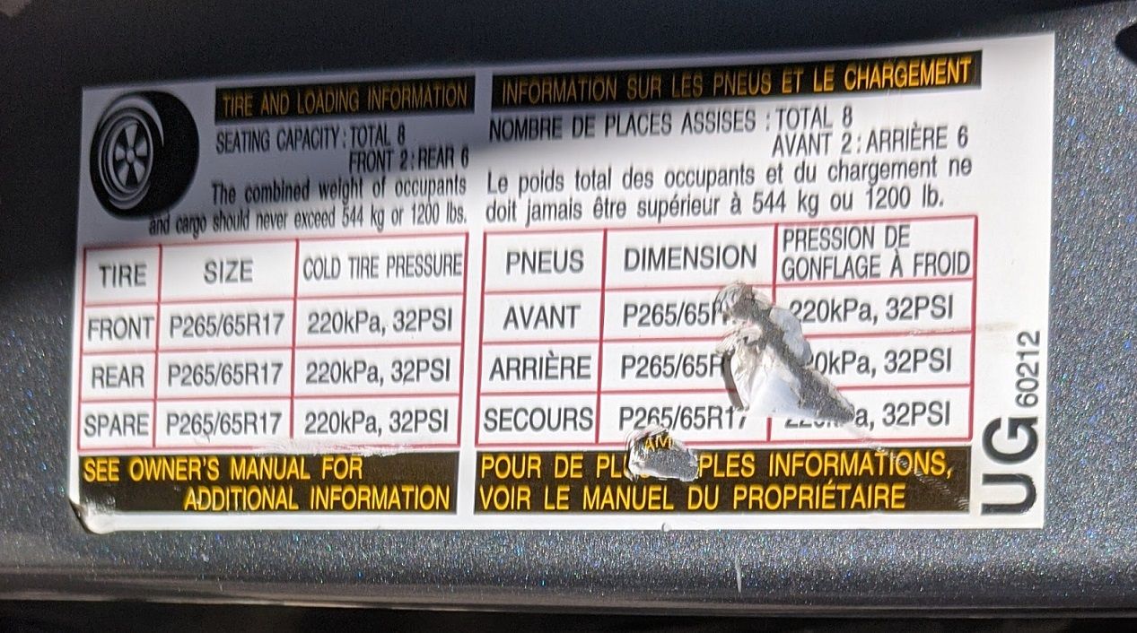

As an imposter on this 200 board, I humbly submit for your scrutiny my calculations for a 2006 GX470.
  • GVWR: 6200 lbs
  • OE: P265/65R17 @ 32 psi (door sticker in image)
  • Load Inflation Table = 2260
  • P-Metric to LT-Metric conversion = 2260/1.1 = 2055
  • New Target: LT285/70R17 @ 2055 = psi figure outside of (below) chart range, which starts at 35 psi
  • Note from one of your previous posts: "It is unsafe to run ANY LT-Metric tire on-road at less than 35psi. This can lead to excessive temperature build-up and premature/catastrophic failure."
Vehicle has been modified, however, and I have used a spreadsheet to calculate adds/deletes based on GVWR (e.g., two passengers at 150 lb each instead of eight passengers at 150 lb each, rear seats delete, add accessory weights, and so on). Understanding that this is likely not perfect, my calculations show 602 lbs over 6200 lbs sticker GVWR, so 6802 lbs. (Note: my 'going to Death Valley for eight days' weight is likely to be higher still, but I'm too embarassed to talk about it here.) The currently installed heavy-duty aftermarket suspension is the psychological blanket I am using in place of an official GV upgrade (common in AUS, less in US) to support the rationalization that the overage is acceptable.
  • According to a calculation found in one of your previous posts: 600 lbs / 5 = 120 (common rounding)
  • Add 120 lbs to 2205 lbs/psi = 2175
In the Load Inflation Table, the LT285/70R17 @ 2175 lbs/psi is just above the 35 psi mark.
What is the proper RCTIP? Simply estimating "37 psi" feels too arbitrary after all the math that got us to this point.
My gratitude for your patience and expertise, in advance.

You are pressing me on two points where I currently do not offer advice:
1. I only recommend RCTIP for LC200-series vehicles.
2. I no longer engage in any discussions, no matter how hypothetical, about tire pressures for vehicles that are running over the GVWR.
That said, I must admire your dedication to getting to a solution on your own. I can only guess you used my favorite online Load and Inflation Table Guidelines as a source: Toyo Guide for Load and Inflation Tables
Based on your work, and your correct understanding that no LT-Metric tire should be run lower than 35psi on road, I can agree with your conclusion that if your rig were stock, the RCTIP would be 35psi F/R.
As comments on your work, and in no way to be construed as any kind of recommendation or agreement that it is OK to run any vehicle above its GVWR, I can suggest you might want to look more closely at these two points:
1. Any calculated GVW above the GVWR should be evaluated for its impact on 4 wheels - it appears you are assuming 5 in your calcs. You should be dividing by 4, not 5.
2. GVWR "upgrades" are performed by government licensed shops in Australia. There are no such shops for GX470's in the U.S., so you will see no GVWR upgrades for your vehicle in the U.S. Any shops that do work on other types of vehicles such as heavy trucks, etc. and have a working relationship with the manufacturer of that truck, can apply for and be granted permission to change a vehicle's GVWR - even then, this is almost exclusively done when a vehicle is new and before it is delivered to its first owner.
HTH

@gaijin
Many thanks for validating the math portion of my inquiry. You have my understanding and respect in regard to where you draw the line with providing advice. My comment on GVWR upgrade is an admittedly wispy security blanket, since the upgrades on this elder GX are nowhere close to what (and when) a proper GVWR upgrade is.
Your engagement with the Mud community, however, is further grounds that this member of the unwashed masses has added to the list he's using to convince himself that an LC200 should have a future in his motor pool.
Thanks again.
EDIT 1: Yes, I used the Toyo Guide you pointed to. This document has become known as the sacred scrolls.
EDIT 2: I misinterpreted the divide-by-five from a previous post; I was getting tired. The post in question showed how to interpolate the intermediate Load Limits by subtracting a Load Limit at the pressure below the target value from the next pressure above the target value and dividing by 5. It makes no sense in my application above, I went out and performed a recount on number of tires on the ground, and I have resolved the issue. (there are four) That being said, and without asking for validation or advice on a potentially over-GVWR vehicle, I used the load limit psi step interpolation method to come up with 38.6 psi after applying the method. Thank you, once more.
