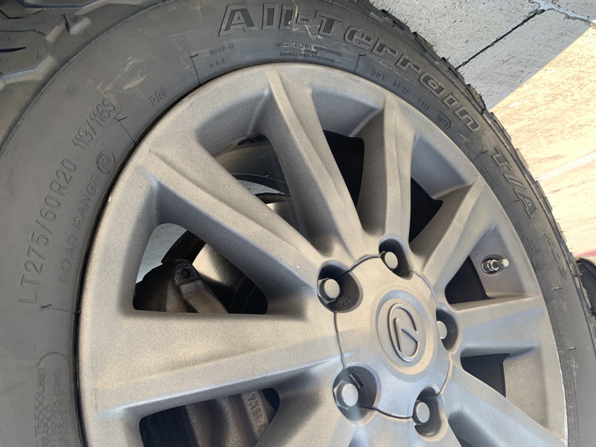

275/60/20 KO2 on 2010 LX570? I looked but didn't see that in the thread.
I searched and found a couple of pressure recommendations in that size but they all have a common theme: not enough information given. So what do you have? LT, P, or ISO metric?
Probably because KO2's are not made in that size ;)
I knew I shouldn’t have ordered these off Wish!
LT

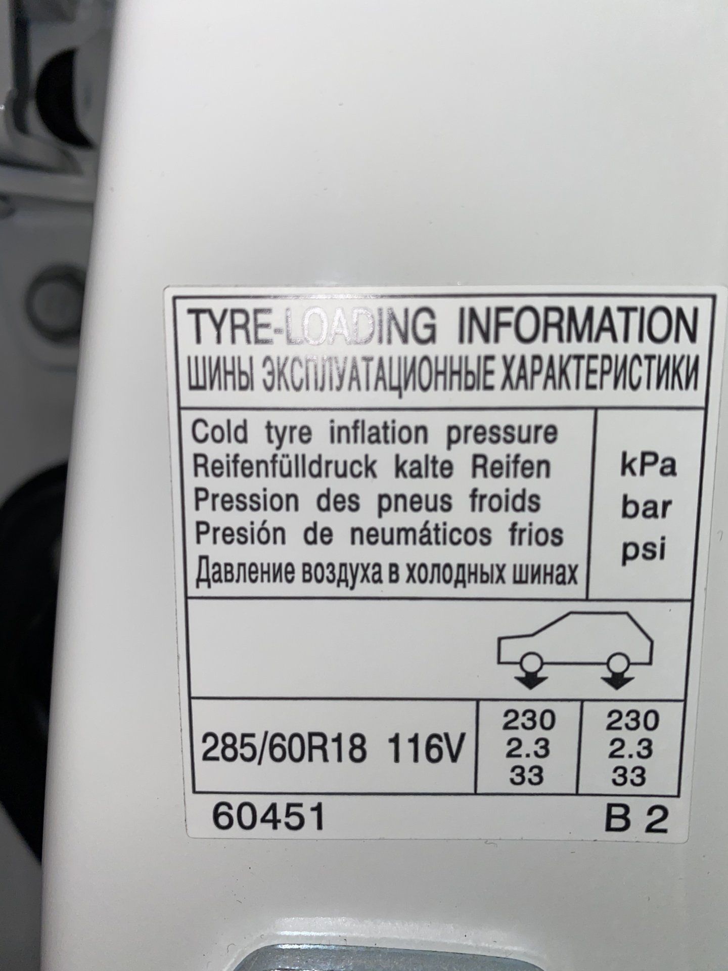

Hi,
Running a stock 2020 LC200 V8 Diesel with 275/70r17 KO2 LT 121/118r E
Not sure if any different from Petrol V8 in terms of weight/pressure? Is it the recommended pressure still 40psi?
Hi,
I'm not sure, either. Can you look at the placard on your driver's door jamb that shows the stock tires and recommended tire pressure(s) and tell me exactly what that says about tire size and pressure(s)? A picture would be best, but if you can't post a picture make sure you include ALL the tire description and pressure info for both front and rear exactly as it appears on the placard.
With that info, I can help you with the LT275/70R17 KO2 tires.
HTH
Got it, thanks!
The RCTIP (Recommended Cold Tire Inflation Pressure) for the LT275/70R17 E KO2 tires on your LC200 is 45psi F/R.
