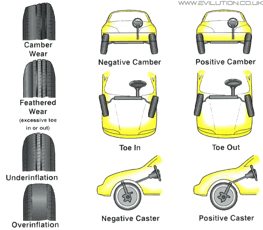

1. Here's the response I wanted to write:
Hey Chris, I'm curious as well. What pressure are you running? Hard to tell if it's the right pressure without knowing what it is. And oh, by the way, BFG doesn't make an ISO-Metric 285/70/17 tire.
2. But, bearing in mind the most probably diminished sense of humor extant on the forum in light of current events, here's the more considered response:
Chris,
The RCTIP for the LT285/70R17 KO2 tires on your 2016 LC200 is 40psi F/R.
Also, please note that wear on only the outer edge of your front tires is most probably NOT due to inflation pressure - more likely due to a positive camber issue due to some change in stock suspension geometry because of a lift, aftermarket parts, or just in need of an alignment. Underinflation would show increased wear on both inner and outer edges, while overinflation would show wear on the center tread area. It could also be due to excessive Toe-in, but in that case there would be a pronounced feathering of the worn edge - this is also an alignment issue.
For all the visual learners out there:
HTH
