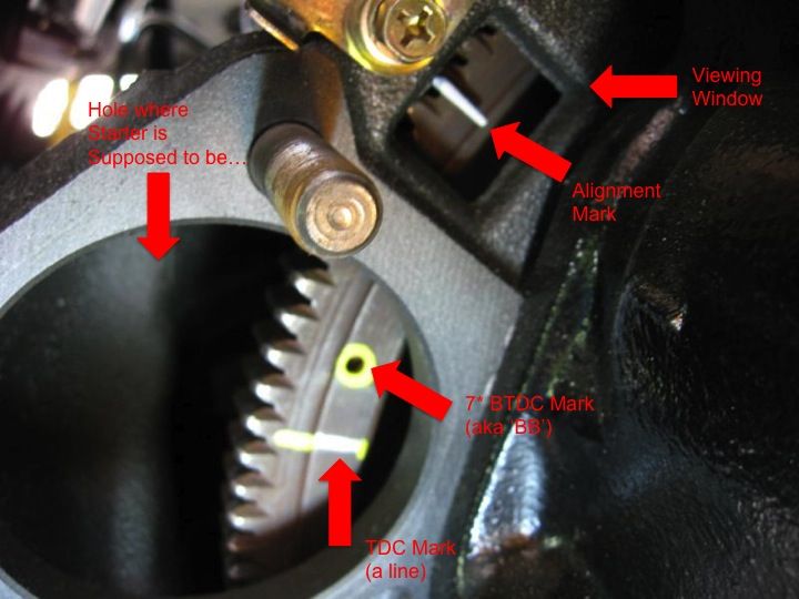

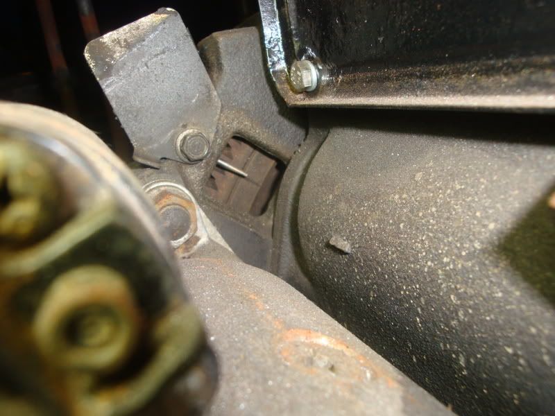

60, but should be the same for a 62, right? Passenger side, on the bell housing below cylinder 6 (right above the starter motor)...
Have you checked to see if you can find the window on the 62? Sometimes there is a plate covering it (held down with a bolt)...just loosen the bolt and the plate flips up...
Looks like this is an old thread but I have a question. I went to get a smog check today and the tech could not find this cover so he didn't do the smog check. I looked myself and with the help of these pictures was able to find it. My cover is missing, is it important to have that window covered and if so where can I get a replacement cover for it. Going back next week to get the smog check done now that I know where the window is.

That cover is discontinued, should be easy to find a used one here on MUD.
